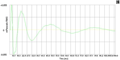

Figure 1: Composite impulse response in extension mode

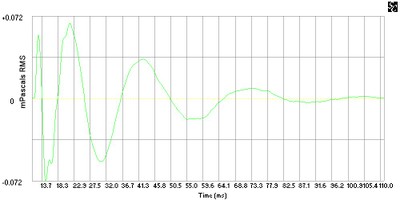

Figure 2: Composite impulse response in SPL mode.
Figures 1 and 2 show the subwoofer near field composite impulse response for the VTF-1 in extension and high SPL modes respectively. The plots were generated by summing near field impulse responses for the woofer with either one or two ports, respectively. Slight bumps in the otherwise smooth curves are a result of the phase differences between the driver and the port output. The measurements were taken at the same gain, at a moderate setting that produced 84dB in extension mode and 85 dB in SPL mode when measured at 1 meter.

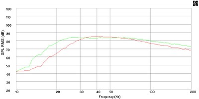

Figure 3: Frequency response at moderate volume for extension and SPL modes.
The frequency response curves in Figure 3 were generated from the composite impulse responses shown in figures 1 and 2. In the figure, the green trace is of the sub in extension mode with one port plugged and a peak of 84 dB while the red trace is of the sub measured in SPL mode with both ports open.
Both test cases were measured with identical gain settings and the appropriate switch setting for the subwoofer amplifier circuitry indicating that SPL mode will get about another dB at moderate gain settings, equivalent to 4/3 the effective wattage output. It is interesting to note that there is a clear tradeoff with a higher Q in the SPL configuration. The –3 dB point in extension mode gets to near a better than advertised 23 Hz while SPL mode gets to 32 Hz.

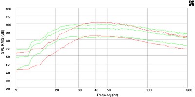

Figure 4: Maximum SPL in extension and SPL mode.
Figure 4 is an overlay of additional measurements taken at increasing gain. The green trace is again for the sub configured for maximum bass extension and the red trace for maximum SPL. System gain was increased to 95 and then 100 dB SPL when measured at 1 meter for extension mode where system gain was increased to its maximum setting. An SPL mode measurement was also taken at maximum gain and this peaked off at about 102 dB, effectively operating at 5/3 output of extension mode. From the plots, we can also note that both modes begin to show some signs of distress with both curves loosing smoothness, also indicative of output limits.
