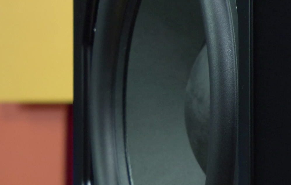

The new X-Ref also uses a new long-throw woofer with a die-cast frame and massive 3-inch vented motor assembly. Considering the X-Ref 12 costs just $699 shipped, it's rare to find a driver of this caliber in this level of product. In fact, most subs at this price give you stamped baskets, weaker drivers and compensate with larger cabinets.

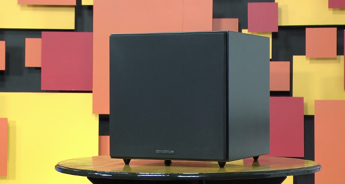

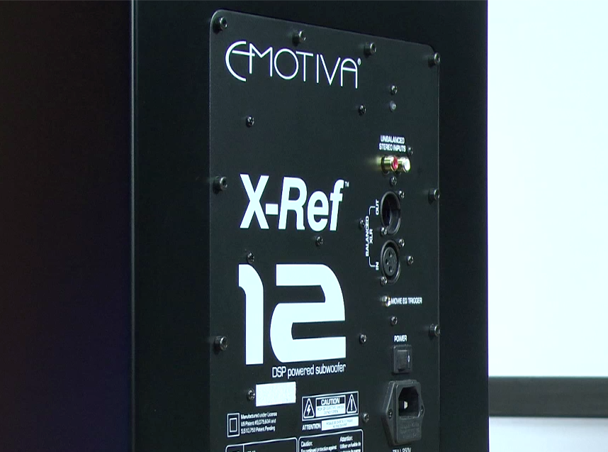

This cabinet is made of 1" thick MDF, with plenty of cross-bracing and extensive internal dampening. Emotiva calls the finish "Studio Black" - we call it "meh". It's your typical lacquer black sub, but it does match all of Emotiva's other speakers perfectly. The X-Ref 12 also comes with aluminum spikes, non-marring rubber feet, and both balanced (XLR) and unbalanced (RCA) inputs.

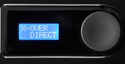

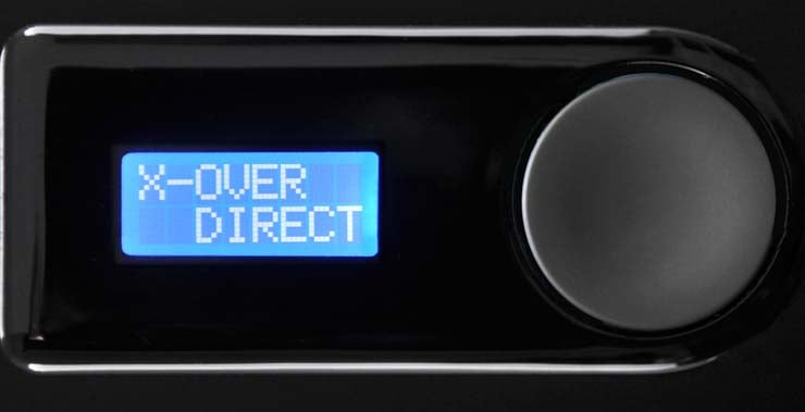

Now, while the Ultra series subs didn't have any DSP capabilities, the X-Ref incorporates a DSP preamplifier and loudspeaker management control system. This provides the end user tools to combat acoustical challenges that speaker placement and room interactions place on subwoofers. Control, setup, and configuration are accomplished using a finicky, but functional, push-to-engage rotary knob, and a backlit LCD display lets you know what you're messing with.
Emotiva DSP
Upon closer look of the VFD interface, it looks quite similar to the system Aperion Audio employed in their Bravus line of subwoofers. It's not uncommon for companies to share common technology interfaces such as displays, connectors, etc, though Emotiva writes its own DSP code specific for their own subs. Regardless, we still encourage users to bypass the internal crossover of their subs in favor of using the more robust bass management scheme their modern Dolby TrueHD / DTS HD A/V receivers offer. Still, the added EQ the Emotiva X-Ref subs offer can be a useful tool in tweaking system performance.
Now for features - the X-Ref 12 wakes up automatically by sensing an input signal and Movie or Music equalization modes can be preset so the sub can be configured differently for each application. Also included are two independent, fully configurable parametric EQs (with frequency, Q, and boost/cut controls) so you can perfectly tune the X-Ref 12 to your room and the rest of your system. Emotiva's DSP digitally controls settings like the crossover point and equalizer parameters to ensure accuracy and repeatability.
