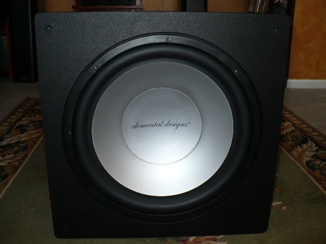

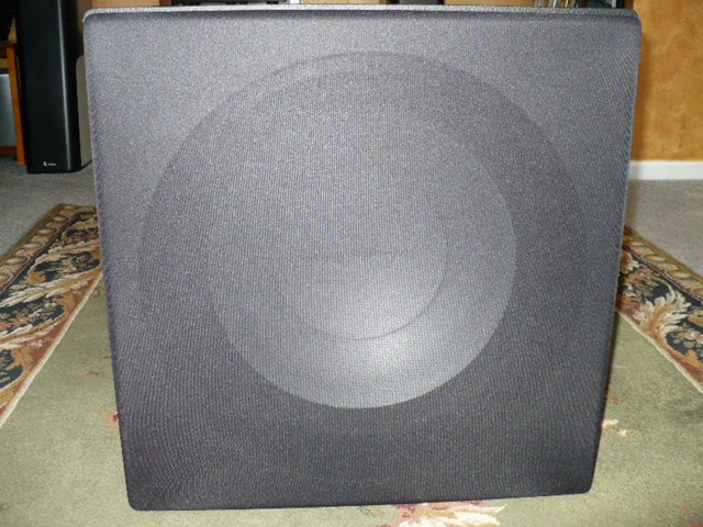

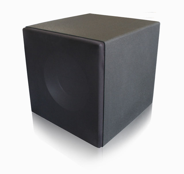

With an 18” driver and at 150 pounds it should be clear that the A7S-450
is a brute force solution to producing low end frequencies. There are bigger and heavier subs, but not
many.
The review subwoofer came with a black finish and seems to be the only
color option available. Elemental
Designs, eD, their nomenclature for short, states in the literature that the
cabinet finish is applied by a proprietary method, which produces a seamless,
rugged skin on the cabinet. This finish
is the definition of utilitarian: black, plasticy, and bumpy. To be completely honest, the finish looks
like it would be most at home in a guys dorm room or a frat house, a point
driven home by eD comments about the finish resisting beverage cans without
coasters and children. While the A7S-450
will not win any awards for architectural interiors/décor, if the potential for
damage to the finish is an issue in selecting a subwoofer, I am inclined to
believe eD when they claim that the finish will hold up well under abuse.

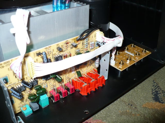

The A7S-450 offers a choice of rear plate amplifiers that are custom
manufactured for eD by a company called Keiga Electronics. The standard LT/550 produces 550 watts RMS
into a four ohm impedance load while an $85 upgrade to the LT/1300 provides
1300 watts RMS into a four ohm impedance load.
For the review, I was provided the more powerful LT/1300 amplifier
configuration. Considering the small
overall cost increase involved, spending the extra for the upgraded amplifier
is definitely recommended.

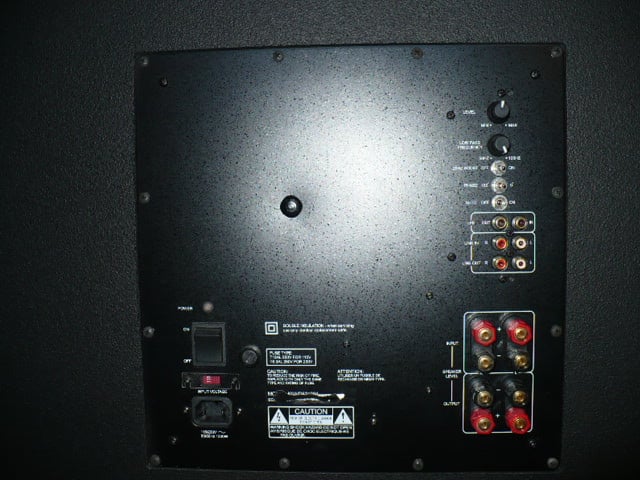

Both the LT/550 and the LT/1300 amplifiers offer the requisite
continuous variable output level adjustment and low pass crossover, but for
some reason, the base LT/550 seems to provide a continuously variable phase
adjustment between 0 and 180 degrees, according to eD
literature, while the
upgrade LT/1300 has a basic 0/180 degree toggle switch. The internal crossover
system for signal input is adjustable from 50 to 100 Hz, but I was unable to
find the crossover slope listed in eD literature for the A7S-450. The LT/1300 amplifier upgrade includes a
toggle to kick in a 25 Hz boost of unspecified magnitude. Both amplifiers feature an automatic on/off
function switch for power. The
amplifiers have speaker level, binding post input/outputs and stereo line level
input/outputs with a separate mono LFE input/output in lieu of a crossover
bypass switch. Power to the A7S-450
amplifier is provided through a detachable power chord and controlled by a
rocker switch with a user selectable 115/230 voltage switch located between the
two.

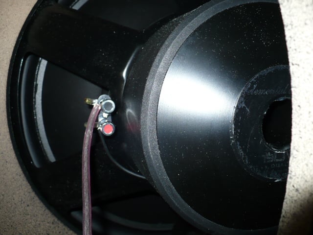

According to eD, the A7S-450 subwoofers use a driver design based on the
190v.2 car audio subwoofer driver. How
close the A7S-450 driver is to the 190v.2 is not entirely clear, if it is the
same driver put into a home application or if it is in fact actually modified
for home use in some way, but the eD website has quite a bit of useful
technical details on the car version of the driver. Thiele Small Parameters are provided for the
190v.2 along with a cross section of the driver including dimensions, various
recommended enclosure sizes for sealed and vented configurations at different
tunings, and even blue prints for those enclosures. With this information, playing with the
190v.2 can be as much fun for the do it your self home audio types as for the
car audio types.
The total weight of the 190v.2 driver is listed as 42 lbs, nearly one third of the total system weight. The driver design is claimed to allow a linear cone displacement of +/-0.85 inches, generating a volumetric displacement of 0.10 cubic feet of air.
The 190v.2 driver includes a number of beneficial design features and
methods that eD discusses in the literature.
According to eD, while the 190v.2 driver is said to be optimized for use
in small enclosures, it is said to also perform well in infinite baffle
configurations. Individual driver
component designs are evaluated using Finite Element Analysis methods by eD to
maximize driver linearity. The
suspension is designed to maximize linear displacement, featuring a specialized
surround design said to increase effective piston area and a spider design with
the center of mass pushed forward that eD claims increases efficiency and
linearity. The cone is constructed from
a seamless 2 piece poly design and the connection of the cone to the spider and
voice coil based on a proprietary assembly method, Zero Triple Joint Construction
that is said to eliminate problems associated with true triple joint
construction in high excursion drivers.
Ventilation is integrated into the cone system to force air into the
voice coil, reducing distortion and improving power handling. According to eD, the motor structure is said
to benefit from a proprietary Co-Linear design which eD claims effectively increases the magnetic field (B) in the gap by using a tighter gap tolerance. This allows them to use a smaller
diameter motor while retaining a high B. (IE. Get better small box performance
with the same mass).

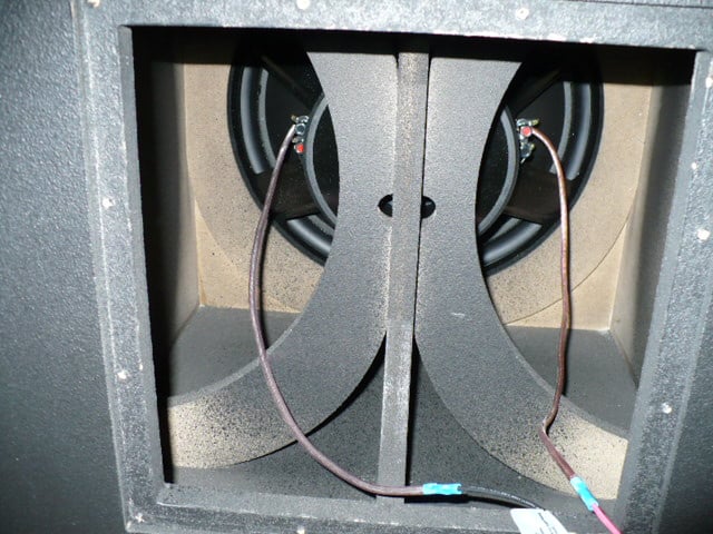

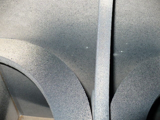

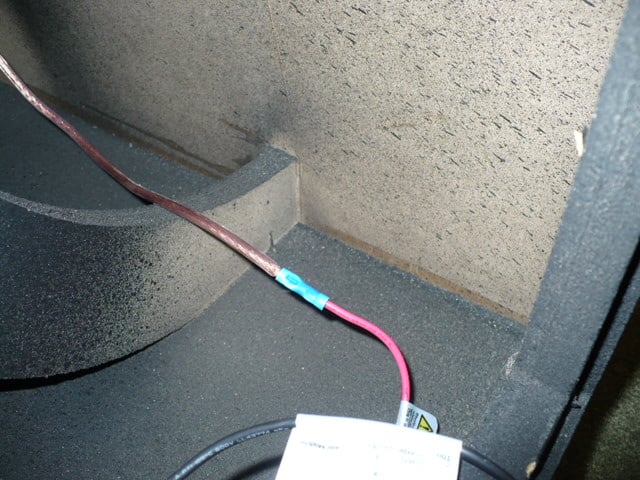

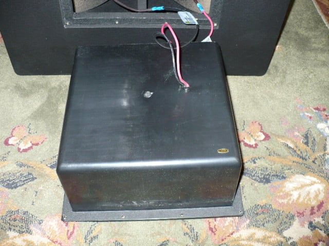

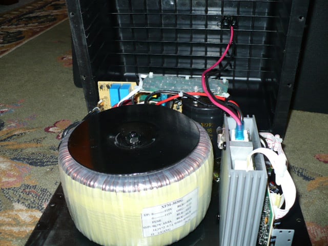

To have a look inside the A7S-450, I removed the plate amplifier, which
is mounted to the cabinet by 12 wood screws.

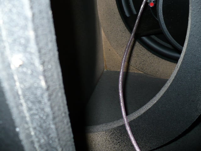

Once inside, I found the cabinet constructed of heavier 1” MDF panels
rather than the more common and flimsy ¾”.
Internal bracing for the relatively large cabinet is in the form of an
hourglass shaped, bi-directional column mounted to the top and bottom
panels. The two pairs of outward facing
c sections used for bracing are only attached to the cabinet at the center of
the edge at the top and bottom panels and side panels. This provides minimal reduction to the actual
panel spans required for stiffening. So,
while it is impressive looking, it is not the most effective configuration,
structurally.
Editorial Note about Cabinet Material
Elemental Designs informed us that they have recently moved away from using MDF for their cabinets and now use a material called EFS. EFS is a higher density wood and a little more eco-friendly. Score one for the environment to eD!
For more information about this, visit: http://www.edesignaudio.com/elementaldesigns_efs.php

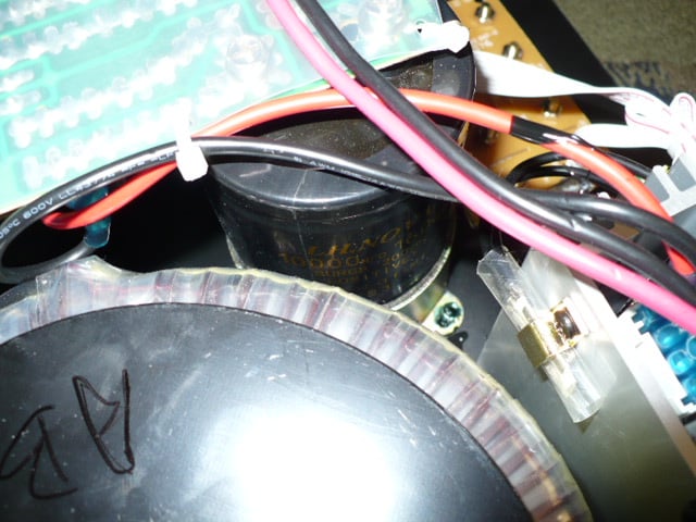

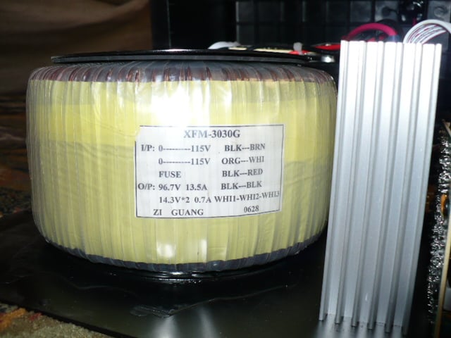

The amplifier is housed in plastic case, which is mounted to the inside of the back plate by four machine screws. Once detached, I found a massive 6½” diameter by 3½” tall toroidal power transformer. Calculated from output amperages and voltages listed on the side of the transformer, I get about a 1.325kVA rating for the transformer. Transformer power output is supplemented by a capacitor rated for 10000 mF at 160 VDC. The rated power consumption listed on the back plate for the amplifier is 1200W at 115V with a T12AL 250V fuse at 115V power input for overload protection.
As for the driver (190v.2), it sports a sizable motor structure, with a magnet measuring at approximately 7.5" in diameter with a 10MM pole bump and utilizing two 25MM Y30 ferrite rings. The car origins of the driver are evident in the use of spring loaded wire terminals that are common in aftermarket car speakers. There are two pairs of wire terminals located at opposite sides of the driver, apparently to allow bi-amplification for car usage. The driver is wired from the positive terminal on one side to the negative terminal at the opposite side using 14 AWG wiring out from the amplifier and the demarcation between the outsourced amplifier and the eD driver components are as clear as the wire splice between them.

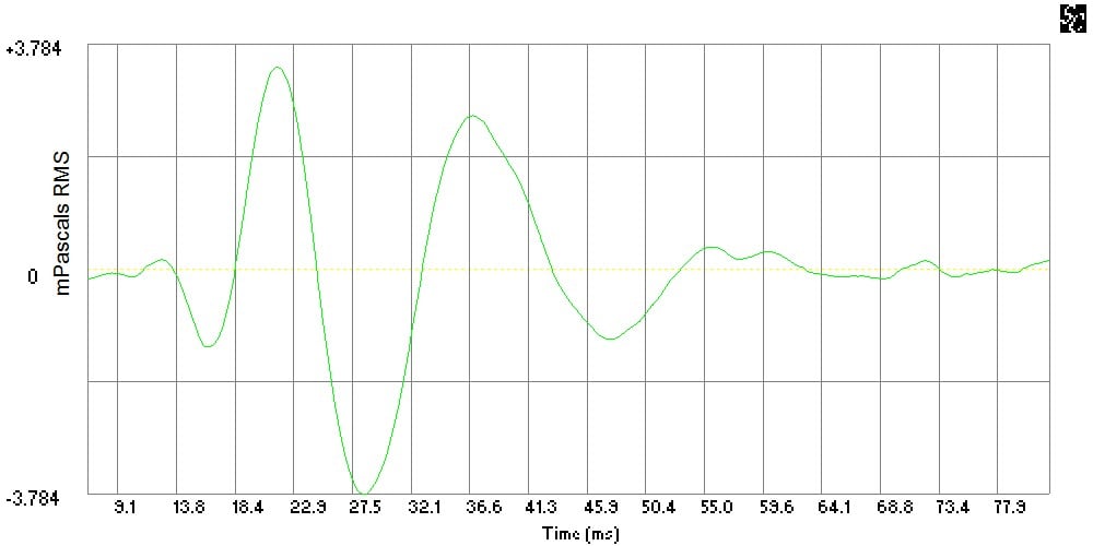

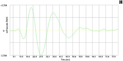

Figure 1: Nearfield Impulse Response
Figure 1 shows the impulse response of the A7S-450 subwoofer measured nearfield at an SPL of 80 dB at 1 meter. This fairly typical response curve for a bass driver shows the A7S-450 damping out the impulse input quickly within two cycles of free vibration.

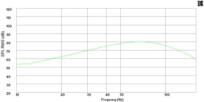

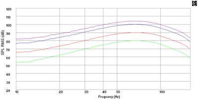

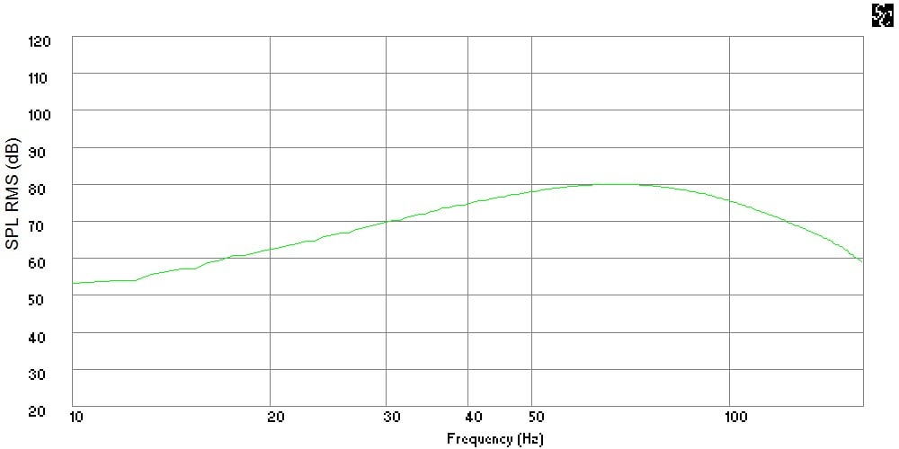

Figure 2: Nearfield Frequency Response
Figure 2 shows the nearfield frequency response of the A7S-450 at an SPL of 80 dB at 1 meter. The frequency response curve shows peak output at approximately 60 Hz with tapering of output below 50 Hz at approximately 12 dB/octave. No inflection point indicating significant roll off to the bass response occurs in the subwoofer’s response, which has a smooth roll off to 10 Hz. The specified 22 Hz appears to be dependent on the presence of either room boundary effects or utilization of the 25 Hz bass boost and perhaps a combination of both.

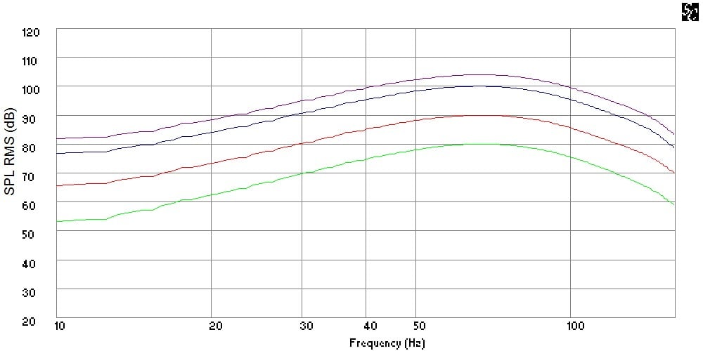

Figure 3: Nearfield Frequency Response at Various SPL
The curves in Figure 3 are overlays of the nearfield frequency response of the A7S-450 measured at various SPL. The green curve was measured at a peak SPL of 80 dB at 1 meter with the red curve at 90 dB, the blue curve at 100 dB SPL, and the purple curve at 104 dB, all measured at 1 meter from the subwoofer.
From the identical shape to the plotted curves at various SPL, it is clear that the sub had more to give before suffering the ill effects of compression even if my computer soundcard did not. Based on my experience with the sub, I would anticipate at least 3-5 dB more output is possible from the A7S-450 without any significant sonic troubles.
