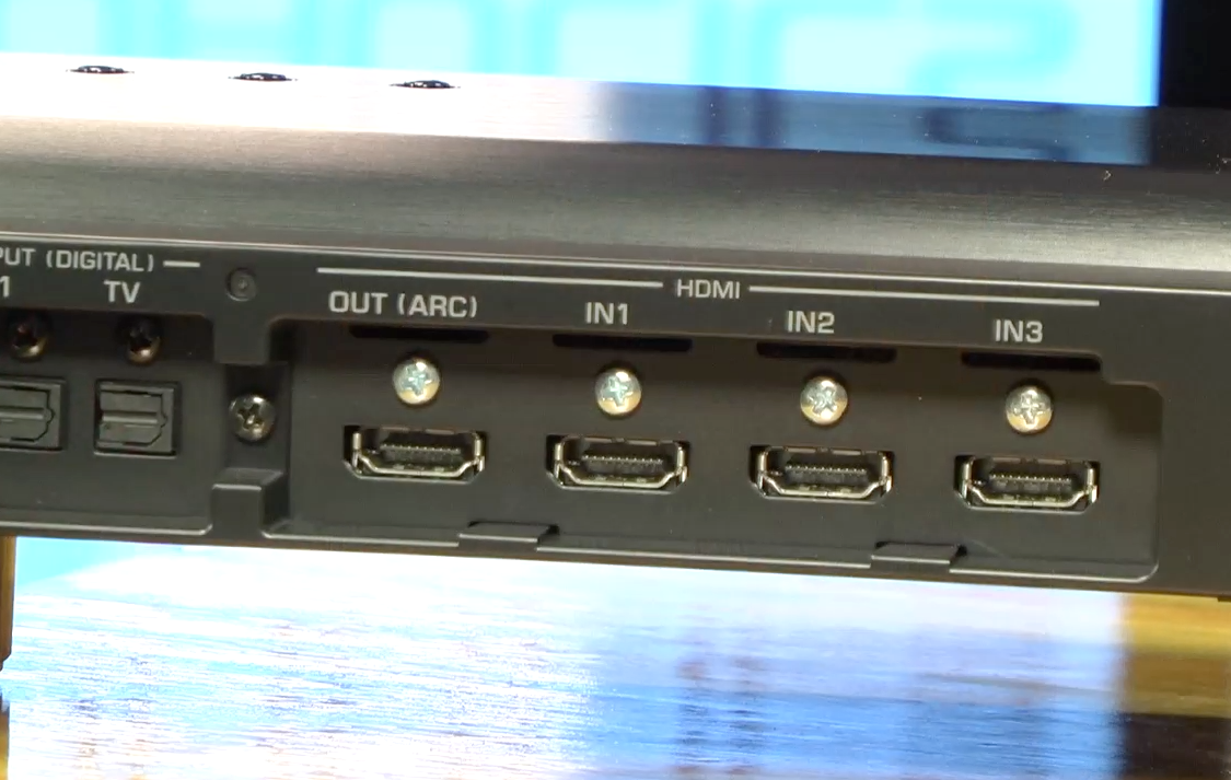

Of course, with the YSP-2200 it uses 16 tiny speakers that are aligned across the front. The system itself is only 3-1/8" high and it has removable and height-adjustable feet so it can have a really low profile as it sits in front of your tabletop flat panel TV. The included subwoofer is meant to hide nearly as well and it can be mounted vertically or horizontally. Aside from that it has many of the same features you'd expect to see in a traditional sound bar - three HDMI inputs and one output, 2 digital optical inputs, 1 TOSlink digital input, and an analogue stereo input. With the HDMI inputs, the YSP-2200 can even decode the high resolution audio formats up to 7.1. There's even a dock port for adding optional YID-W10 wireless iPod transmitter, YDS-12 iPod dock or YBA-10 bluetooth receiver.
HDMI inputs

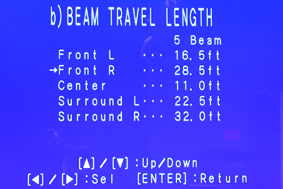

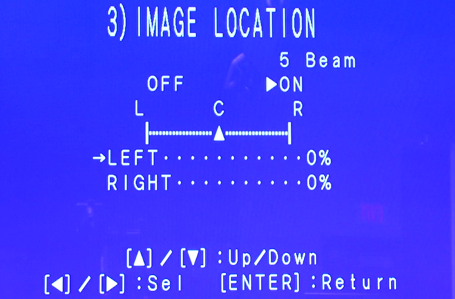

The 2200 can all be setup automatically with an included microphone and a single button press on the on-screen menu. You can also see the menu, input and status on the front LCD panel. To run setup, you just plug in the mic, clear the room and Yamaha does the rest. When you're done, you've got a virtual 5.1 system that will actually decode real Dolby Digital and even allow you to apply Dolby Pro Logic II and DTS Neo surround to 2-channel audio sources. Well, sort of. Chances are that if your room is somewhat rectangular you're all done, but if you have a more complex or open layout, you can then manually dial in the surround using the Beam Adjustment feature of the Setup Menu. The 2200 has, as we mentioned, an on-screen menu that is pretty basic, and only operates from the single composite video output - HDMI doesn't support the OSD. Using the menu you can adjust the angle, beam length and even the focal length. You can also adjust the image location, which has to do with the virtual position of the left and right speakers. This is handy for when you need to widen or readjust the front soundstage, or the distance between the perceived left and right speakers.
beam travel location

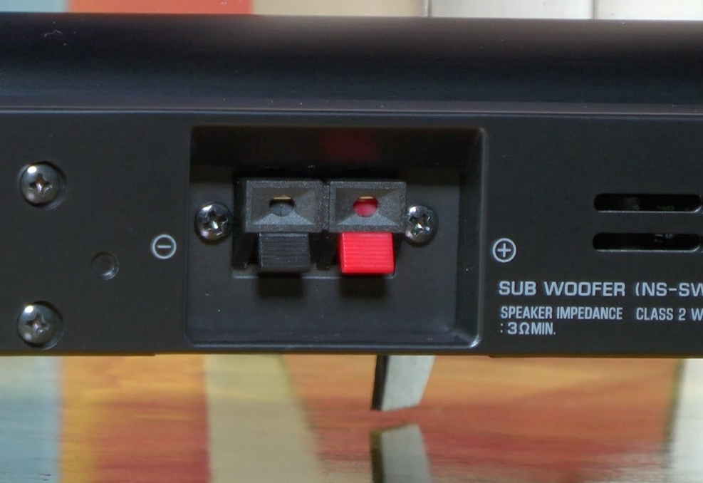

We ran auto setup and then dialed everything in until we could hear, quite distinctly in fact, our 5.1 system. We then verified the surround sound experience by feeding the YSP-2200 a few select scenes, including the podracing chapters from Star Wars Episode I: The Phantom Menace and the opening scenes from Saving Private Ryan. In both movies, it was incredible to actually hear surround effects that were so pronounced. We kept remembering, there are no actual speakers behind us, yet podracers, ricochets and explosions came seemingly out of the walls. The only thing that we felt was lacking was the subwoofer which, unfortunately, is powered by the YSP-2200. While we liked the reduced footprint of the included sub, for those who want some serious slam, we recommend an upgrade. Any sub that accepts speaker-level inputs will work well.
speaker connections
