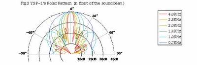

"The key is the size of an audio image. In the past it was said that a point source was the ideal for a sound source. That was correct for stereo but what about surround sound? The YSP-1 has been designed with the intent of paying more attention to the connectivity or extensity of a sound field than to the presence or localization of the sound image" (Extensity: In psychology, the quality of sensation which permits the perception of space or size.)
Extensity is an accurate description of the spatial envelope this Digital Sound Projector can portray. One gets the very new and somewhat eerie sense of the space within the room being defined by a movie's surround content. To illustrate; without the oft-times intrusive consciousness of in-wall speakers installed in the corner behind me and to my sides I can now sense the "sound bubble" of a particular movie from the prospective of the bigness or smallness of the effect itself. In other words, I think I'm hearing what the director and sound editor may have intended when he mixed in-studio from his fixed-position surround speakers.
It is this effect, this ability of the sound field to expand and contract depending on program content that is most difficult for my auditory memory to wrap around and get a firm grasp of. Many of us, after all, have been listening to surround from known, fixed speaker locations for almost a generation.

1 Ltd's Design Engineer adds:
One of the subtle but very powerful advantages of generating all of the 5-channel sound from the same set of loudspeakers and amplifiers is that there is inherent dynamic power sharing; so that when one channel is quieter it leaves all its unused headroom available for use by the other channels. Thus, the continuous max power available on any one channel is the same as the continuous max power available on all channels simultaneously.
