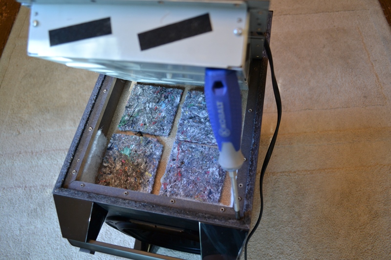

A 2” deep cavity on the rear of the unit houses the amplifier and has padding to prevent the amp from rattling during use. The main cavity houses the 7” active driver and 8”x12” passive radiator. Both are stamped basket. I wasn’t able to remove the active driver, but I could feel that it has a vented pole piece for improved heat dissipation. It also has a bucking magnetic to reduce the magnetic field for CRT displays. I’m not sure why these are still used on products like this as the subwoofer likely won’t sit by a CRT display. The cord from the amplifier was wrapped to prevent it from slapping around the cabinet. The bracing in the cabinet was minimal, really, pretty much nonexistent except for some extra MDF glued to the inside of the cabinet. You’ll note the round piece of MDF glued to the inside of the cabinet, which is the cutout from the driver. Although not visible in the pictures below, there was one piece batting glued to the back panel. Finally, the sub measures up at 9 ½” W× 15 ½” H × 16 ¼” D, making it pretty compact, especially considering that 2” of the height doesn’t add to the internal volume because it’s from a base that the subwoofer sets on. That’s in addition to the 2” deep amplifier enclosure. Obviously, most consumers looking for a soundbar don’t want a giant sub, so I thought the size was fine considering the application. However, the build quality leaves something to be desired.

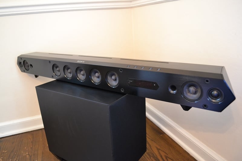

As for the soundbar itself, it sports an impressive array of 9 drivers in a T-M---M-M-M-M-M---M-T arrangement. The tweeters are.8” (20mm) domes and the midrange drivers are 2.56” (65mm). I was unable to find out the driver material used, but the midrange drivers look like woven fiberglass. The two tweeters and woofers flanking the outside of the soundbar are in separate enclosures from the five midrange woofers in the middle. At first glance, it looks like the pair of drivers on the outside of the unit are in ported enclosures, each with a small front firing port. Only when I was moving the soundbar around during measurements did I notice that the port is not actually a port. It just looks like one but is actually completely closed (There is a close up picture of this further into the review).

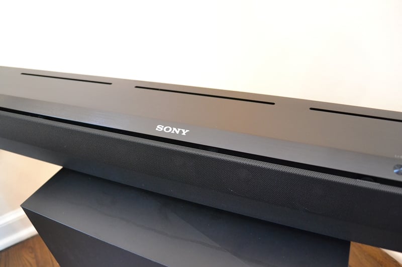

Seven independent 50w amplifiers power the 9 drivers, presumably with the two outside pairs of drivers each powered by a single amplifier. Sony touts the use of a high quality aluminum enclosure, which I do think looks nice, but most of the unit is actually constructed from plastic, including the sides, rear, and bottom.
ST7 Grill On
Sony HT-ST7 Grill On

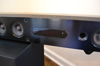

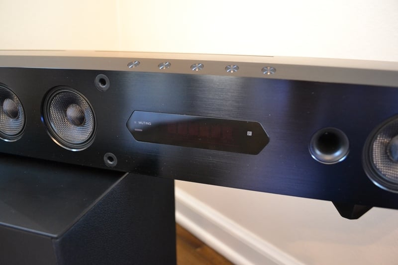

ST7 LED Display
Sony HT-ST7 LED Display
The single line LED display on the front of the HT-ST7 is large and easy to read, but makes navigating the internal menu a bit difficult. If you dig through the manual you can eventually find your way around the menu as well. A plethora of useful features, like AV sync/delay, a dynamic equalizer to attenuate volume changes between channels and commercials, and a compressed music enhancer, await those who are willing to drudge through the menu.

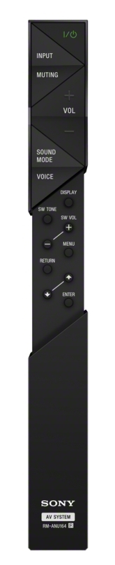

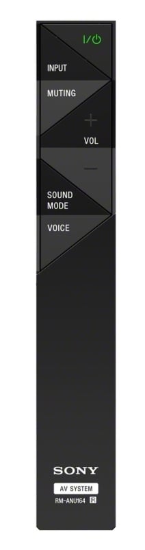

ST7 Remote Closed                           ST7 Remote Open
Sony HT-ST7 Remote Closed (Left); Open (Right)
The final bit of operation to cover is the included remote control. At first glance I was skeptical about the remote thanks to its unique design, but that skepticism quickly faded. The most commonly used buttons are easily located. This includes: powered, input, muting, volume +/-, sound mode, and voice. But there’s more than meets the eye. The bottom part of the remote slides down revealing another 9 buttons (reference the above photos). In the hidden compartment is housed the navigation controls for the menu, subwoofer settings, and a display button to dim or change what is shown on the front LED display. These buttons are small, cramped, and slightly recessed making them even more difficult to reach. Normally I wouldn’t care much about the hidden buttons if they were seldom used, which they are meant to be, but I found myself using them quite a bit.

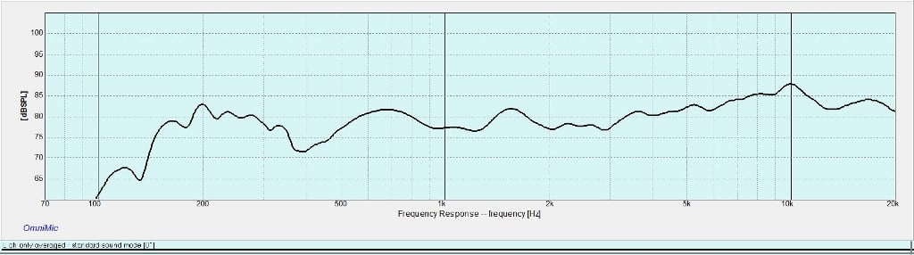

ST7 average FR
Sony HT-ST7 In-room Averaged Frequency Response
Still, the measurements showed me exactly was I expected in terms of high frequency response. The boost in treble over 3kHz certainly attributed to the thin vocals or slightly harsh sound I heard at times. Same goes with the bump at 1.5kHz. The steep drop around 200Hz shows where the subwoofer takes over, which was about where I was expecting from listening tests and measuring other soundbars.

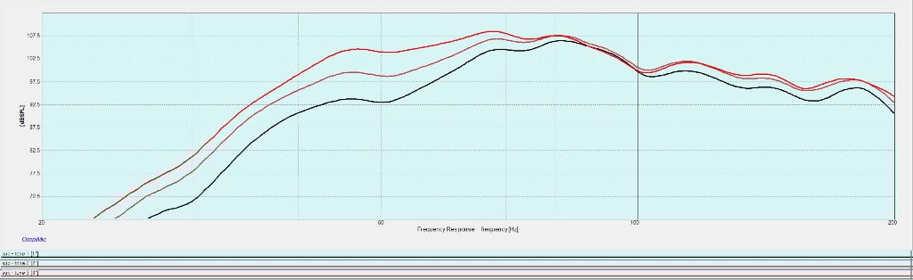

ST7 Sub FR2
Sony HT-ST7 Subwoofer In-room .5m Groundplane Frequency Response
Measuring the subwoofer was more straightforward. Each line represents a different subwoofer tone setting. I was not able to isolate the subwoofer apart from the soundbar, as the soundbar has to be on to measure the sub. That’s why it looks like the sub plays up to 20kHz. Moving the mic closer to the active driver boosted output over 60Hz. Moving it closer to the passive radiator increased FR below 60Hz, showing the benefit of the passive radiator. The graph speaks for itself, but suffice it to say that this subwoofer does not dig low nor does it exhibit a  very linear response.  However the boost in the 40-60Hz range does help to provide a fuller sound for the system.

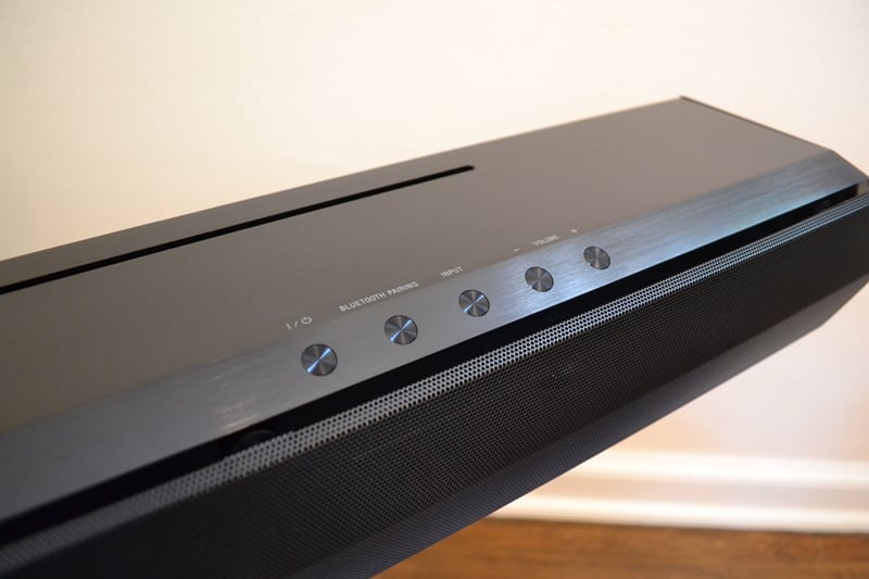

ST7 Buttons
Sony HT-ST7 Top Panel Controls
With completely active systems, like the HT-ST7, manufacturers tend to get creative. By offering adjustments like subwoofer tone, and soundbar voice and sound mode options, users are given a tremendous amount of power to manipulate the sound. While this can be good, it was mostly annoying for me. Don’t get me wrong, I’m glad Sony included these adjustments, but I was never able to find a single setting that worked well across all material. I was constantly flipping through different sound modes and adjusting the subwoofer up or down based on the source to get it to sound the way I wanted. This shouldn’t be necessary. A user should be able to just leave a product on “standard” and only have to make occasional, minor adjustments to the EQ of the system to dial it in the way they want.  Additionally, I would have preferred to be able to turn surround simulation on or off without affecting the EQ of the entire system.
So, in the end, my advice to Sony would be to keep the features and core functionality the same for next year, but rethink the tuning and manual sound adjustments. Oh, and beef up the subwoofer too. Let’s try to get some good SPL down to the 30Hz range and also get more usable low frequency output from the soundbar to increase vocal clarity.
