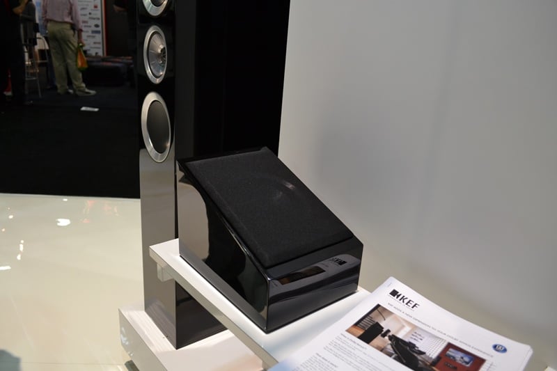

KEFs new R50 sitting atop their R700 tower speakers.
KEF's new R50 sitting atop their R700 tower speakers.

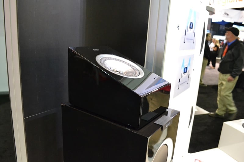

If you haven’t been paying much attention to the A/V world lately, it’s fair to say the official unveiling of Dolby Atmos at CEDIA this year has attracted quite a bit of attention. What is this Atmos thing I speak of? In short, it is Dolby’s new object-oriented surround format which makes the jump from 2-dimensional 5.1 and 7.1 formats to 3-dimensional sound. For consumers looking to upgrade their systems in order to support this format, you have 2 options in terms of loudspeakers: you can either add in-ceiling speakers or Atmos-enabled speakers. Priced at $1,200/pair, the KEF R50’s are an example of the latter option, which fires a driver array towards your ceiling, which combined with Dolby’s proprietary DSP magic, creates a virtual height channel.
Design Overview
In many respects, the KEF R50 isn’t what we’d qualify as a groundbreaking loudspeaker. The driver array, a two-way concentric design, is taken directly from KEF’s pint-sized R100 bookshelf speakers, although the R50’s feature a sealed enclosure versus the vented box of the R100. The array is angled at 20 degrees, and features a 1” aluminum dome tweeter nested within a 5.25” aluminum mid/woofer. This arrangement has several benefits, chief for this application being controlled directivity. In contrast to some Atmos-enabled speakers which rely on a “lip” to control directivity at the cost of potentially introducing diffraction effects, the R50’s mid/woofer acts as a waveguide for the tweeter, constraining its dispersion pattern. Per Jack Oclee-Brown, KEF’s senior research engineer, the directivity control provided by the concentric arrangement was sufficient on its own to fit within Dolby’s spec for Elevation speakers. While KEF did experiment with a lip, they found that it introduced diffraction without offering any meaningful improvement.
R50 With Grill
A shot of the KEF R50 with the grill on.
