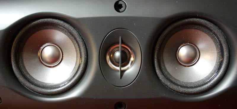

Each of the 5 speakers has dual 3.5-inch mid-bass drivers and one 0.5-inch titanium-laminate dome tweeter arranged in an MTM configuration, and all are magnetically shielded. Turning them around reveals real binding posts, which is a feature almost always overlooked on speakers systems in this class.

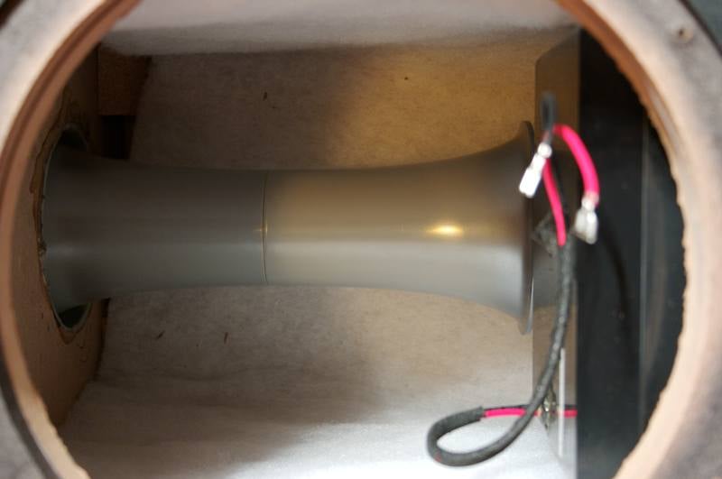

The subwoofer is built from 0.75-inch MDF and has a thick front baffle. Internally I would like to have seen more bracing as rapping on the sides does reveal some resonance. Also, the use of T-nuts instead of just wood screws holding the sub to the baffle would have been nice to see as well, but that is a minor complaint.

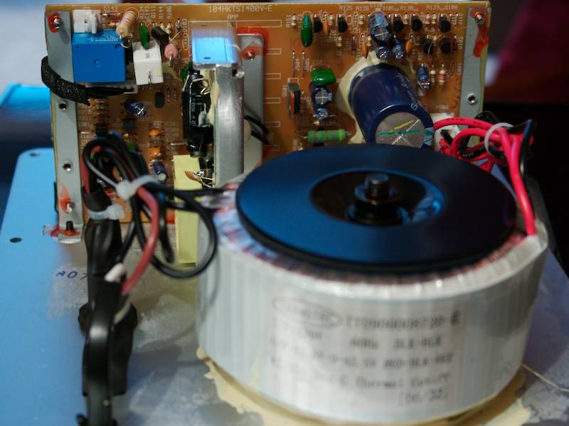

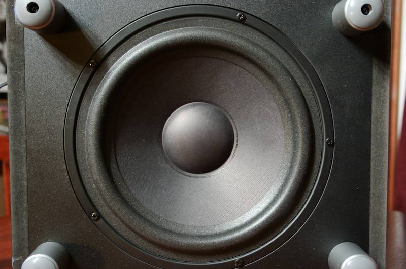

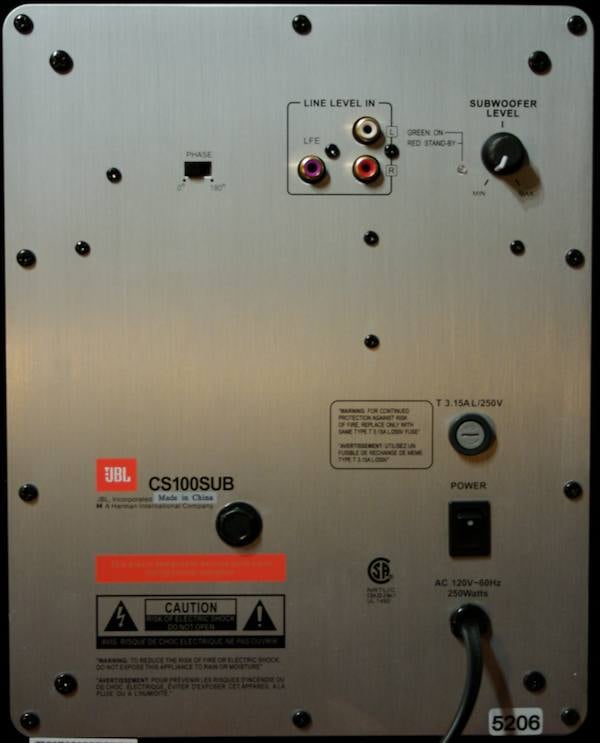

The sub sports a fairly typical 10-inch driver and a 150-watt amp that has a nice hefty size coil. Of special note is the fact that the driver uses a vented pole piece and decent magnet structure. Also, the feet on the bottom are tipped with rubber to prevent scratching and sliding around on wood and tile floors. The amplifier panel has one LFE input, left and right line level inputs, phase switch, level control, power switch and a fuse. You won't be able to use this sub with speaker level outputs, so make sure you have at least some kind of preamp or subwoofer outputs coming from your receiver. Overall the fit and finish is good and the sub is sharp looking.

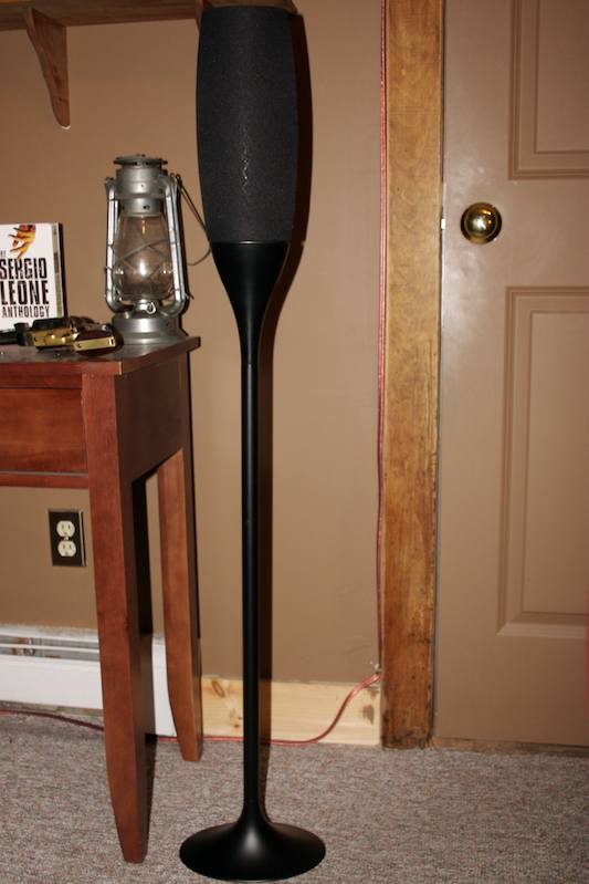

Everything came nicely packed and well-protected, and JBL was nice enough to send along two pairs of optional stands as well. The stands were very nice looking and also weighted at the bottom. I used these beautiful speaker stands for the surrounds. All the speakers are threaded at the bottom for various stand types and also have a rubber ring for furniture protection and to keep from sliding around on smooth surfaces. These are all nice little touches so kudos to JBL for including them.
The center channel is designed to sit horizontally, but this is not
necessarily the
most optimal position for an MTM speaker alignment because of
dispersion issues
for any listeners that are not seated in the center. MTM alignments
were
designed to limit vertical dispersion of the tweeters to help alleviate
reflection issues, and the result is a very narrow focus of the tweeter
vertically. This is a good thing. However, when an MTM alignment is
placed
horizontally the opposite happens - though some speaker designs do a
good job at smoothing out this phenomenon. Also,
the center speakers little feet allow the speaker to tip forward very
easily.
If small children or pets are in the house, I strongly recommend using
the
included wall mounts if at all possible as well as mounting the speaker
vertically for optimum coverage throughout the listening
area. I would like to see, at the very least, a future design that
provides a custom center channel speaker which offsets the tweeter.
