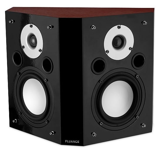

Surround speakers, take these XLBP bipole's from Fluance for example, fill an important role in the modern home theater: they immerse you in the action with ambient noise and occasionally they're called to deliver some big effects. Still, in spite of their critical role, they're an area where people have a hard time justifying a big expenditure given that the bulk of the content in any surround mix, be it movies or music, remains on the front stage. So what's a guy to do if he doesn't have big bucks to blow on the surround channels, but he wants a good experience? Enter Fluance. Their XLBP Bipolar surround speakers are priced at a relatively low $200/pr, and each speaker boasts a pair of tweeters mated to a pair of 5" polymer mid/woofers in a vented enclosure. Does Fluance have the fix for your surround sound dilemma?
The Facts And Figures
The Fluance XLBP appears to be a relatively typical surround speaker, employing a bipole design featuring a 1" silk dome tweeter and 5" polymer mid/woofer on each of its pair of faces. The tweeters hands off to the mid/woofer units at 2,200Hz, which then deliver output, along with a quartet of ports, down to a respectably low 60Hz (no tolerance is given). Assuming the 60Hz figure is based in reality (it's certainly not an outlandish claim), we'd expect the Fluance XLBP should work quite well with the typical 80Hz crossover to a subwoofer. The XLBP has a rated sensitivity of 88dB and a nominal impedance of 8 ohms, suggesting that the speaker shouldn't be particularly difficult to drive, which is an important factor at this price point. All in all, just judging by what we can see at a glance, the Fluance XLBP seems to be a well executed surround speaker.

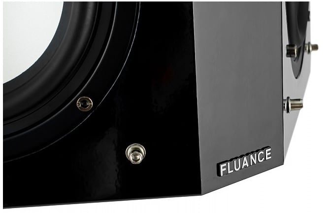

Fluance XLBP Close Up
A close up view of the Fluance XLBP surround; even the little details like the grill posts don't look too shabby.
