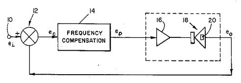

Fig 2: Illustration from U.S. Patent # 4, 727,584, “Loudspeaker With Motional Feedback”
In the DD-18 we find the successful embodiment of such patented, innovative technology, 2+ decades of design & build know-how and some exceptionally useful extra features.

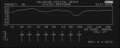

Power up the DD-18 and the introductory screen is what your OSD greets you with. It presents basic operational information such as Firmware version, Model ID, sub volume and whichever default preset has been selected.
Punch “Menu” then “12345” on the remote and you’re taken to the System Response\PEQ Screen (Figure 9). Here, the system indicates the volume is at 30, manual mode is in effect and the response is flat lining as the supplied setup mic was not connected to the system when the screen capture was done.
Setting equalization can be fully automatic, fully manual or a combination of the two, letting, the DD-18 run the equalization set up automatically, then manually tweaking the results. The system monitors the process and its effects on the resulting dB spl curves via the supplied mic. Being able to watch changes in DD 18’s amplitude response due to changes made at the PEQ is as useful as it is efficient.
Figure 9: System Response\PEQ Screen

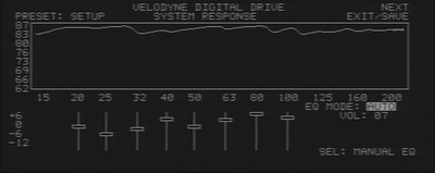

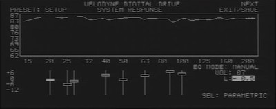

So how well did the PEQ work?
Pretty well, actually. Figures 12, 13, and 14 tell the story.
Figure12 is the pre-AutoPEQ picture, Figure 13, post-AutoPEQ and Figure 14, post-AutoPEQ followed
by a modest amount of manual tweaking. Subjectively speaking, the audible difference between the system response as seen in Figure 12 & 14 was truly substantial; best described as the lowest few octaves of the system pulled into focus, delivering an increase in precision and clarity that would have to be heard to be believed. Excellent!
There are a couple things that should be kept mind when viewing the figures. First, the plots generated by the Velodyne display are 1/3rd Octave smoothed. Second, the amplitude response generated is for the main listening position only; move away from that position and the response will change both audibly & measureably.
Figure 12: System response, pre- AutoPEQ, as measured at the main listening position 9’ (2.7m) directly in front of sub.
Figure 13: System response, post- Auto PEQ, as measured at the main listening position 9’ (2.7m) directly in front of sub.
Figure 14: System response, post- Auto PEQ, with additional manual tweaking, as measured at the main listening position 9’ (2.7m) directly in front of sub.

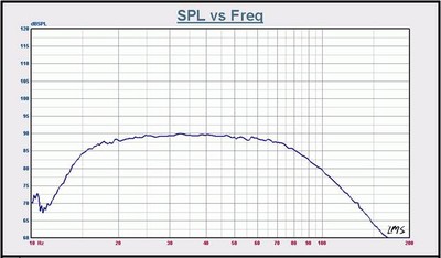

Graph 1: System amplitude response, 1m, On-axis @ 2.828 Vac , Preset 4 Engaged. Measurement environment: Outdoors, nearest reflecting surface: 30m (~100’) No smoothing applied.
In Graph 1 we see the DD-18, measured outdoors, pole-mounted, driver firing upwards, approximately 30m (~100’) above the ground. The system’s measured amplitude response goes far in explaining the sub’s exceptional subjective characteristics. The smooth mid-band performance, artifact-free low & high frequency roll off, are all factors contributing to the systems 5-star performance. (The hashy appearance of the response plot in ~<12 Hz was due to a low flying airplane that happened by while the sweep was underway and should be ignored).

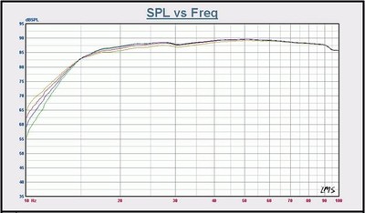

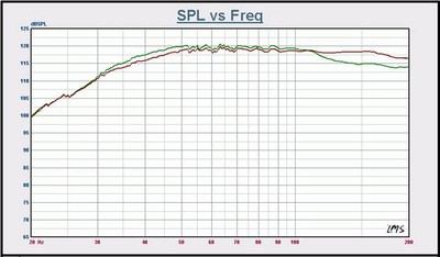

Graph 2: Max dB spl curves, 2m, on-axis, scaled to 1m. Green curve: Servo @ 1, Red Curve: Servo @ 8. Measurement environment: Anechoic.
Graph 2 shows the DD-18’s max. dB spl response plots, with two curves provided to present the systems response with Servo gain at 8 and at 1.Increased distortion components add in to the mix increasing dB spl output slightly at Servo setting 1. The degree to which increased distortion will increase the overall amplitude magnitude is frequency dependent. Note also the upward shift of the LF knee when compared to that seen in Graph 1. This results from the processors functioning correctly and keeping the driver’s excursion within software-defined, safe limits.

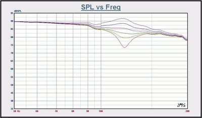

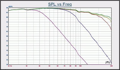

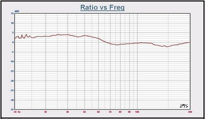

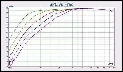

Graphs 3 – 8 are a walk through the various digital processing features built in to the DD-18; tested/measured not only to see if they work (don’t laugh – I’ve bumped into subs where some of the processors didn’t function correctly) but how and how well they work.
The subsonic filter (Graphs 3 & 4), Contour EQ (Graph 5)(acts as an extra, limited-function EQ), low pass crossover (Graphs 6 & 7), and PEQ in combination with the supplied mic (Graph 8, along with Figures, 12, 13, and 14) are all essential features that help the end user integrate the sub with their existing system while at the same time maximizing the performance of the sub within that system, further helping to maximize the performance of the entire system. With the comprehensive array of processor/control features and the Velodyne everything-is-important design approach where it comes to the cabinet, driver, servos, & power amp, you have in one neat package all the ingredients for a world-class sub. Just get it. You can always turn it down later if it’s too loud.
Graph 3: Subsonic filter slope, 6, 12, 18, and 24 dB/Octave. Filter frequency: 15 Hz. Measurement  environment: Nearfield, scaled to 1m.
Graph 4: Subsonic filter frequency, 15 to 35 Hz in 5 Hz increments. Slope set to 24 dB/Octave Measurement environment: Nearfield, scaled to 1m.
Graph 5
Graph 5: Contour EQ: +6 dB to -12 dB in 3 dB increments. Contour frequency: 120 Hz

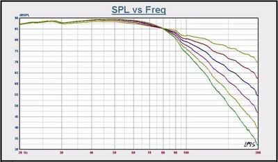

Graph 6: LP Crossover: Slopes from 6 to 36 dB in 6 dB increments. Crossover frequency: 80 Hz. Measurement environment: Nearfield, scaled to 1m, On-axis @ 2.828 Vac.
Graph 7: LP Crossover Frequencies: Off, 40, 80, 160 & 199 Hz. Slope: 36 dB/Octave Measurement environment: Nearfield, scaled to 1m, On-axis @ 2.828 Vac.

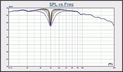

Graph 8: PEQ, Varying Q @ 50 Hz. Q = 3, 6, 9, 12, 15 & 20. Measurement environment: Nearfield, scaled to 1m, On-axis @ 2.828 Vac.
