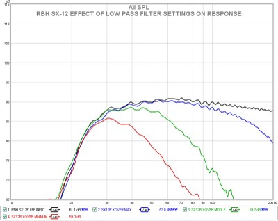

RBH Sound SX-12: Effect of Low Pass Filter Settings
I took a measurement of the RBH with the low pass crossover of the SX-12 bypassed using the LFE input and at maximum, middle and minimum settings to observe its effect on the response shape. This is presented in the graph above. The slope of the SX-12’s low pass filter appears to be 24dB/octave and corresponds very well with the listed 40-150Hz range specified by RBH.

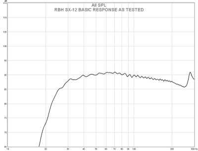

RBH Sound SX-12: Basic Frequency Response as Tested
Above is the response of the SX-12 as configured for most of the measurements. RBH lists the response of the SX-12 as 27-150Hz +/-3dB. The as measured response easily matches and in fact surpasses that specification on both ends of the frequency range. The SX-12 response actually fits into a 25-250Hz +/-3dB window. I discounted the response past 250Hz due to the port resonance at about 280Hz. The SX-12 should have no problems mating with even the most bass shy main speakers. The 36dB/octave roll of below 30Hz indicates that the system port tuning is near the 25-30Hz range and that there is probably a 12dB/octave rumble filter in place to attenuate content below the system tuning point.

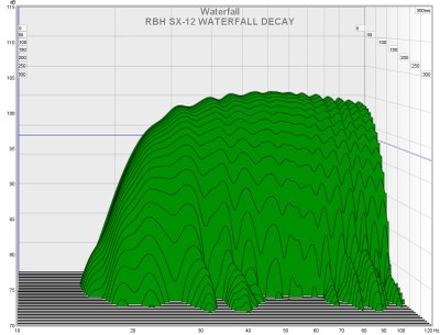

RBH Sound SX-12: Waterfall Decay

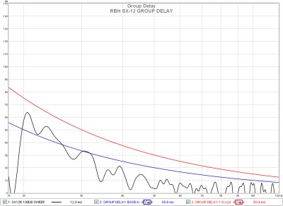

RBH Sound SX-12: Group Delay
The waterfall and group delay plots for the SX-12 show no appreciable issues and are commendably well behaved throughout its entire useful range of operation. There is a slight amount of prolonged energy between 20 and 30Hz but it just barely breaks 1 cycle of delay. This is a good showing for a bass reflex design.

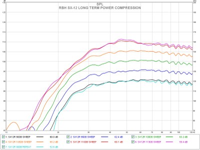

RBH Sound SX-12: Long Term Power Compression
The results of the long term power compression sweeps show that the SX-12 maintains its response shape well up through the 105dB sweep, but has entered significant compression by the 110dB level. Increasing the level further to what would nominally correspond to 113dB at 50Hz resulted in virtually no further output. The SX-12 did exhibit some port wind noise on the last two sweeps and also some minor overload type noises below the tuning.

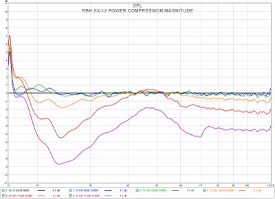

RBH Sound SX-12: Power Compression Magnitude
Looking at just the magnitude of compression occurring during the sweeps we can more clearly see where it is occurring. The large amount shown centered near 25Hz is probably mostly attributable to compression and overload of the port. This is typical for ported systems. The negligible increase in output on the 113dB sweep indicates that the SX-12’s limiter was already engaged during the 110dB sweep level.
