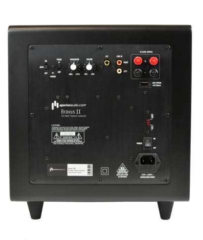

Inputs/Outputs
- Unbalanced (RCA) inputs, left and right
- Unbalanced (RCA) LFE input
- Speaker level left and right inputs

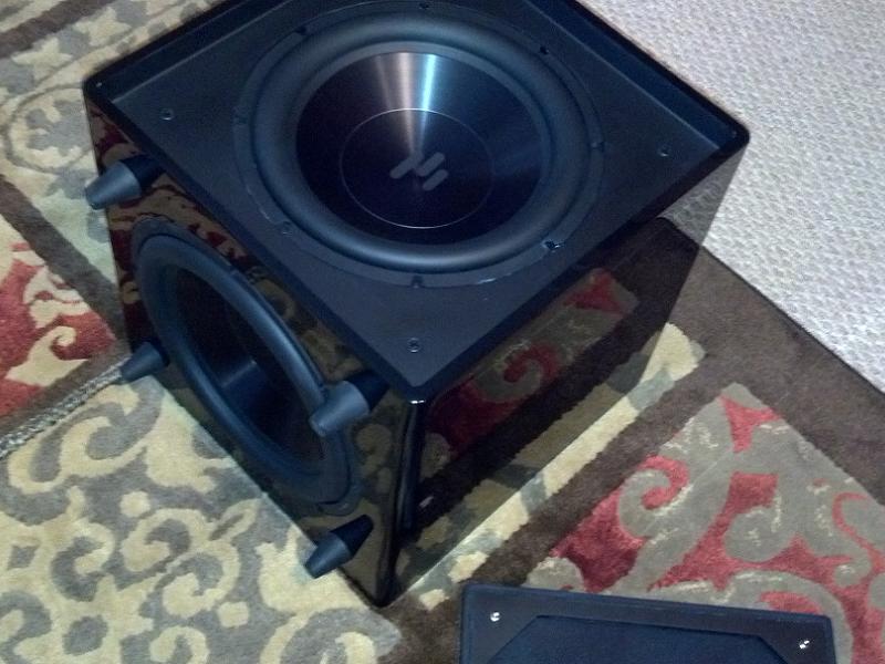

Design Overview
The Bravus II 12D is a very compact
bass reflex design utilizing a 12” down firing active driver and a pair of side
firing 12” passive radiators instead of the typical port vent in a small 15.5”
cubed cabinet constructed of 1” HDF. The plate amplifier occupies the entire
back panel of the enclosure which leaves only 2 faces without either a driver
or controls on them. This is a packed little enclosure! I am a fan of using
passive radiators over ports in compact bass reflex designs like Aperion has done
here. Many consumers will want a small, light, good looking subwoofer, but also
want maximum performance from the standpoint of both extension and output. These
goals are at odds in many cases. One typical way to offer a lot of output for a
modest cost is to have a larger vented subwoofer in order to make the most of modest
components. However these systems are typically larger than many consumers will
want in their room, let alone multiple units and they are typically more
expensive to ship and not finished as well. In the other direction you
typically have sealed alignments which can be very small but rely solely on the
driver for output and are the least efficient design. In order to make a lot of
output for headroom and extension in a small sealed design requires a robust,
heavy duty driver design and a lot of amplifier power, both of which indicate
high quality components that cost more money. Conversely you can choose to use
components of lesser quality in a sealed design of course but the extension and
headroom of said unit will suffer even further as a result. The use of a
passive radiator set-up is a good way to split the difference between bass
reflex and compact sealed and I am surprised that it is not utilized by more
manufacturers. Passive radiators have many advantages over ports. They have no
pipe resonances and they do not eat up the internal volume of the enclosure as
much. The passive’s can have mass added in order to achieve a lower tuning in a
very small enclosure volume than would be physically possible with a vented
system. The lower your tuning the longer your port needs to be for a given
enclosure volume so there becomes a point where a tuning with a port simply
becomes impractical. Passives also do not suffer from vent noises or port
compression, which often sets in much earlier than thought on many vented
systems, especially when vent area is compromised in order to get a low tune
from a small cabinet. Passive radiators also do not provide an opening into the
cabinet for critters to crawl in or “little ones” to drop random inexplicable
items into. However, passive radiators do add extra cost and complexity to the
design as the suspension characteristics and mass of the passives need to be
carefully vetted in order to ensure that the design goals are met. A good rule
of thumb when using passive radiators is to use passives with 2x the cone area
and twice the volume of displacement of the active driver at minimum in order
to minimize the chance of overdriving the passives at system tuning. Aperion
has done just that and additionally has mounted the passive radiators on
opposing sides of the enclosure. This will cause the mechanical forces of the
passive radiator diaphragms to cancel each other out. This is a good design
choice as passive radiators are typically very heavy and can cause shaking of
the entire enclosure at high volumes if this is not done.

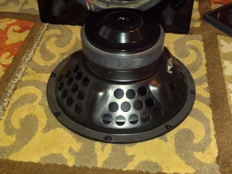

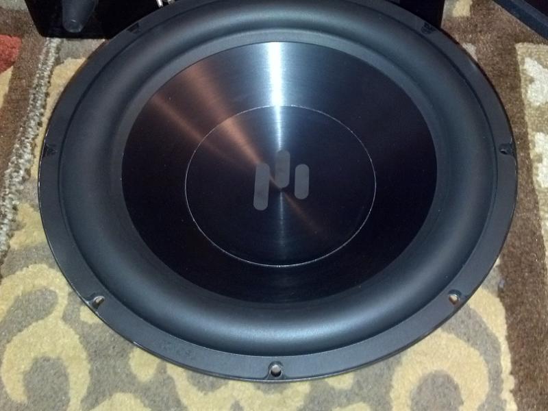

Once removed from the enclosure, the driver of the Bravus 12D appeared to be a fairly heavy duty and long throw unit as did the passive radiators. All appear to be of good quality and commensurate with the price range of the finished product. The frames, cones, cosmetics and soft parts of all three are identical. All use an aluminum cone with an inverted dustcap embossed with the Aperion logo and a suspension consisting of a small rubber half roll surround and a 5” diameter spider. The frame is a sturdy stamped steel unit with plenty of venting. The passives are open to the back and each have three small weights attached to tune their resonance. The active driver has a 2” diameter voice coil and a motor with a single magnet slug of about 5.5” diameter and 1” thickness. The t-yoke has a large bump out to clear large excursions.

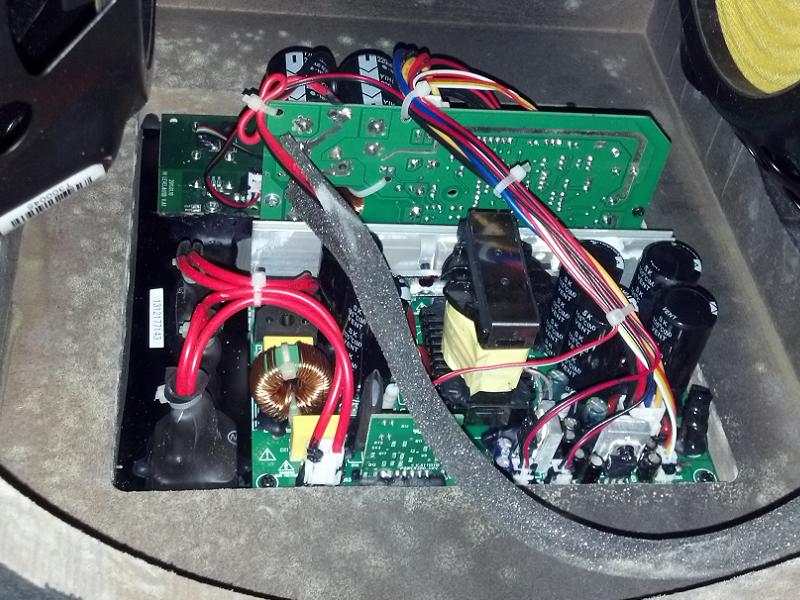

The amplifier is an efficient class D switching type rated at a generous 650 watts, which should provide plenty of power to excite and control the system. The input and output connections and controls available for the 12D on the amplifier are very basic consisting of only: RCA style left, right and LFE inputs, speaker level inputs and outputs for connecting to systems without a dedicated subwoofer output, a 0-180deg phase control, auto/on/off switch, main power switch and input gain adjustment. Aperion even makes mention of getting rid of frivolous and seldom needed features in order to keep the final cost down in their literature, a stance which makes a lot of sense when trying to offer maximum performance for the dollar. What controls are left on the unit are more than what is necessary to integrate the 12D into most any system.
Back View of the Bravus II 12D (left image) ; Bravus II 12D amplifier (right image)

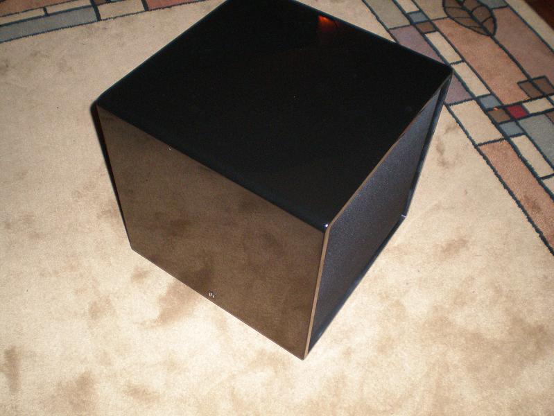

The enclosure of the 12D is constructed of 1” HDF and as previously mentioned is very nicely finished. There are some spots like under the grilles and drivers which are less than perfectly finished but considering the rarity that these points are looked at and the price bracket that this sub falls in this is completely acceptable in my view. Speaking of the grilles they are made out of a wood frame and fasten securely into place with fasteners that seem a little sturdier than most. After removing the driver to look at the internals it could be seen that the 12D did not use any lining or stuffing material inside of the enclosure and only 2 small braces none of which were panel to panel cross braces. Considering the tiny size of this enclosure, the 1” wall thickness and the fact that 4 of the available 6 enclosure faces are taken up almost entirely by either the amplifier or a driver, the lack of heavy internal bracing or dampening does not concern me. In a larger more open subwoofer it would but this is a tiny shoe box crammed full of active components. This lack of concern was borne out in both the outdoor testing and listening sessions where the cabinet never exhibited any signs of resonances, rattles or other distracting colorations. Looking at the sum total of the parts and build quality it certainly looks like Aperion has put considerable effort into this design.

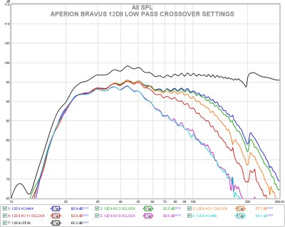

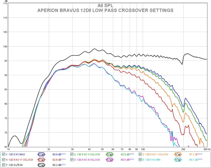

Aperion Bravus II 12D: Effect of Low Pass Filter Settings
A measurement was taken of the 12D with the low pass crossover bypassed using the LFE input and also at its maximum, minimum and settings corresponding to the 3,1,11 and 9 o’clock positions on a clock in order to observe its effect on the response shape. This is presented in the graph above. The effective adjustment range appears to cover what amounts to a 60Hz low pass to a 150Hz low pass with a 4th order roll off. Interestingly using the LFE input gives about a 4dB boost in input sensitivity.

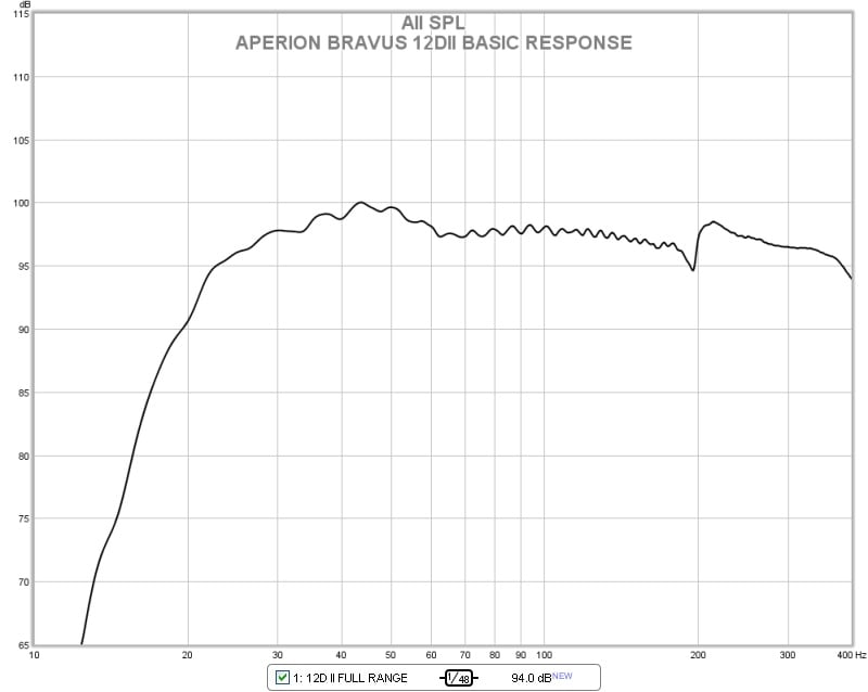

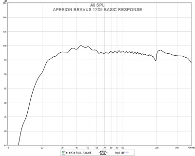

Aperion Bravus II 12D: Basic Frequency Response as Tested
The response shape of the 12D subwoofer measured using the LFE input stays within a 6dB total window from 22-400Hz which is very good and confirms Aperion’s response rating. There is a bit of a hump in response at 40-50Hz but this is low q and less than 3dB in total. The 12D is capable of running up as high as 180Hz or higher if needed to match small bass limited speakers.

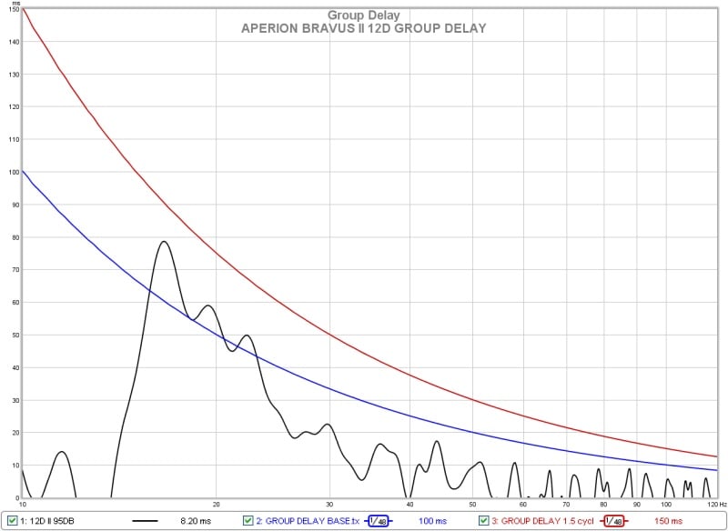

Aperion Bravus II 12D: Group Delay
The group delay plot for the 12D shows only a small increase in delay between 16-25Hz which is likely to be where the passive radiator tuning and rumble filter are located. However the total delay barely breaks 1 cycle and not until below 23Hz. 1.5 cycles is never approached. This is a fairly clean result for a bass reflex system and certainly there is nothing likely to be audible or worth worrying about shown here.

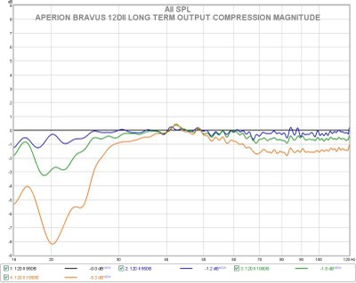

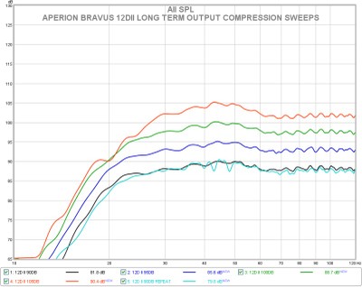

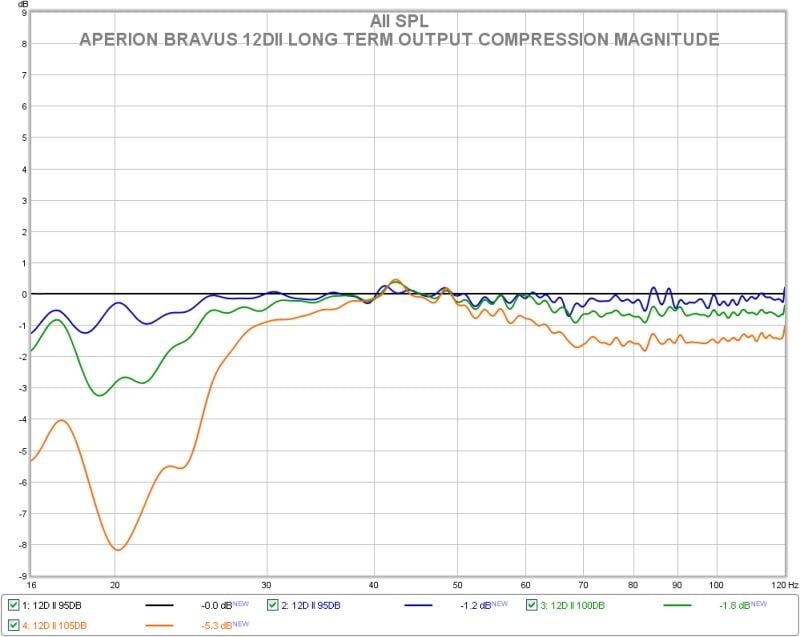

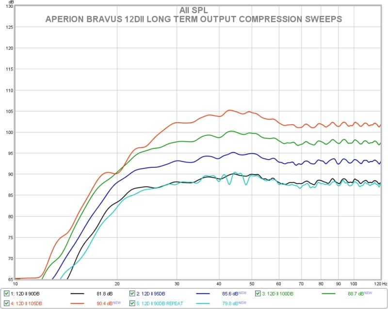

Aperion Bravus II 12D: Long Term Power Compression
The long term output compression sweeps for the 12D subwoofer indicate that the response shape is well maintained through the 100dB nominal sweep level. A 105dB sweep produced some overload noise from the passive radiators and active driver over a narrow bandwidth. The measurement appeared to indicate that this was around 20Hz as output barely increased there and compression below 25Hz was substantial. The subwoofer likely still has output headroom to go in the upper bass range but the testing was stopped here due to the behavior in the deep bass. It appears that the high pass filter to protect the system below the passive radiator tuning might be set just a bit too low in frequency. Being the nice guy that I am I decided to see what happened if I push the 12D even harder in the deep bass in an effort to ascertain whether the protection circuits would prevent the drivers from beating themselves to death below tuning. The limiter circuits did clamp down preventing any further level increases before any damage could occur. A simple change to a few components in the amp to raise the frequency that the rumble filter kicks in a little higher would likely prevent the driver noises entirely. This was the only objectionable sound that I could get out of the 12D and it seemingly only occurs when pushed very hard around 16-20Hz. Otherwise it was unfazed throughout the testing and listening sessions both and emitted no rattles, buzzes or bad resonances from the cabinet which was inert throughout.
Editorial Note on Output Compression Testing: This is by far the most demanding measurement type conducted on the subwoofers during our testing and will reveal any issues with overload, port compression, port noise, driver distress, creaks, rattles, buzzes, etc. Additionally the test is conducted outdoors with just the subwoofer operating so there will be no nearby walls or objects to vibrate and no upper frequency content from other speakers in operation. These would normally help to cover up or mask any objectionable noises from the subwoofer in a typical room. Any sort of audible distress or issues with the subwoofer are readily apparent in this environment.
Aperion Bravus II 12D: Output Compression Magnitude
Looking at the amount of compression exhibited only, it can be seen that the 12D performs well in this regard up until the point that the drivers in the system ran completely out of excursion near 20Hz. Above 30hz the compression is less than 2dB at the maximum sweep level used.

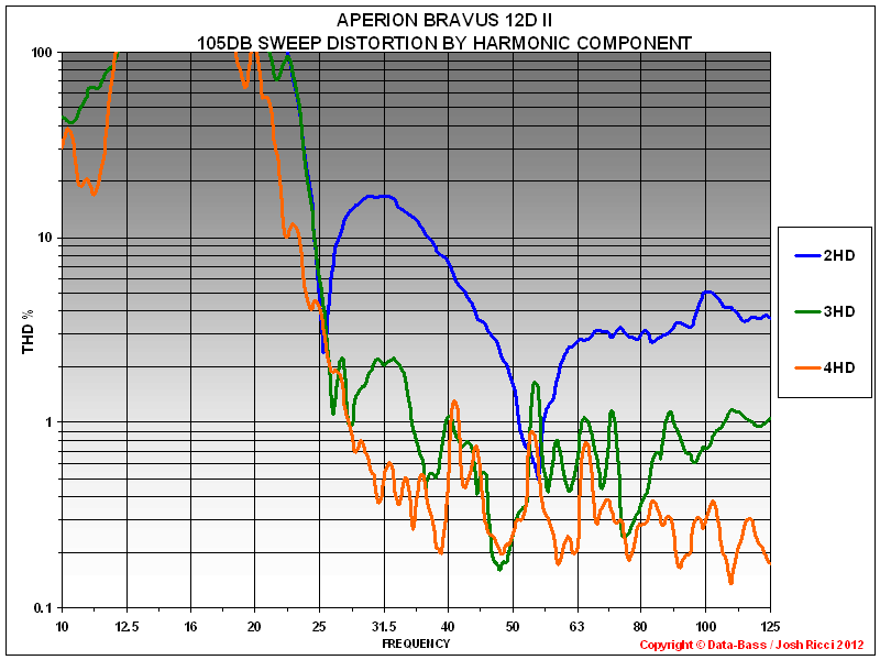

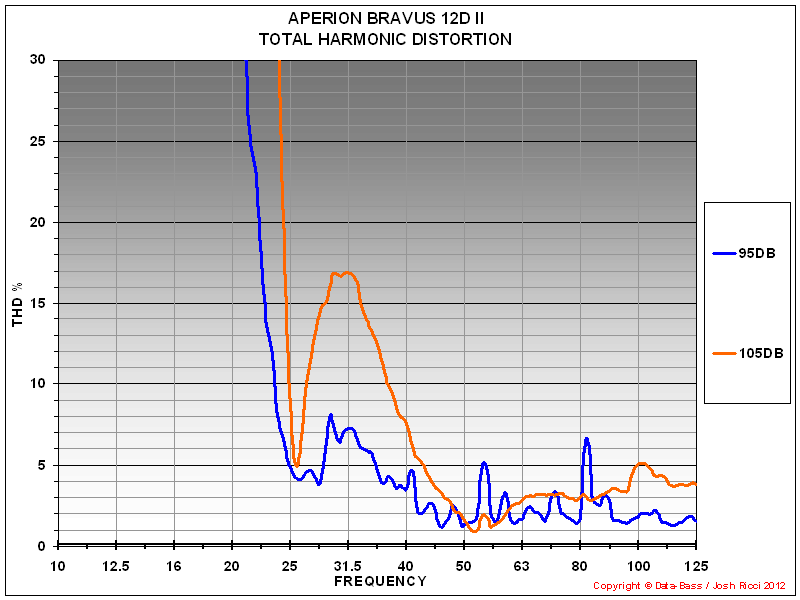

Aperion Bravus II 12D: Total Harmonic Distortion
Aperion Bravus II 12D: Distortion by Component
The distortion results for the Bravus II 12D presented above are rather good for a subwoofer of this size and price. Looking at the THD graph the notch in distortion right at 25Hz indicates that this is the likely tuning of the system. The increase in distortion levels to a peak at 31.5Hz indicates this is the area of maximum driver excursion above tuning. Above 35Hz the THD stays below 10% and below 5% above 40Hz. The distortion by component graph shows something even more interesting as the distortion percentage is greatly dominated by the 2nd harmonic which is largely held to be the least audible and in some cases a little H2 is even described as sounding better. The predominant 2nd harmonic distortion and the low overall distortion levels above 25Hz combine to indicate that the 12D will sound very clean in its useful range of operation.

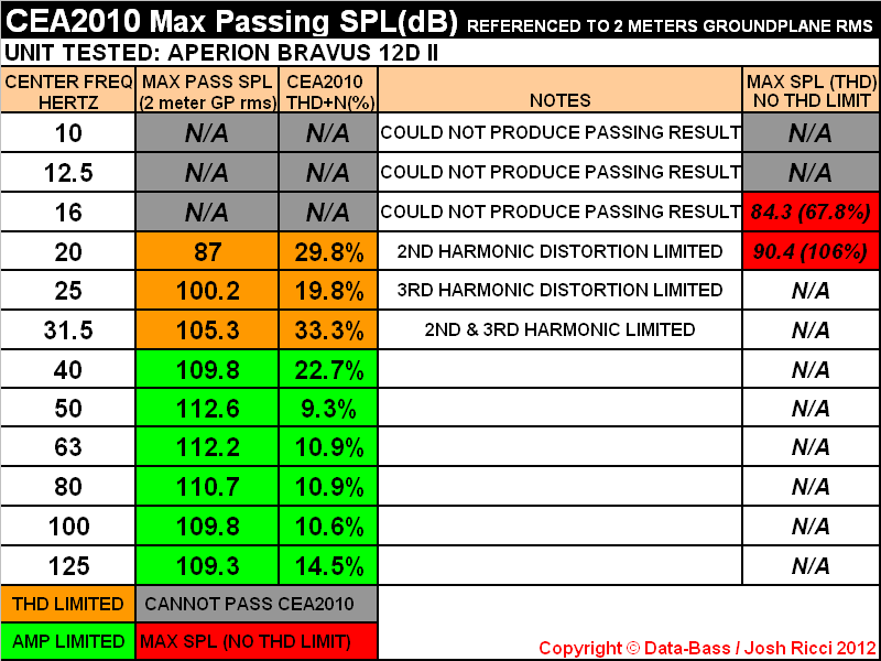

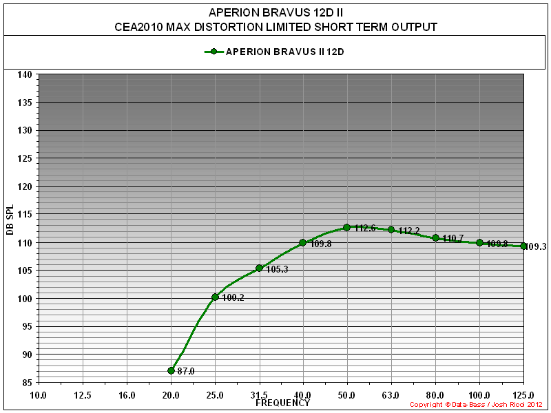

Aperion Bravus II 12D: CEA2010 2 Meter Groundplane RMS Results
Aperion Bravus II 12D: CEA2010 2 Meter Groundplane RMS Graph
CEA2010 Results
The CEA2010 burst testing results for the Aperion 12D indicate that while it isn’t a sub bass Goliath it has surprisingly potent output over much of its range. At 20Hz the 12D could only muster 87dB while passing and just over 90dB if distortion is ignored. This is obviously below the tuning of the system. At 25Hz the 12D grunts out just over 100dB with acceptable distortion which is impressive for a subwoofer the size of this one. At 31.5Hz the 12D recorded 105.3dB and from 40Hz through 125Hz the output approaches 110dB or more. A maximum figure of 112.6dB was recorded at 50Hz. That’s a lot of gumption from a 15.5” cube and partly explains why it did so well in both the music and movie portions of the listening tests.

well and especially so with music. Sonically the 12D performs. Aesthetically in
my opinion it is hands down the best looking subwoofer I have seen for under
$1,000. The gloss piano black finish is beautiful, the dual recessed grilles give a
symmetric appearance and the Aperion badging is classy. If there were a rating for spousal acceptance the
