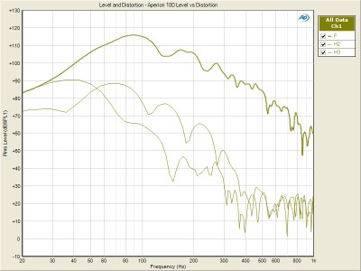

Aperion Bravus 10D  Frequency Response & THD  (in-room 1 meter ground-plane)
The Aperion 10D preamp distorted if the input signal exceeded 1Vrms.  We've seen this on other subs utilizing BASH amplifiers and hoped by now they (BASH) would have addressed this as it's not abnormal for LFE tracks to approach 2Vrms at digital fullscale.  I backed down the input level to 500Vrms for the cleanest possible signal and boosted the gain on the 10D for the frequency vs SPL sweeps.
Realize since these are in-room measurements, there can be anywhere between 2-6dB of room gain compared to an outdoor measurement.  I ran the Aperion sub up to its max SPL limit, which hit a whopping 115dB SPL at 1 meter at around 80Hz (no crossover engaged).  Bass response sharply fell off below 40Hz as expected given its diminutive cabinet size.
The 10D appears to have usable bass extension down to around 30Hz though don't expect much SPL at those frequencies.  Below 30Hz the output is dominated by 2nd harmonic distortion.  Trying to get this sub to play usable bass below 30Hz at meaningful SPL levels is like expecting Sarah Palin to actually be funny doing stand up comedy or Obama to grow balls and actually make good on his promises.

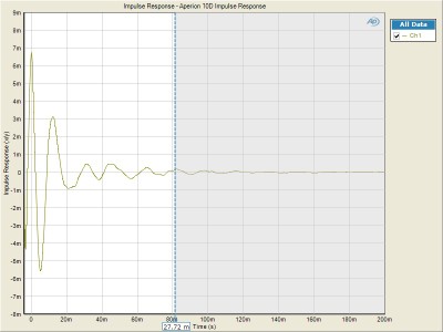

Aperion Bravus 10D Impulse Response (nearfield)
I placed the measurement microphone in the nearfield at the right woofer and measured the impulse response. The rather long settling time indicated to me that this subwoofer is underdamped or in this case ringing.  I suspect if Aperion ditched one of the woofers they would achieve a better low end frequency response, and impulse response while only sacrificing a few dB of efficiency and output above 50Hz.  In speaking with Aperion Audio engineering they pointed out two reasons they chose to employ dual woofers in this design:
  • the increased air moving capabilities (for max SPL but not for efficiency)
  • It gives us a second voice coil to handle the power needed after increasing the power requirements.
