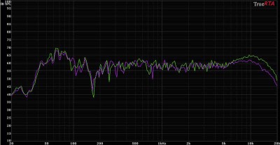

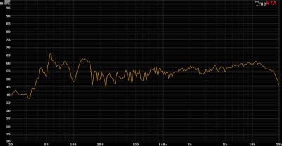

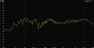

I measured the Aperion Audio Verus Grand Tower speakers in room to get an idea of their performance in the space. While I don't have access to an anechoic chamber or even a large driveway, some measurement is better than none. Fortunately, I have access to a Berhinger ECM8000 microphone professionally measured at Cross Spectrum Labs. They provided a correction file that can be used with TrueRTA to correct for any idiosyncrasies in individual microphones. Using the Berhinger, an M-Audio Fast Track Pro preamp, and a Sherbourn Model 2/75B amp, I measured the Verus Grand Tower at one meter on axis and 30 degrees off.
Green - 1 meter on, Purple - 1 meter 30 degrees off (1/24 resolution)
Note - this is NOT a one watt measurement
As you can see, in my room, the response was a little hot on the top end on axis but smoothed out a bit as you got off axis. You can also clearly see how linear it is even in-room. The response is very flat down to 40Hz where it starts to drop off. The top end rolls off after 15kHz where human hearing is weakest anyhow and is due, at least partially, to the measurement mic being in close proximity to the tweeter phase plug. If you are wondering why I might be so impressed with a speaker, the above graph should be proof positive. After I completed my in room measurements I asked Aperion to send me their in house measurements. I was astonished to find just how similar the two graphs were. The other physical difference (other than the room) between the min and Aperion's measurements is that Aperion measured with the grilles on and I did them with the grilles off.

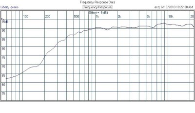

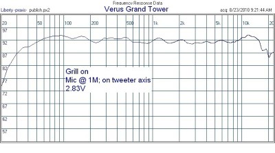

Aperion Verus Grand Tower Frequency Response Measurement from Manufacturer
These graphs look eerily similar. As an Audioholic, I've always been taught that in room measurements are inherently flawed - and they are at frequencies below the transition band (300Hz) where they become room dominant. But you can see that, when compared to the Aperion in house measurement, our in room one tracks pretty closely.  The bass response is a bit skewed by the room and there are a few suckouts but the overall shape is nearly identical from the slightly increased energy on the top and bottom end and the drop off around 15kHz.

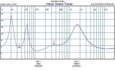

Aperion Verus Grand Tower Impedance Measurement
The Verus Tower appears to be tuned in the 35Hz region as indicated by the saddle point between the two impedance maximas.  Towards DC, the system impedance measures 6 ohms as Aperion rates this speaker but be mindful of the 4 ohm dip in the 80-150Hz region when mating an amp with these speakers.  Feed them quality from an amp rated down to 4 ohms and you will be rewarded.  These speakers deserve quality amplification.

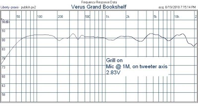

 Like the Verus Grand Towers, the Bookshelf speaker measured very well in room. We see the same dropoff  around 17Hz and a near ruler flat response down to 55Hz. This is phenomenal performance for a bookshelf speaker only 14 pounds and just over a foot tall. While you are paying a premium for the added bass and output of the Towers, the Verus Grand Bookshelves should perform very well in smaller rooms especially paired with a sub.
Again I asked Aperion to send me their in house measurements and again I was astonished to find just how similar the two graphs were. The other physical difference (other than the room) between the two measurements is that Aperion measured with the grilles on and I did them with the grilles off.
Aperion Verus Grand Bookshelf Measurement from Manufacturer
Again these graphs look eerily similar. You can see that, when compared to the Aperion in house measurement, our in room one tracks pretty closely. The bass response is a mess because of the room but the overall shape is nearly identical from the slightly increased energy on the top and bottom end and the drop off around 15kHz.

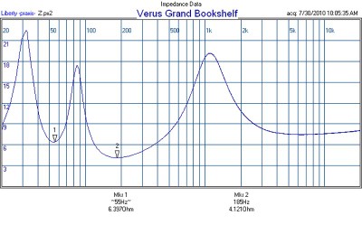

Aperion Verus Bookshelf Impedance Measurement
The Aperion Verus Bookshelf speaker appears to be tuned in the 55Hz region as indicated by the saddle point between the two impedance maximas.  Towards DC, the system impedance measures above 8 ohms though Aperion rates these speaker at 6 ohms.  Be mindful of the 4 ohm dip in the 100-150Hz region when mating an amp with these speakers.  Feed them quality from an amp rated down to 4 ohms and you will be rewarded.  These speakers deserve quality amplification, even if being crossed over above 80Hz.

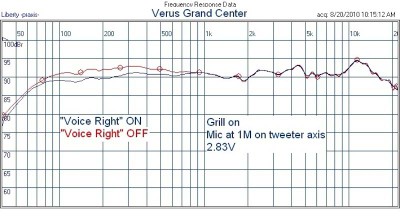

The measurements of the Aperion Audio Verus Grand Center was just as impressive as the rest of the lot.
Verus Grand Center 1 Meter On Axis (1/24 resolution)
Boundary Switch Set to "On Stand"
Note - this is NOT a one watt /meter sensitivity measurement
If you are starting to think you're seeing double, Aperion has really excelled at maintaining very uniform frequency responses across all these speakers. Again, the Center shows a super flat response down to nearly 40Hz with a few room related dips. The top end starts to drop out near 15kHz which is consistent with all of the measurements. I've honestly not seen any set of speakers that measured this flat in room. These speakers exhibit incredible linearity which can be seen even in real in-room measurements.  In contrast, we've measured speakers from companies touting their anechoic linear response that didn't even come close to measuring this linear.
Aperion Verus Grand Center Measurement from Manufacturer
The Aperion in-house measurement again looks similar. The bass response of my graph is a bit skewed by the room and there are a few suckouts but the overall shape is nearly identical from the slightly increased energy on the top end and the drop off around 15kHz. The "Voice Right" refers to the switch in the back. This bumps down the bass response for in cabinet placement.

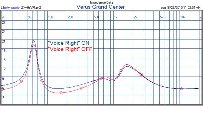

Aperion Verus Center Impedance Measurement
The Aperion Verus center speaker exhibits a very linear impedance load despite its complex array of drivers and crossover topology.  Aperion rates it at 6 ohms but be mindful of the 4 ohm dip (Voice Off) in the 100-200Hz region when mating an amp with these speakers.  Feed them quality from an amp rated down to 4 ohms and you will be rewarded.  This center channel deserve quality amplification, even if being crossed over above 80Hz.

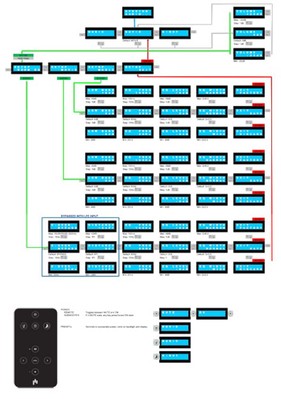

There were a few complaints, however. In order to figure out how to use the EQ or even access the menus, we had to go online. None of that information was included with our test sample. There is a huge flowchart on the Aperion website which makes everything fairly easy to understand and we hope they include it with the consumer samples. The biggest complaint we had was there was no way to lock out the front controls. While we liked have easy access to the controls from the front panel or the remote, our kids loved to adjust the volume of the sub. Too many nights were spent wondering why we weren't getting any bass before we learned what they were doing. There is a Music,  Movie, and Night modes (no Game as indicated on the Aperion website) but no User mode. In Aperion's defense, the Movie and Music modes are completely configurable so it isn't a problem but we'd prefer something like EQ defeat mode where you know there is no processing going on no matter what random buttons your kids press.
 The parametric EQ is a single band which can be set differently for each of the modes. While this is useful for power users, casual users may find the EQ too advanced for them. If Aperion had opted for a User mode, they could have had Movie and Music preset (though adjustable) and the User mode defaulted to flat. This would have been the best of all worlds with causal users having something to experiment with (currently, Music and Movie default to EQ off) while still giving power users something to play with.
While you could set up the EQ, volume, and distance from the menu, what was missing was phase. Even the most basic subs have a phase switch. While we find a switch to be mostly useless, power users (you know, the ones that will play with a parametric EQ) use a variable phase control to dial in the performance of a sub. This was a noticeable omission from the menu. In lieu, they include distance which can be used in a similar way (though it takes a really informed consumer to know that).

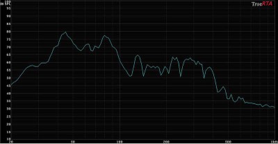

I was not as impressed with the in room performance of the Bravus II 12D as I was the Verus Grand line. I don't know if Aperion has a Verus Grand sub in the works, but they should. While the Bravus managed to add a much needed tactility to the bass, it didn't seem to add a ton of extension. While the Bravus II is rated down to 20Hz, I found it dropping off considerably higher than that - closer to the low 30's. While this is respectable performance, it isn't 20Hz.
There were times that the sub blended very well with the Verus Grand speakers. In particular, during certain CDs I could turn the sub on and off and literally only "feel" the difference. Other times, however, it seemed the sub couldn't help but stand out. During playback of movies like Finding Nemo, The Incredibles, and other kid favorites that have ultra low end (or movies that both entertain the kids while letting Dad try to kill the sub), the Bravus II 12D did an admirable job of moving the couch. It didn't quite hold up to my reference Axiom EP500 but it is smaller and costs two thirds the price. For that, you could get two and really even out the bass response.
I measured, like the other speakers, the Bravus II 12D in room but the graph looked pretty rough, mostly due to room modes. I used a one meter groundplane measurement. While I don't have access to an anechoic chamber or even a large driveway, some measurement is better than none. Fortunately, I have access to a Berhinger ECM8000 microphone professionally measured at Cross Spectrum Labs (http://www.cross-spectrum.com/). They provided a correction file that can be used with TrueRTA to correct for any idiosyncrasies in individual microphones. Using the Berhinger, an M-Audio Fast Track Pro preamp, and the 600 watt BASH amp in the sub, I measured the Bravus II 12D at one meter groundplane.
Aperion Bravus II 12D Sub, Groundplane In Room (1/24 Resolution)

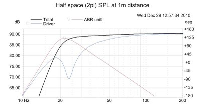

While the output above 100Hz decreases significantly, I don't really care since you shouldn't be crossing the sub over any higher than that anyhow. Aside from some room modes, the graph tells a decent story. From about 90 Hz down to 40Hz there is a pretty flat response. After that, it drops off precariously. Unfortunately, I wasn't able to take the sub outside and do a proper measurement so this very well could be a bass suckout at those lowest regions. Unfortunately, Aperion could only provide me with a modeled response rather than an actual measurement (which I've included below). I would have liked to have seen how my in room measurement held up to an actual one provided by the manufacturer since all the others were so similar.
Bravus II 12D Modeled Response
