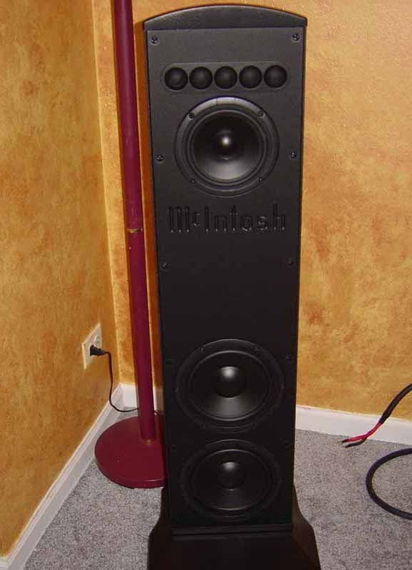

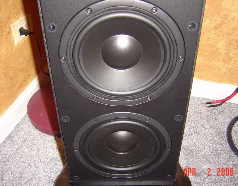

WoofersThe XLS340's are a moderately tall, thin column array of drivers adaptable to floor or wall mounting with an optional in-wall mounting kit also available.  The cabinets are made of extruded aluminum and are equipped with mountings for screws to attach, including floor bases or wall mounting brackets.  The cabinets also are internally braced to further increase cabinet rigidity.  Included with the bases are both flat caster and cone floor supports allowing for placement in either hard floored or carpeted rooms.  With the base installed, the total weight of each speaker is a substantial 69 pounds.  Both the base and the cap appear to be constructed of MDF and covered with what the users manual describes as a "thermal vacuum formed durable surface in a textured black finish"; sounds like a rather elaborate euphemism for vinyl to me.
Tweeters
PostsUse of extruded aluminum cabinets has several advantages.  The cabinets are a thin profile design with the intent of wall mounting the XLS340's alongside flat panel TV displays as an option.  Using aluminum with this constraint allows for thinner cabinet walls to maximize internal cabinet volume for bass response, and yet still be stiff enough to minimize cabinet vibration modes.  Also, in consideration of placement near a TV, all of the drivers have shielded motor structures for use near all TV types.

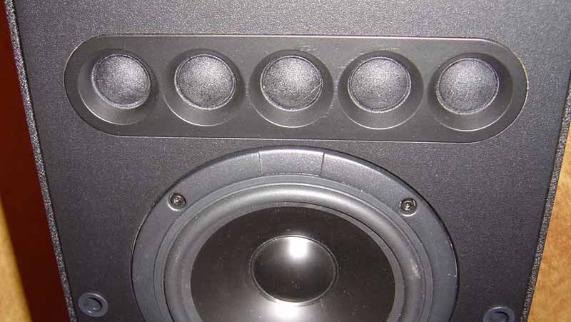

Enclosures are a sealed design consisting of a five tweeter array and a 6 ½" midrange driver mounted at the top of the cabinet below the tweeter array, and dual 8" woofers mounted towards the bottom.  The tweeter array is a soft dome textile design, while the midrange and bass drivers appear to be polypropylene cones, but the product documentation does not specify.  McIntosh uses the same midrange driver and tweeter array for all the speakers in the XLS line.  The goal here is to voice match all the speakers for flexibility when selecting between models for use in multi channel applications.
CrossoverMcIntosh states that multiple drivers were used to increase the power handling capabilities of the speakers.  Precision crossovers are said to provide even frequency response with +-2dB specified in the product literature.  The crossover network also features an automatic, solid state protection device in the event of an over load.
The tweeters used in the XLS340's are described as a Bessel Function Tweeter Array that McIntosh says allows each driver in the array to operate at lower individual power but still perform as a point source with broad dispersion characteristics with lower distortion.  On the back of the cabinet, above the speaker terminals, is a pair of jumpers to optimize the phase relationship of the array for left, center, and right channel applications; presumably this is how the Bessel function is utilized as there is little by way of explanation in the product documentation.  Also, the array is said to be insensitive to horizontal or vertical alignment allowing placement flexibility without compromising sound quality.

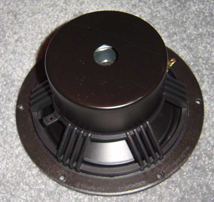

WooferAnother design feature cited by McIntosh is the patented LD/HP motor structure used for midrange and bass drivers: U.S. patent number 5,151,943 : "Low Distortion Dynamic Loudspeaker.  The voice coil pole has aluminum shorting rings at each end that are said to extend the linear operating range of the magnetic field which increases the linear excursion capabilities of the drivers, reducing distortion by 10dB.  McIntosh also points out the added benefit of increased heat dissipation in the design that in turn, increases the power handling capabilities of the drivers.  It is interesting to note, I could not find any information on McIntosh's web site that could lead me to the actual patent, but I did find it on the site of Roger Russell, former Director of Acoustic Research at McIntosh Laboratory, on a page for the vintage XR250 speaker system , the product for which the patent was originally applied.  It is also interesting to note that this web site reveals the considerable history of the products and personnel who have made McIntosh what it is today, little of which is available on the company site.

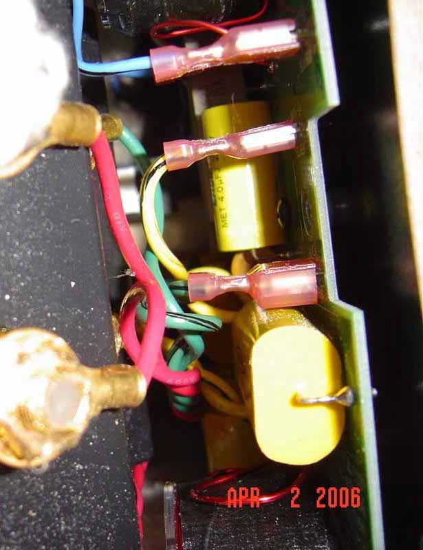

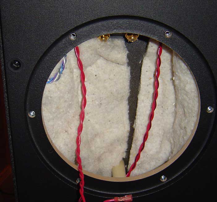

InternalsInside, the cabinets are filled with a treated cotton damping material on all sides.  The crossover network is mounted on the inside face of the MDF baffle between the midrange and woofers.  Drivers feature cast baskets and magnet covers with 18 gage internal wiring.
The cabinets are internally braced using wooden dowels attached at midpoint of the front baffle coupled to the back of the aluminum enclosures at several locations.

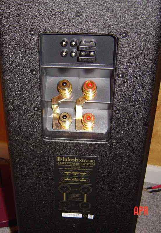

The XLS340's arrived by freight carrier in four boxes strapped to a wooden pallet and wrapped in plastic.  The towers were in the two larger boxes and the mounting hardware and bases for floor use were in the smaller boxes.  Some assembly is required.  There are some foibles in the product documentation that I noted during assembly and while writing the review.
Attachment of the cabinet to the base involves the use of an unmentioned 7/16" socket wrench, only determined by trial and error, to tighten the supplied machine bolts that make the connection.  While installing the base, do not follow the recommendation of placing this 69 lb speaker on top of the empty box.  As a structural engineer, I cannot recommend using cardboard for support: if the side walls do not crush or buckle, or the box flaps do not cave in, eccentric placement of the speaker on the lightweight box may cause it to overturn.  Find another flat, sturdy surface to use and put down some sort of blanket, cloth, or use the packing plastic to protect both the finish of the speaker and of the support surface.

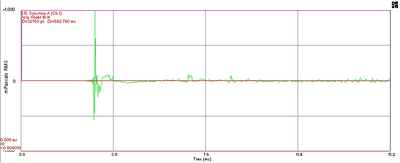

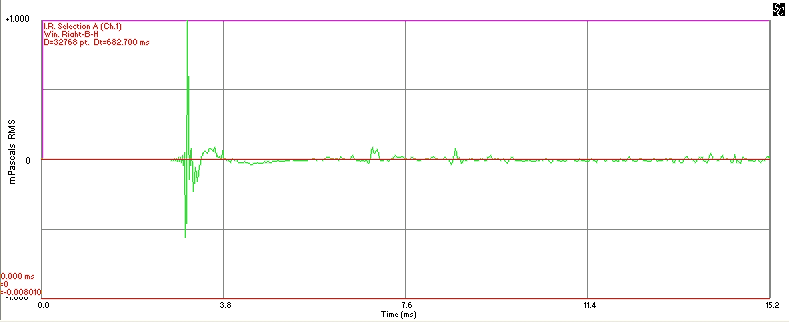

Impulse response of unit 1307
Figure 1: Impule response of unit 1307.
The first figure is the normalized impulse response captured from unit 1307.  A theoretical impulse response should appear as a single pulse up from zero and back for a single driver.  This is a composite response for a three-way speaker system, and while the multiple drivers each have their own peak, a speaker with well damped behavior should have its dynamic response die out with few additional oscillations.

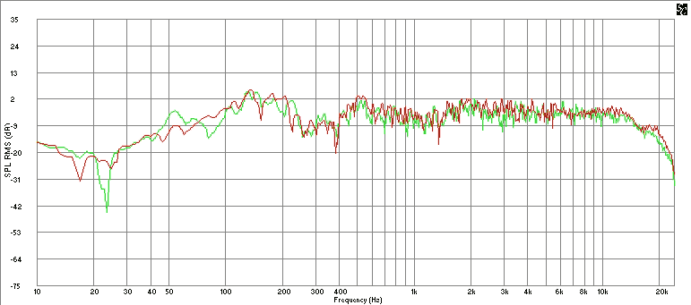

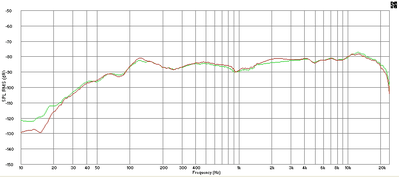

Frequency response of unit 1307
Figure 2: Freqeuency response of unit 1307 on axis and 30 degrees of axis.
The second figure is of the frequency response for 1307 for on axis (green trace) and 30 degrees off axis (red trace).  Initial lobbing of the response begins between 1000 and 2000 Hz, near the crossover frequency for the tweeter array.

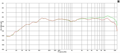

Comparison of units 1307 and 1308
Figure 3: Comparison of units 1307 and 1308.
I also compared frequency response for the two units, 1307 (green trace) and 1308 (red trace), shown in the third figure.  Response variations between the two units are typically within +-2 dB over the quoted frequency response except for a bump centered near 2300 Hz in the response of 1308.

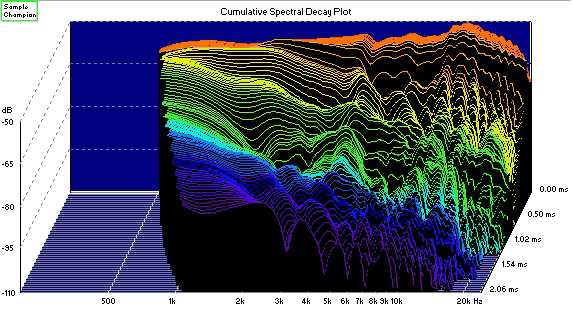

Cumulative spectral decay of unit 1307.
Figure 4: Cumulative spectral decay of unit 1307.
The next figure shows the cumulative spectral decay based on the impulse response shown in figure 1 windowed over 4 milliseconds for quasianechoic response.  The plot shows decay over a 60 dB range for frequencies in the midrange and treble regions.

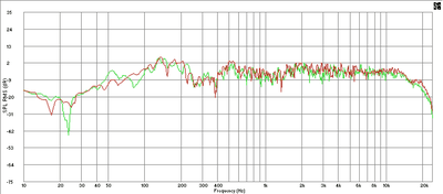

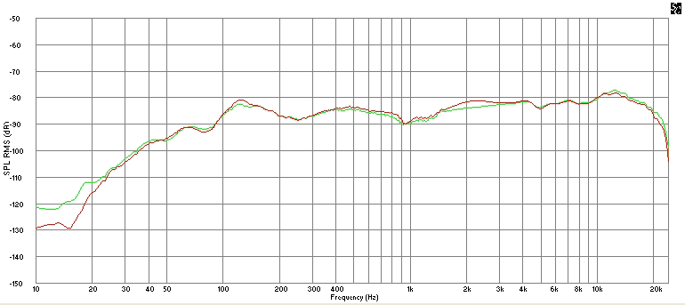

In room response of units 1307 and 1308
Figure 5: In room response of units 1307 and 1308.
The final plot is of in room response.  Unit 1307 (green trace) was measured from the left stereo position while 1308 (red trace) was measured for the right stereo position.  Both speakers were measured with their phase response jumpers adjusted to the corresponding left and right positions.
