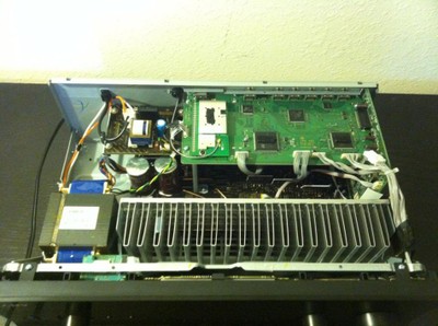

Build Quality
Sony’s marketing material touts that the STR-DN1030 is built with “audiophile” parts, including custom capacitors, a “powerful” amp board, and upgraded transformer. Rather than take their word for it, I opened up the receiver to take a closer look. I found that it was, well, unsurprising. This receiver is built about on par for a $400-$500 unit. The caps and transformer are good size for its class, but nothing to write home about. Although they claim 145wpc x 7, that would seem to be (as you'd expect) in line with FTC specs and not an all-channels-driven number.
amplifier
Sony STR-DN1030 with top panel removed
One of the main reasons I was excited the get the STR-DN1030 in for review was its feature list. It is the first $500 receiver to have built-in WiFi and Bluetooth. Of course, other companies have offered Bluetooth dongles for a long time, and WiFi can be added to any receiver that has an Ethernet jack. However, the fact that Sony put both technologies into a $500 receiver when almost no one else is even putting them in receivers that cost twice as much, is quite impressive. Additionally, the STR-DN1030 has built-in HDMI up conversion from composite and component sources and comes with an auto setup mic. It also supports up to a 7.2 system, 3D, Dolby Pro Logic IIz, and HDMI standby pass-through. The only features that are notably missing are 4K support and powered zone 2 outputs. The lack of 4K support doesn’t bother me because anyone who can afford a 4K display should not be buying a $500 receiver. It would have been nice to have powered zone 2 outputs, but it is understandable that Sony had to cut something to keep the receiver affordable. When compared to other similarly priced receivers on the market, nothing else comes close to having as many useful features. Sure, some receivers have more HDMI inputs, dual HDMI outputs, or 4K support, but the real question is, will those features be used by consumers?
