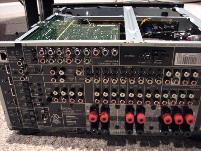

Back Panel View of the Pioneer SC-07
The back panel of the SC-07 is a bit crowded like all other receivers in this price range. There are seven speaker connections where two of them can either be used as Speaker B, Surround Backs, Zone2 or Biamp depending on how you assign them in the OSD. There are 4 HDMI inputs and 2 outputs, 3 component inputs and 2 outputs (1 for Zone2), 4 TOSlink ins / 2 outs, and 3 coax inputs. The power cord is not detachable which is disappointing at this price, and there are no provisions for switched or unswitched outlets.
Choosing the Speaker Impedance?
Um, well not really. In fact, this is the first UL rated receiver that has no impedance markings on the back panel or the user manual. Pioneer gives zilch as far as recommending a minimum impedance speaker to use with this receiver sans the small blip on page 64 of the user manual about recommending 6 ohm yo 16 ohm speakers when using the Speaker B amp configuration. Instead of a silk screen with impedance markings, my unit had a removable thin film plastic faceplate over the speaker terminals. I have no idea what that was for. As far as I know, Pioneer has no issue connecting up a fork on the outputs, but I wouldn't recommend it.

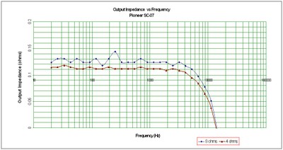

Amplifier Output Impedance & Damping Factor
Pioneer SC-07 Amplifier Output Impedance
Typically Class D amps have higher output impedance due to the inductors of the reconstruction filters after the output stage. The ICE module did a great job keeping that in check with a good amount of post filter feedback. The SC-07 maintained a uniform output impedance under 150 mohms driving 8- or 4-ohm loads, which should allow for more consistency in sound quality driving a variety of different types of loudspeakers. The sharp reduction in output impedance above 10kHz is a result of increased power response caused by overshoot in the output inductor coils when driving a resistive load.

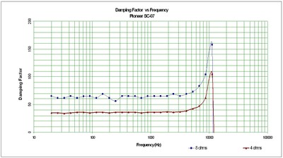

Pioneer SC-07 Amplifier Damping Factor under various loading conditions
The amplifier damping factor is about what I expected based on the measured output impedance. It is uniformly good across the entire audio frequency range at around the 60 mark (50 is a minimum we like to see in all amplifiers of uncompromising design) when driving an 8-ohm loads. Into 4-ohm loads the Damping factor is roughly 1/2 the 8-ohm value as expected.

Output Impedance | ![]() ![]() ![]() ![]() |
