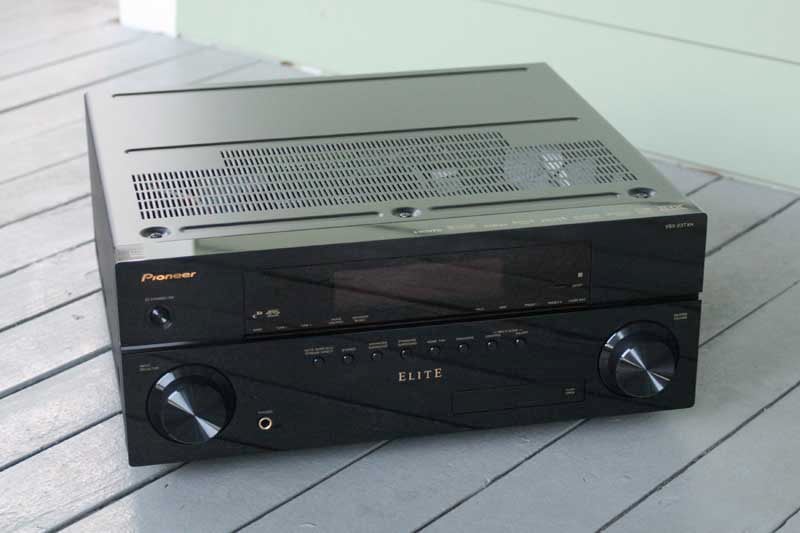

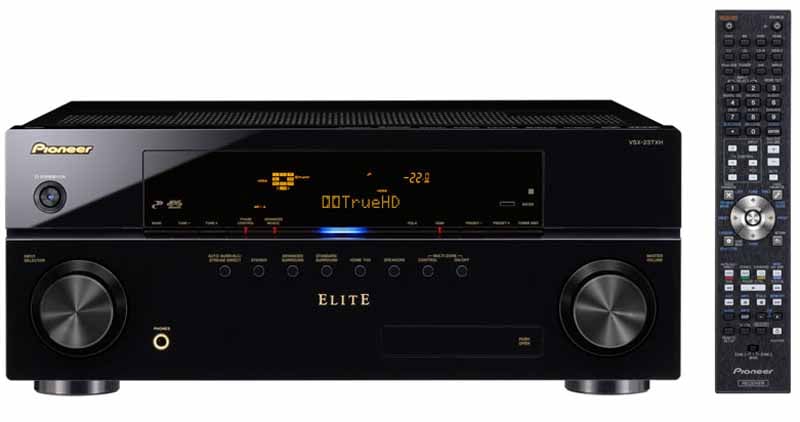

Pioneer makes a very beautiful A/V
receiver. The front sports a piano gloss black finish and there are
blue accent lights below the display panel and which indicate
powered-on status. Thankfully, and unlike most of their competition,
Pioneer also places the dozen annoying requisite technology logos on
the top of the receiver instead of decorating the front like a
tattooed prison inmate. Controls are pretty standard on the front
with the input selection knob is on the left and the rugged-feeling
volume control on the right. Unlike the last Pioneer receiver I
reviewed, the Master Volume increases in 0.5dB increments, suitable
for even the most discerning users.

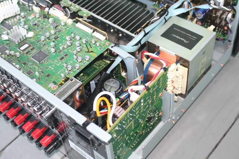

We popped open the VSX-23TXH and noted
the large EI Core transformer and dual 15,000 uF capacitors. The
power supply is ample enough to take it to its rated specs and power
all but the most inefficient of speakers to near-perfection. Pioneer
continues to use the flimsy, but sufficient thin aluminum heatsinks
that are positioned across the central area of the receiver. The
manufacturer did an excellent job of packing everything into a
relatively tight space, and we could see that the front display panel
and video features were well separated and shielded from the power
supply.

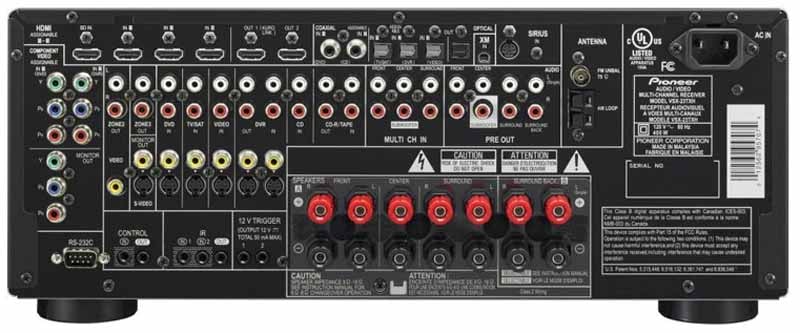

I like the layout of this receiver. It lends itself to easy connectivity and each of the inputs can be re-assigned as needed to facilitate your particular system. 4 HDMI inputs (1 on the front) make this an extremely flexible system, and one that will work well with any room that has a remotely located projector or television that has a single HDMI cable running to it. Of course the bonus is that, since it has another HDMI output, you could also simultaneously feed a duplicate video signal to another room. I use this feature in my own home for SuperBowl parties and for testing displays in another room while feeding both from my single equipment rack. Keep in mind that you must disable Kuro Link in order to assign HDMI.

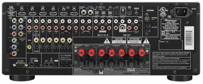

Back Panel of the Pioneer VSX-23TXH 7.1 Home Theater Receiver

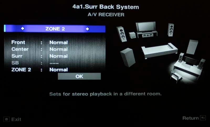

Like the VSX-94TXH before it, the VSX-23TXH lacks dedicated Zone 2 speaker connections. Since you can assign the amplifiers from Surround Back to B-speakers, Bi-amping the mains, Surround Back or Zone 2, you'll actually need to pick one use and stick to it. To switch between Zone 2 and Surround Back, for example, would entail switching cables. We've seen other manufacturers handle this better with additional dedicated 5-way binding posts. There are dedicated preamp outputs for Zone 2 as well as Zone 3, so while you can't use Zone2 without disabling your Surround Back channels, Zone 3 gives you the opportunity to do so (with an external amplifier). And check out the new detachable power cord! It took Pioneer a while to get this right but we're glad they finally came around.
The back of the VSX-23TXH sports both 7.1 preamplifier outputs as well as 5.1 multi-channel inputs, so it can support any future analogue technologies – at least, ones that don't involve adding more speakers... Oh wait, Dolby is already adding Height channels and Audyssey is pushing 10.2. There goes the 7.1 neighborhood!

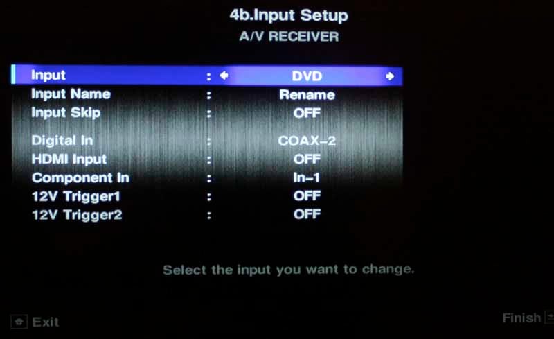

The VSX-23TXH has a new user interface
that is kind of a hybrid GUI-text interface. There are some updated
graphics which lift it out of the text-only look of days past, but
they don't compare to the advancements made by other manufacturers.
Overall it's an improvement and we want to at least thank Pioneer for
turning off the ALL CAPS mode for its menu system. The last time we
documented its Setup Menu we were accused of SHOUTING... but no
longer. The Home menu is now comprised of 4 items, with the first
three dedicated to MCACC functions and memory settings. Pioneer
really wants users to use its MCACC system. The last item is a
catch-all for manual settings, which houses all of the "self-help"
speaker settings as well as the input layout and Zone 2/3
configurations.

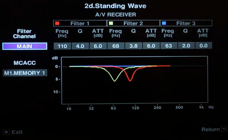

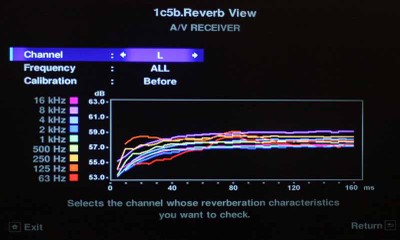

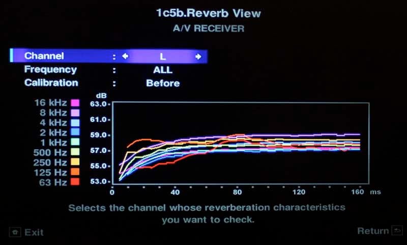

The Auto MCACC system has been adjusted to allow for easier customization of what the system will affect. The GUI shows exactly which aspects of the system will be adjusted by the system and includes the ability to calibrate Speaker Setting, Channel Level, Speaker Distance, and EQ Pro & S-Wave (Standing Wave) - or, more importantly, nearly any combination of the four. You can then store the resulting settings into one of 6 available memory positions, allowing for several configurations for watching movies vs music or just to experiment with. A (perhaps unnecessary) Full Auto MCACC removes all of the options and merely allows you to indicate the use of your Surround Back speakers.
The Manual MCACC system has close to the same menu options as before, however the EQ Professional sub-menu is considerably more sophisticated in its ability to show before and after effects of in its Reverb View. In this section you can view each channel's individual reverb characteristics, separate each channel into its separate frequencies from 63Hz to 16kHz (1/3-octave increments), or view all frequencies at once in a color line chart.
Check out the 3-band standing wave filter
Overall, the new Pioneer menu system is
functional and a big step up from the previous Setup iteration. It lacks
polish and their structure for making adjustments is a bit unusual
(like dedicating an entire submenu to Language Selection,
while ganging a ton of setting under the all-encompassing but vague
Other Setup category. There is also a glaring omission in my
opinion, and that is the ability to configure different input volume
levels for each source. Without this feature, your DVD player might
be 10dB hotter than your cableTV set-top box (as it was in my case)
making it sound twice as loud. While some sources have an output
level control, many do not. The other thing I disliked was that when
entering the menu system, all audio and video output ceased. This was
not only annoying, but it broke the HDMI connection, causing my
laptop to revert back to its own screen when I was streaming media to
a Vizio VF551XVT LCD display.

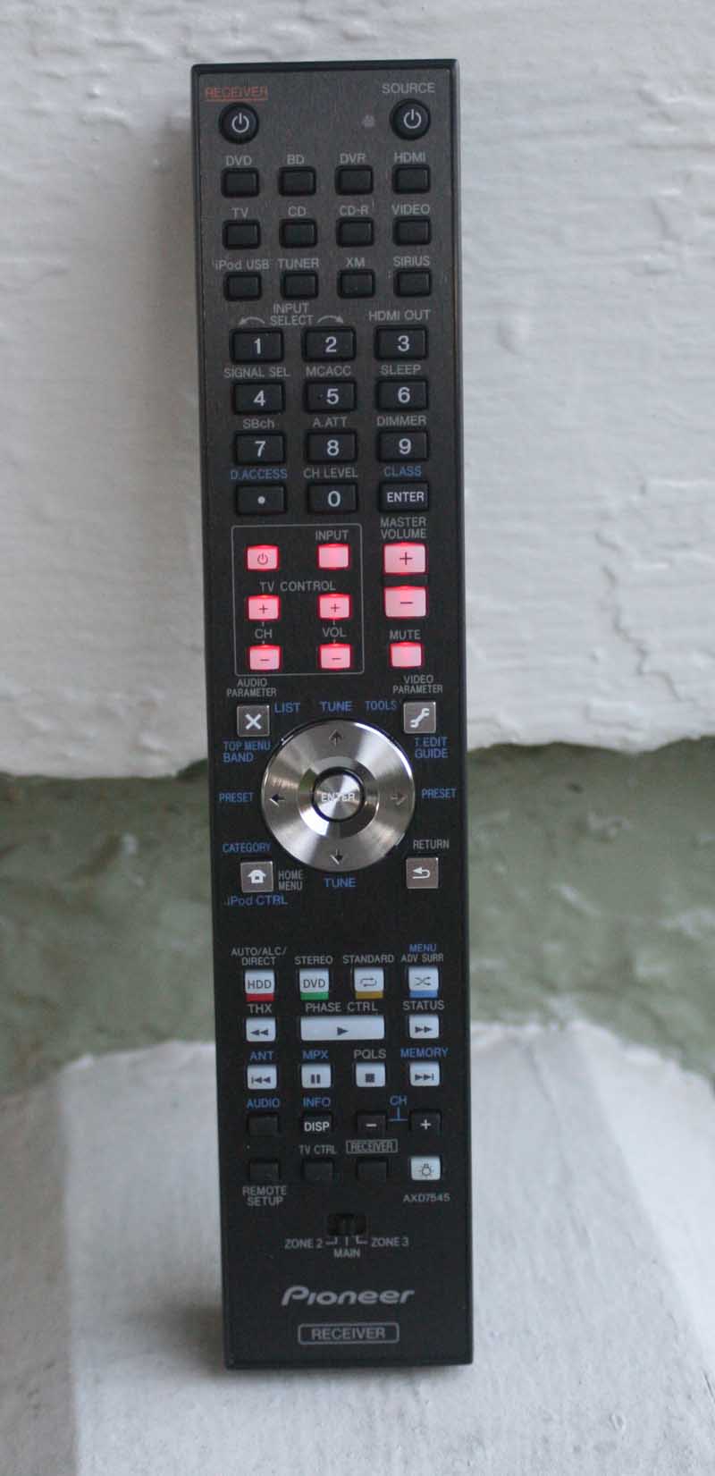

The AXD7545 is a partially-backlit
remote. There is an unobtrusive 'light' button at the bottom that
illuminates the TV Control section, master Volume and Mute controls.
Other than that, you're on your own when using this remote in a dimly
lit room. The layout and controls adhere to a more standard
organization that I've seen a lot with more and more products. The
less-used number keypad and input sources are at top, with the TV and
menu controls in the middle, navigation below that, and specialized
functions at the very bottom. The remote is very usable and its main
drawback is that, without backlighting, the plethora of square and
rectangular buttons are far too similar to provide any real tactile
clues for use in the dark.

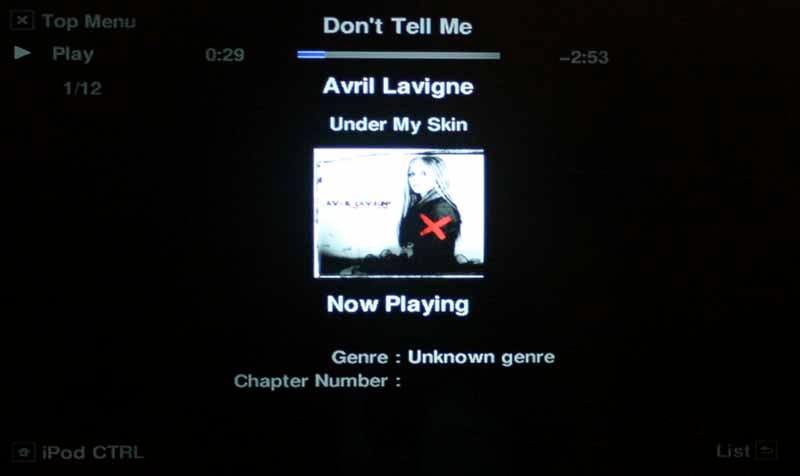

Being able to connect and control an
iPod or iPhone for free is a nice bonus. During play the television
will (optionally, of course) show album art, song and artist info as
well as the track time. The front panel of the VSX-23TXH shows the
song title. If it's too long it will scroll across the display
horizontally. Navigation is rather slow, taking quite a long time to
scroll through a player that has tons of artists. Pioneer either
needs to speed up communication in this area or present a Page
Up/Down control to users so they can jump around more quickly. I
thought that perhaps the number keys would advance me to a specific
alphabet position, but as there are no alphanumeric designations on
the remote, this turned out to not be the case. While tuned to the
iPod input I found that the Setup Menu was not accessible until I
flipped to a different input. Pressing the Home button on the remote
control switches control from the remote control to the iPod and
back.
