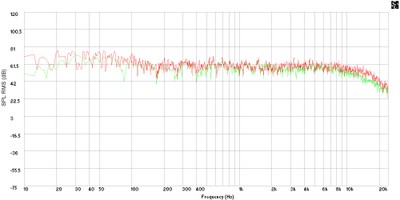

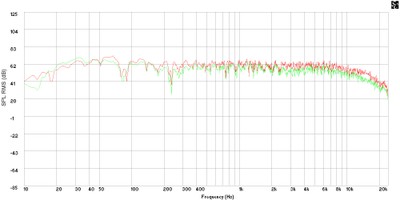

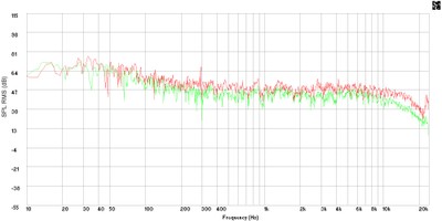

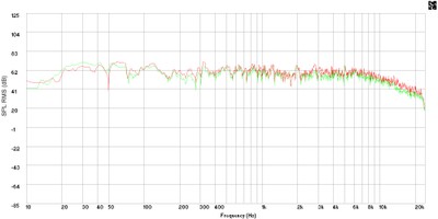

In room acoustic testing of the TX-SR805 was performed both with and without Audyssey MultiEQ XT engaged for comparison. Audyssey acoustic calibration was generated using eight microphone measurements located at both primary and secondary listening positions as well as throughout the listening area.
Test measurements were then performed at the primary and secondary listening positions for both the left and right main channels at an SPL of 80dB at each listening position. The primary listening position is located approximately centered on the front L/C/R channels and at the approximate center of all calibration settings for time delay. The secondary measurement position is located to the left and forward of the primary position near the room boundary.
Comparisons of the in room frequency response results without and with Audyssey engaged are presented in two forms. First, a high frequency resolution overlay plot in logarithmic scale of both conditions is provided. The second form is a side by side comparison of frequency response without and with Audyssey engaged plotted at 1/3 octave bands. The 1/3 octave band plots consider the commonly accepted limits of human hearing to differentiate relative frequency variation and thus are more representative of the changes one might actually hear.
Figure 1: Overlay of front left channel at primary position with/without Audyssey
Figure 2: Overlay of front left channel at secondary position with/without Audyssey
Figure 3: Overlay of front right channel at primary position with/without Audyssey
Figure 4: Overlay of front right channel at secondary position with/without Audyssey
Figures 1 through 4 show the high resolution plots for each measurement position and speaker. Typically, all the plots show correction in the high frequency range where room absorption pulled the curve below the Audyssey calibration curve. We also see a general flattening out of response through the midrange and into the bass regions. The most dramatic change is in the left channel at the secondary position, also at the left of the room, where Audyssey made attempt to adjust the curve for room boundary gain in the bass region and balance it with the midrange and treble. It is here that we also see the greatest treble roll off correction.
