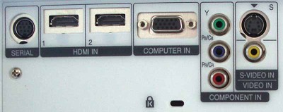

Connections
As we mentioned, the new PT-AX200U has the identical inputs as its predecessor, save for an additional HDMI input. This HDMI input has its own associated memory so you can truly store picture and calibration settings for it without interfering with the other source component. The AC plug is still proprietary (grrr) and there is no IR input or trigger output, meaning that while this projector has TS-232C control capabilities, it's not completely installer-friendly depending upon the particular situation and requirements.
