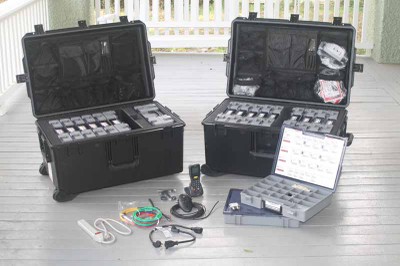

Solid. That was my first impression of the CITS system as it arrived at my doorstep. The cases are built like little tanks. They are easy to maneuver, thanks to the roller wheels and ample handles which surround the case, but they feel as if you could throw them off a 2-story building onto concrete and they'd survive with only a few scratches. (Oh yeah, I really wanted to try that, but I wasn't willing to risk someone else's property just to satisfy my curiosity.) You can't really get a feel for how robust the kits are until you wheel them around and open them up.
CITS-case-open3.jpgEach kit locks up tight with 5 latches which have a center release button and flip open easily to reveal the contents of each case. The two cases are filled with a total of 17 organizers. Ours included an extra double-width organizer which was empty, while the typical standard system carries a single layer empty organizer. Each organizer holds various parts, the contents of which are summarized on the front with a custom sticker and also internally by barcode, part number, and photo. Each organizer's label also includes the name of the custom installer, so they won't easily get jumbled up or switched when multiple installers are on-site.
The first case contained 10 organizers and was broken down into: data cables, D-sub & fuses, electrical, infra-red & batteries, labeling tape & zip ties, port plates & inserts, signal distribution & splitters, test & repair, wire connectors & wall plates. The second contained: audio & phone solder terminations, bolts/lags & fasteners, screws & anchors, F/BNC/RCA ends & adapters, video cables, audio cables, and (for us) Planet Waves components. The Standard CITS typically comes with FConn compression connectors and not with the Planet Waves product. We've reviewed the Planet Waves products and found them to be incredibly easy to use.

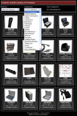

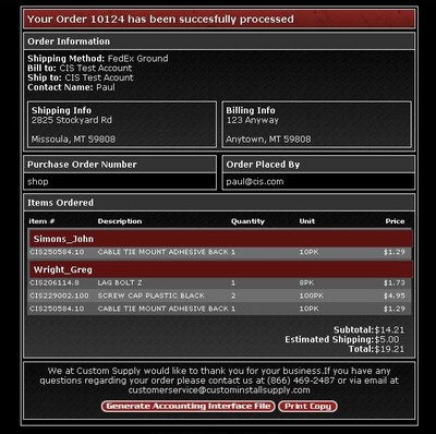

The final piece of the puzzle is what the CITS system is all about. Docking the scanner at your PC allows the system to upload all of the scanned inventory to the CIS website and automatically associate those scanned parts with the job/customer you specified before you began scanning items (you did remember to do that, right?). The CIS website has a utilitarian feel to it (mostly due to the red-on-black graphical design) but it seems to get the job done. While short on aesthetics and amenities, it shows the necessary information and allows easy export of the relevant purchase data to either QuickBooks or a standard .CSV file.
Reports can be viewed in any of several ways
Aside from auto-replenishing parts from a submitted installer scanner docking session, reordering parts can be done via search, part number or browsing categories.
The CITS system allows you to export invoices to QuickBooks and easily print hard copies.

I used this system on several surround sound installations with much success. While the Standard CITS kit didn't have everything I needed, that's not something likely to happen when a custom installer places their initial order. During actual use I found the kit to be extremely handy, though a tad on the large side. I went back and forth between my desire to have everything I needed and my need for smaller, more portable cases. In the end I realized that the system is flexible enough for me to order smaller cases if it was really that important to me. The thing that makes it so usable is the whole auto-replenishing aspect of the inventory scanning process. Each install was easy to manage and I received more than a few comments about how cool it was to have a complete installation kit at my disposal. Let's face it, pull up to a house with a couple of these and a van full of bulk cables and tools and you're going to be perceived in a whole new light by your clients.
