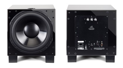

Design Overview
The Dynamo 1500X is a small sealed alignment utilizing a long throw 15” driver and an amplifier rated at 650 watts rms and 1300 watts short term. Other than the previously mentioned PBK system the 1500X does not employ a bunch of bells and whistles that some other subwoofers list as features but which may be of limited usefulness. The controls are simple and straight forward which I find refreshing. One unique feature that it does offer which I found to be rather interesting is an interchangeable foot system which allows the 1500X to be configured as either down firing or forward firing. The four feet are a molded black plastic that are L shaped and have a center screw which locks into the enclosure and a pair of pins which insert into the enclosure similar to how most grilles attach. There are 2 faces of the enclosure which have the mounting points for the feet, the face containing the driver and the amplifier panel. The feet can be screwed or unscrewed simply using a coin. The whole change takes less than 5 minutes. The 1500X comes configured for down firing which places the feet on the driver panel. In forward firing position the driver now fires horizontally and the amplifier is placed on the bottom. This is where all of the right angle connectors provided with the 1500X come into use as they will clear the floor easily. I like this option because there is little chance that your settings could be inadvertently changed since they would be under the subwoofer, however initially I had a concern about heat being trapped and building up in the amplifier, however after giving the 1500X some rather extreme workouts with various signal types the amp barely even got warm to the touch. The right angle connectors also help out with fitting the 1500X into tight places or up against walls. It would be nice if more manufacturers would provide a right angled power cord especially as this usually protrudes the furthest. After switching the feet a few times to see how this procedure worked I ended up leaving the 1500X in the down firing configuration for the rest of the time it was in my possession. The grille, which I test fitted on the subwoofer and then promptly put back in the packaging since I would be leaving the 1500X down firing, is constructed of molded plastic covered with the typical dark black grille fabric. To my eye the grille and plastic feet both failed to exude the same amount of quality as the rest of the subwoofer and components used. The grille felt very fragile and the feet also seemed like they could be broken without much force applied laterally. Now this probably won’t be an issue for most but on carpet you would not want to attempt to slide the 1500X on its feet as they could be seen to flex while doing so and I had visions of one cracking or becoming stuck in the threads. Otherwise the quality of finishing and components supplied with the 1500x was very good. The 1500X’s external dimensions measure just 18.3”x16.75”x17.6” in down firing configuration and 19.3”x16.75”x18” in front firing configuration so it shouldn’t be hard to fit into even tight spaces and won’t draw unneeded attention to itself.
The enclosure is available in only two finishes, the standard satin black finish of the review unit and a piano gloss black finish is available for a $300 upcharge. The standard finish on the review unit was well applied and heavy. I also noted that it seemed fairly durable as the review unit got a number of smudges which I found will wipe right off with a cloth and was also moved around a number of times. During transport to the outdoor test site it even knocked against a large metal ammo case in the back of the SUV due to an abrupt stop that was required and I thought for sure that there would be an ugly mark on the exterior, but once it was wiped with a bit of glass cleaner it left only a tiny little ding the size of a match head that could barely be seen up close. The 1500X is small with an unobtrusive and durable finish and it is well put together too. The 1500X looks good but at the end of the day it is still a basic black cube, so it didn’t exactly inflict me with pangs of longing to own it with its visual presentation.

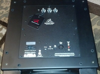

Once the driver was removed from the 1500X I could see that the amplifier was mounted inside of its own metal chassis which covered all of the internal components so I decided not to go to the trouble of removing the amplifier and then removing the covers over the amplifier. MartinLogan indicates that this is a 650 watt highly efficient Class D design and it includes a very basic set of controls with only gain, low pass and phase being user adjustable. The inputs are limited to a pair of RCA inputs and a single balanced XLR line which is nice. A trigger input and the input for the PBK system complete the connection scheme. This is plenty of control and connection options to blend the 1500X into the majority of systems. In use the amplifier certainly seemed to have plenty of power for the driver and even during the ground plane measurement session with pure test signals the amplifier barely got warm to the touch.
MartinLogan Dynamo 1500X Amplifier

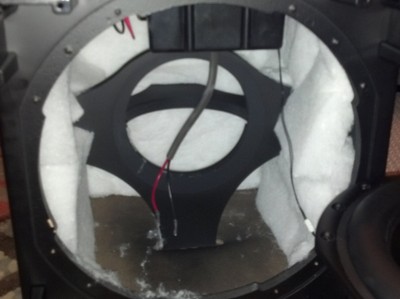

The cabinet of the Dynamo 1500X appears to be constructed of ¾” medium density fiberboard with the baffle built of slightly thicker material. The roughly cabinet features a cross brace which ties the 4 panels not housing the amplifier or driver together and also is generously lined with thick damping material on both of the sides and top of the cabinet. The result of this is a well damped and dead cabinet with little resonance or panel vibration in the subwoofers range of operation. Both the driver and amplifier are flush mounted and the cabinet features a small 1/4” round over on each edge. The basic satin black finish was evenly and thickly applied and durable. The component quality and construction of the 1500X is very good with the exception of the grille and feet which seem a little flimsy for a subwoofer of this price.
MartinLogan Dynamo 1500X Cabinet

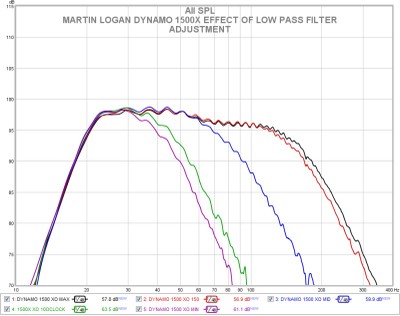

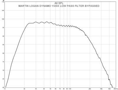

MartinLogan Dynamo 1500X: Effect of Low Pass Filter on Response
Above are the frequency response measurements of the 1500X showing how adjustment of the low pass filter affects the top end response. The roll off slope is 24dB/octave and the -3dB point agreed well with the indicated setting on the dial.
MartinLogan Dynamo 1500X: Basic Frequency Response as Tested
With the low pass filter disabled the 1500X produced its flattest response but the general shape was of a rising response into the deep bass down to 24Hz, a response that is filtered off above 150Hz and the rapid drop off below 20Hz of about 36dB/octave indicates that a 4th order high pass filter is in effect below 20Hz. Overall the resulting response shape fits within a 6dB total window from 19.5-162Hz which is very close to MartinLogan’s stated response of 20-200Hz +/-3dB but with a bit less upper end extension. The 1500X’s response shape is more like what you would expect to see from a large vented subwoofer with a 20Hz tuning than a small sealed subwoofer. There is a significant amount of processing going on to force the 1500X into this response shape. I must admit that I am not a big fan of equalizing small sealed subs like this.

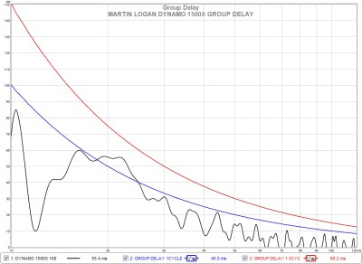

MartinLogan Dynamo 1500X: Group Delay
Group delay measurements for the 1500X indicate that there is some energy delay centered at about 20Hz corresponding with the boost equalization and high pass filtering used. The group delay is well mannered down to 30Hz where it starts to increase until it just barely exceeds 1 cycle of delay from 19-25Hz. Still at such deep frequencies and with the group delay just barely breaking 1 cycle it is doubtful that this is of any audible consequence.

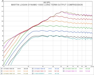

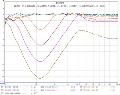

MartinLogan Dynamo 1500X: Long Term Power Compression
The
long term output compression tests for the 1500X show that it responds in a
linear manner to increased output demands up through the 100dB sweep at which
point it has reached its maximum output potential near 20Hz reaching an output
of about 97dB. As the 1500X is asked for more output it responds by producing
what it can without any overtly bad noises. The 1500X was still producing
increased output as demanded during the 115dB sweep. Finally during the 120dB
the 1500X was completely out of headroom over the full bandwidth but it is
notable that despite it being driven so heavily into compression in the deep
bass it never sounded like it was in any real danger and behaved in a very
stable and repeatable manner. By that point the 1500X was producing over 110dB
above 40Hz.
Note on Output Compression Testing: This is by far the most demanding measurement type conducted on the
subwoofers during our testing and will reveal any issues with overload, port
compression, port noise, driver distress, creaks, rattles, buzzes, etc.
Additionally the test is conducted outdoors with just the subwoofer operating
so there will be no nearby walls or objects to vibrate and no upper frequency
content from other speakers in operation. These would normally help to cover up
or mask any objectionable noises from the subwoofer in a typical room. Any sort
of audible distress or issues with the subwoofer are readily apparent in this
environment.
MartinLogan Dynamo 1500X: Output Compression Magnitude
Looking at only the amount of compression occurring in the output of the 1500X It can be seen that it does excellently through the 100dB sweep with virtually no compression. Compression starts to set in centered at 22Hz in the deep bass during the 105dB sweep this is due to the large amount of boost equalization applied to the 1500X to extend the response. However this also means that the 1500X uses up all of its headroom near 18-25Hz very early. Since that is the case the 1500X simply stops getting any louder between 16-30Hz. Thankfully the engineers at MartinLogan correctly matched the amplifier potential to the driver and dialed in their protection circuits very well, so while the 1500X will compress early in the deep bass it will not get damaged or allow the driver to produce gross mechanical noises no matter how hot the signal you send to the inputs. As can be seen even with a nominal 115dB sweep there is only about 2dB of output compression above 45Hz. By the 120dB nominal sweep the 1500X is finally at its maximum output potential across the entire 10-120Hz bandwidth. Judging by the compression shape in the deep bass the internal boost equalization appears to be at least 12dB if not even more, centered at 22Hz! Even at this 100% maximum output level the 1500X was very well behaved and while there was some deep bass distortion audible as warmth or an overtone to the measurement signal, otherwise the cabinet did not rattle or buzz and there was none of the spurious mechanical or other signals from the driver that it was badly overdriven as with many other units. The types of bad overload noises mentioned do not show up obviously in harmonic distortion measurements because they are not noises that are harmonically related to the signal but are actually far more subjectively obvious and offensive to the ear because of this fact. These are things like port chuffing, driver mechanical bottoming, or suspension slapping and rattles or buzzes in the cabinet or grille. The 1500X exhibited none of these. This is a very well protected and bullet proof design.

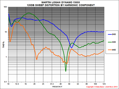

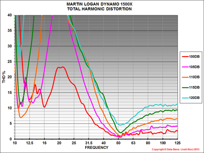

MartinLogan Dynamo 1500X: Total Harmonic Distortion
MartinLogan Dynamo 1500X: Distortion by Component
The distortion results for the 1500X indicate that it behaves well during the 100dB sweep but as previously seen is already being driven to maximum output near 20Hz which shows up as elevated deep bass distortion. Above 35Hz there is less than 5% THD at that drive level. By the 120dB nominal sweep the deep bass is into the limiter, the amp is out of headroom everywhere and the deep bass distortion has grown to over 30% below 25Hz. Still the THD is just reaching 10% above 40Hz while the output is above 110dB. Looking at the harmonic makeup of the distortion captured during maximum output of the 1500X shows that while distortion is not extremely low it is primarily dominated by the 2nd harmonic over almost the entire range above 23Hz. The 2nd harmonic is relatively benign subjectively and indeed some listening tests have shown people to prefer a bit of 2nd harmonic distortion. Again this confirms my impression of the 1500X sounding very composed even when pushed very hard. The third harmonic, indicating large driver excursions usually, becomes highest between 14Hz to 23Hz but drops off dramatically above 30Hz. The 4th harmonic is under 3% above 19Hz with the 1500X producing its maximum output.

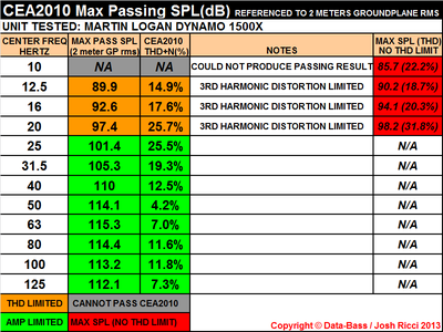

MartinLogan Dynamo 1500X: CEA2010 2 Meter Groundplane RMS Results
CEA2010 Results
The CEA2010 maximum distortion limited short term output results for the Dynamo 1500X indicate that it has impressive headroom from 40-100Hz, with peaks of 110-115dB recorded. This is the range where most of the bass in music is centered. This reaffirms my subjective impression of the 1500X of doing especially well with music. In the deep bass the 1500X loses some steam as is to be expected of a small sealed subwoofer…The physics is simply against it having huge deep bass output. However it still produces respectable output by using a capable 15” driver and strong amplifier and manages to dish up 90dB way down at 12.5Hz. It could not quite produce 100dB at 20Hz at 2 meters, topping out at about 98dB with the CEA-2010 burst signal. In room however the typical boost to frequencies below 30Hz will help provide some extra headroom in the deep bass and indeed measurements in my room at the listening position indicated that the 1500X received a nice lift from the room and that distortion was also lowered substantially. Considering the design and overall size of the 1500X these are commendable results.
