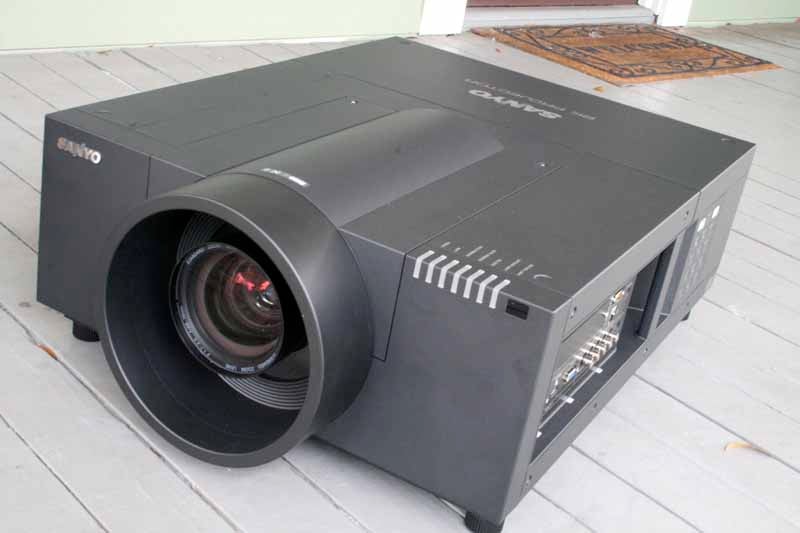

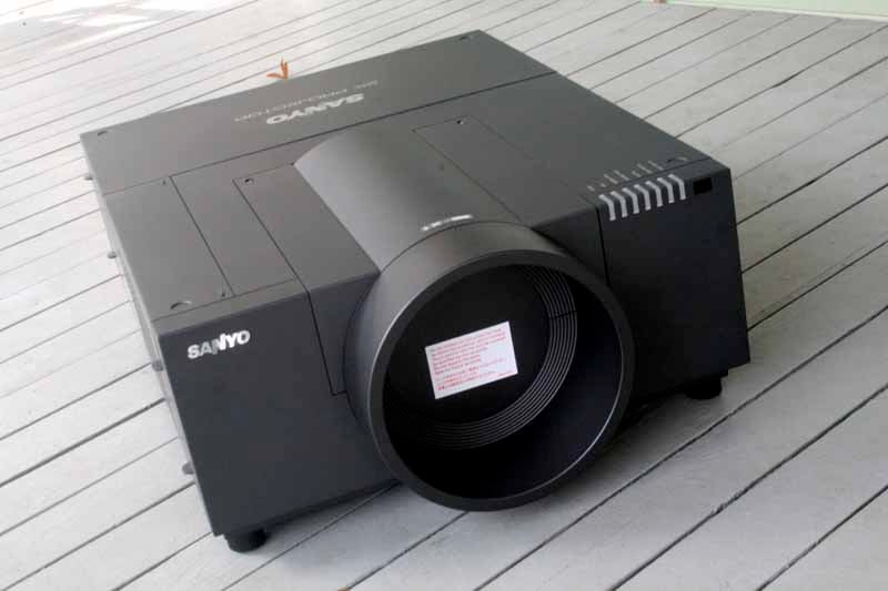

Some projectors are designed for home theater, others for commercial applications. Anyone stumbling onto this review should be 100% convinced that this projector is designed, intended, and perfectly suited for large venue applications and is not created to compete with less-expensive home theater models. To be quite frank, the Sanyo PLC-HF10000L projector is in a completely different class altogether. First off, it's the world’s first "QuaDrive" projector with Real 2K resolution. What that means is this projector has, natively, a resolution of 2048 x 1080 pixels on each of its three 1.64" TFT Poly LCD panels. This not only exceeds the requirements for full HD resolution, it also makes this projector suitable for commercial cinema use. In fact, when comparing this style of projector with its 3-chip DLP counterparts, the Sanyo comes in at a very reasonable price that makes it exceptionally competitive. This widescreen 3LCD projector puts out an incredible 10,000 ANSI lumens when using both of its 380W UHP lamps.
PLC-HF10000L beauty
The QuaDrive engine adds a yellow color control device to the red, green and blue elements of the projector’s 3LCD system. By automatically controlling the amount of yellow light in the image, it supposedly improves color accuracy, produces a wider color gamut and enables higher brightness levels. It was first introduced in 2008 in the PLC-XP200L, and in 2009 the technology was putting out effective color at high brightness levels of 12,000 lumens with the PLC-XF1000.
The PLC-HF10000L is new in that it's the first QuaDrive projector capable of native 2K resolution (Sanyo calls this "Real 2K"), with no image compression. Its dual high-output lamps are used in combination with three internal mirrors that produce uniform light output, reduce color irregularities and produce exceptional image quality even at the remarkably high image brightness of 10,000 lumens. We've seen it first-hand and will attest that the colors are impressive, even at high lumen output.
Sanyo's Durable Inorganic Optical System ("D.I.O.S.") works in tandem with QuaDrive to produce a 3,000:1 contrast ratio and also extend the life of the optical system. In terms of design goals, Sanyo wanted a lower total cost of ownership (TCO) - a feat they advanced through the use of an Active Maintenance Filter (AMF) system. The AMF aids long-term reliability and reduces maintenance costs by monitoring the intake air volume through the filter and automatically advancing the cartridge-like filter media to provide a clean surface once reduced airflow through the filter is detected. As with many of the other features available on the PLC-HF10000L, the AMF is designed to enable the projector to be used commercially, with a minimum amount of maintenance or adjusting - over a long period of time with high volume continuous use.

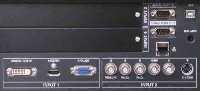

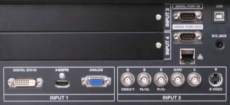

For commercial uses, Sanyo's built-in LAN networking facilitates control of the projector or a group of projectors through a standard CAT5 network. This is excellent for commercial installations where you want a unified projection system. The PLC-HF10000L also has a handy mechanical shutter system which means you can instantly shut off light transmission when necessary. Input options include HDMI 1.3; DVI-D; D-sub 15 pin RGB; BNC for RGBHV and CV/Y-Pb/Cb-Pr/Cr; and S-Video, with optional boards available for HD/SD-SDI and Dual Link SDI.
inputs

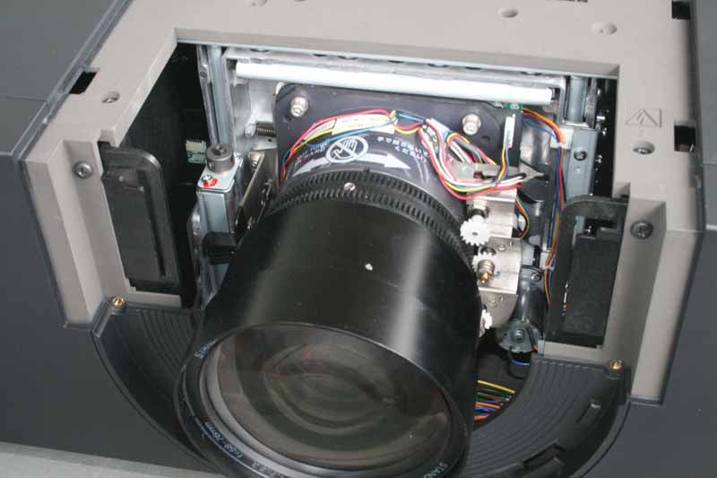

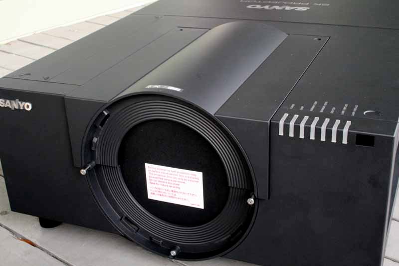

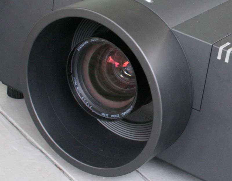

Like most high-end commercial projectors, the lens, as you can tell from our dossier on the available options, ships and is sold separately. After all, given how expensive the projector is already, why add more on top of that for a lens you don't intend to use? We requested the LNS-S03 standard zoom lens which would allow us to project onto our rear-projection screen that was configured for, to the glee of our neighborhood and friends, an outdoor Super Bowl party. Loading the lens is a bit more complicated than just screwing on an adaptor or pushing and twisting it into place. The lenses that are available for the PLC-HF10000L are active, meaning that they include connectors that supply power to the Focus and/or Zoom functionality of the system. We took the LNS-S03 lens from the separate box it arrived in and set it aside for installation. We then prepped the projector for the lens installation. The projector comes with a protective plastic cover in place to protect the inner electronics and LCD panels from dust and debris contamination:
beauty no lens
The first step was to remove the plastic lens shroud. This allowed access to the front screws.
angled no lens

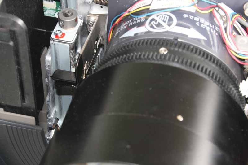

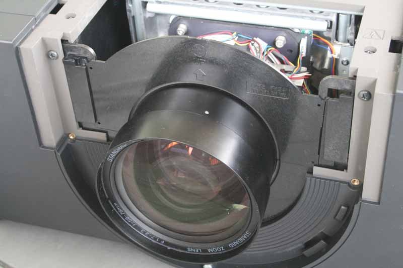

A total of four screws need to be removed. The two behind the shroud and the two on top which allow the lens cover plate to be slid forward. Once removed, we were able to load the lens into place. The installation was fairly easy once everything was removed. You line up the lens to the four protruding posts...
lens installation
...and then activate the sliding locking clamp to hold everything securely in place.
lens lever
Sanyo includes several foam-lined plastic surrounds to frame out the lens and block debris from entering around the lens.
lens shroud
The finished lens installation leaves the projector with a beautiful, completed look.
lens shrouded

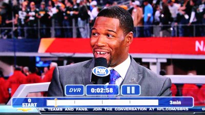

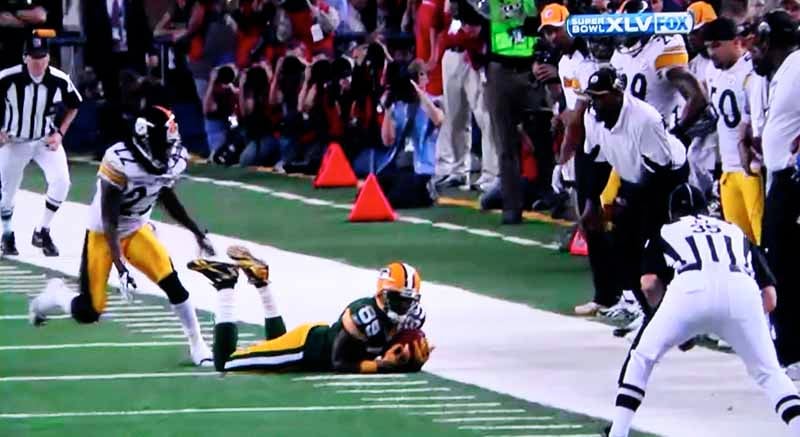

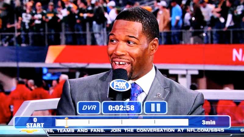

We weren't worried about downtime, so we operated the projector with its standard zoom LNS-S03 lens in dual lamp mode - with all 10,000 peak lumens outputting from the system's dual 380W UHP lamps. Since we were doing rear projection - and aiming for a really bright image, this seemed to be the perfect projector for this application (if not a little overkill since this wasn't exactly a commercial venue). Check out the images we captured:
Super Bowl XLV
Even the post-game show looked awesome
Super Bowl XLV post game

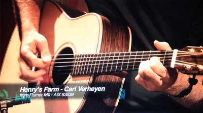

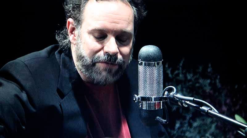

...and a new favorite, the Blu-ray sample disc from AIX Records. From this piece we captured high-definition images from John Gorka singing "The Mercy of the Wheels" and Carl Verheyen playing "Henry's Farm".
John Gorka
Carl Verheyen
