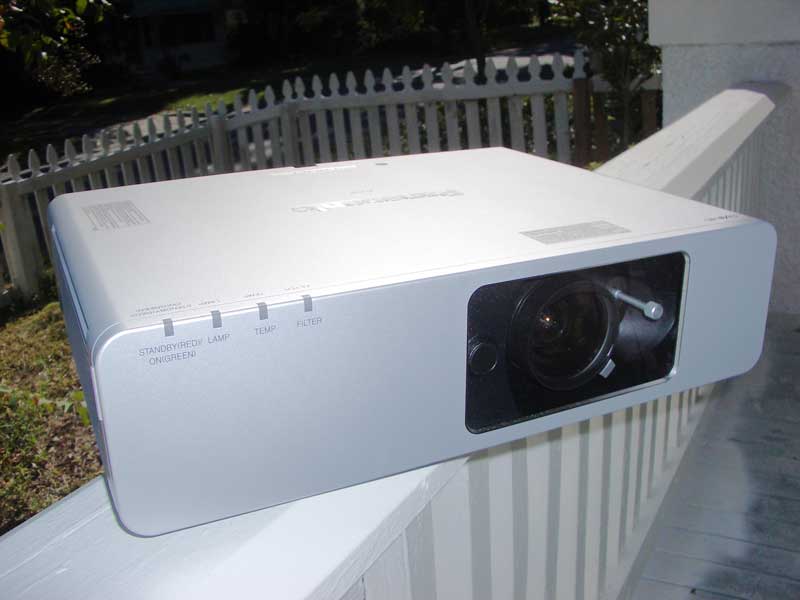

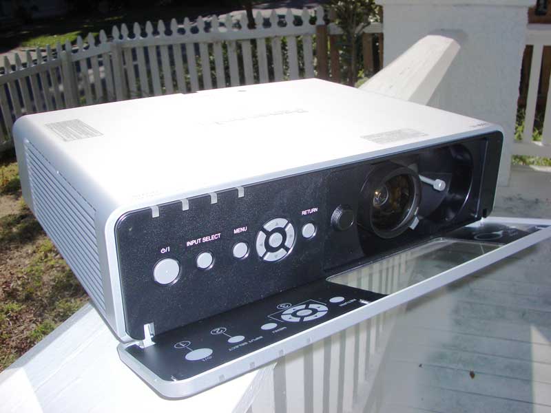

The Panasonic PT-F100U immediately impresses with its protective front panel cover that not only guards against dust and smudges on the front of the lens assembly, but also hides the functions you would not want accidentally altered such as zoom, focus, lens shift, input select and menu functions. For a commercial installation such as a church or office board room this is invaluable and, to put it simply, downright practical. Within the first few minutes, the PT-F100U had already aligned itself on a path to score a couple of 5’s on my rating checklist.

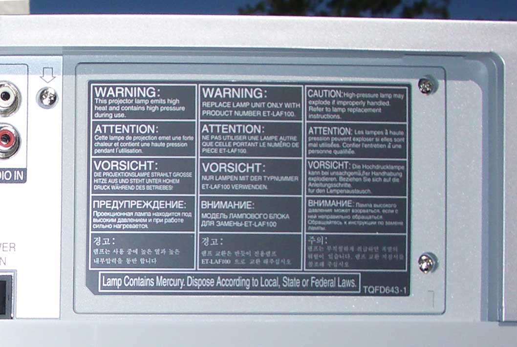

Taking a look at the rear of the projector you will notice a few things that will stand out clearly to anyone who has dealt with a commercially-installed projector. The lamp replacement compartment is located at the back of the projector. This means that there is no need to remove the system from a ceiling mount just to replace a bulb. Any projector intended for ceiling mount would do well to take this simple factor into consideration, especially with some of the 20-foot-plus ceilings I’ve seen in my time.

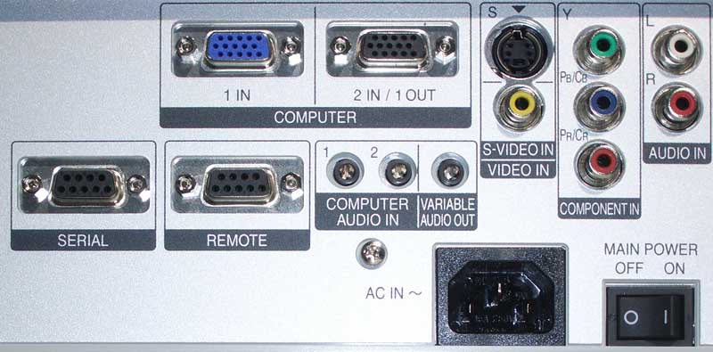

Inputs
The lamp unit compartment sits next to the input panel. This
projector is set up to handle all major analogue inputs types commonly utilized
in the US. While HDMI is taking over the US consumer market I do not see this
very often in strictly-commercial environments so I would not count this
against the projector in the least. The inclusion of HDMI would simply result
in increased cost due to the requirements it brings.
The PT-F100U has two RGB/PC (HD15) inputs, one of which can be configured, via software, to be a pass-through output. There are two audio inputs (1/8-inch mini jacks) which are permanently assigned to the HD15 inputs. A variable audio output allows the projector to control the volume level for a presentation via the remote. A component video input, S-video, and composite video is also present, along with a stereo RCA input which can be configured to either of these three analogue inputs.

Physically-speaking, the front panel on the projector flips down and reveals access to the lens shift, manual zoom and focus functions as well as power and the Menu controls. This is a nice feature as it gives the unit an extra level of security (though the front panel doesn't have a locking feature) and keeps dust from accessing the front of the lens. It's also a beautiful way to streamline the unit and make it look like a very sleek box.

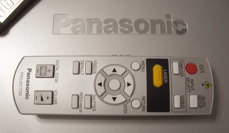

The remote is unremarkable and performs all the functions necessary. It does not have discrete on/off commands and is not backlit. It does, like most projectors in this class, sport an integrated laser pointer. You can cycle between Computer and Video inputs, and if you have the auto-select feature enabled that should work perfectly for most installations. Like other Panasonic projectors, there is a Freeze function which I find incredibly useful as a reviewer (I'm not sure how much use this gets in the “real world”). There is also a Digital Zoom function which could absolutely find itself being very useful in a boardroom setting where you want to zoom in on a particular area of an image for emphasis. Overall, nothing fancy, but it certainly isn't a terrible remote.

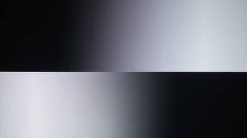

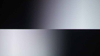

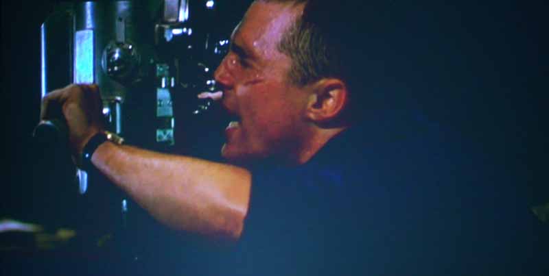

Right off the bat we see that black levels are going to be crushed. Regardless of what I configured in the Picture Settings menu there was no way to get sufficient black level detail. The upside is that there was also no banding, this projector is simply tuned to provide excellent bright images on larger screens.
If we take the above and lend it to a practical example, you'll note that darker scenes will seem to have large swaths of black with little detail or resolution. OK, so we won't be using it to show horror movies on Sunday morning or in the board room...

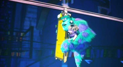

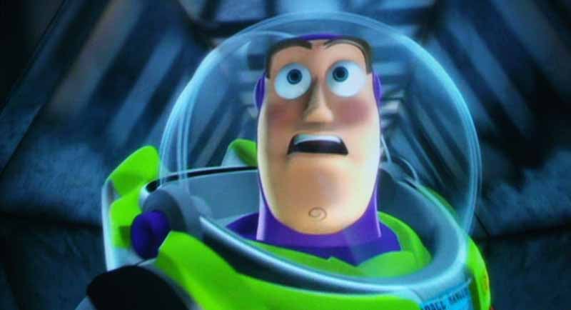

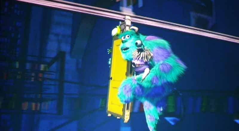

This is about as real-world an example as you will find for why proper 2:3 pull-down and deinterlacing is important. Note the dramatic stair-stepping on the rail that Sully and friends are sailing by on (you may need to click the image to better see it).

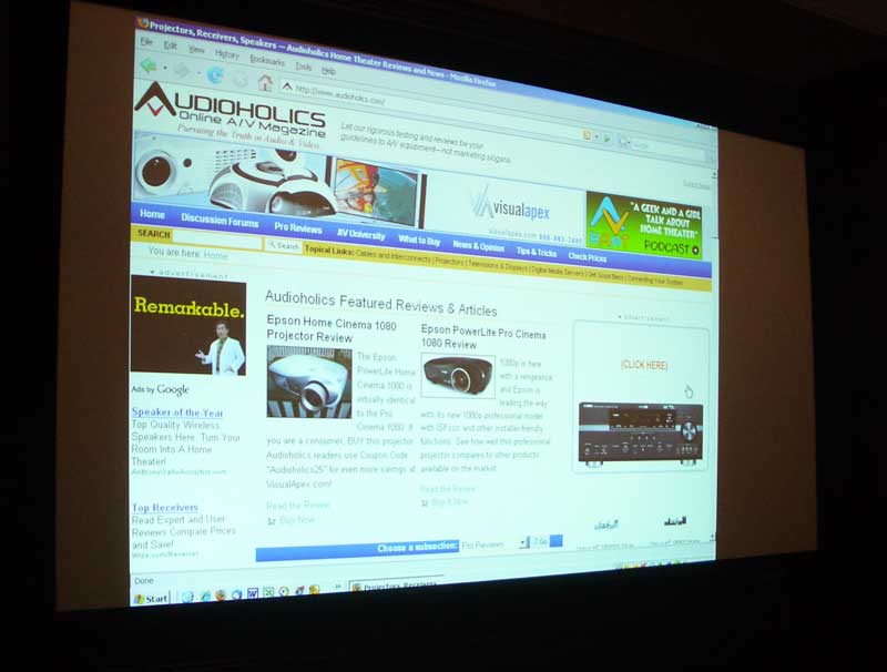

This system absolutely excelled at PC/Data use. In fact, while I was unable to get a photo that truly demonstrated what I witnessed in my room, the system was superbly bright and readable with full ambient light hitting the screen. If you are using the PT-F100U with a PC (PowerPoint presentations or worship lyrics with an application like MediaShout) then you will be pleased to note that dimming the lights will be more of a creative decision than one that must be undertaken in order to allow your projector to be visible.
