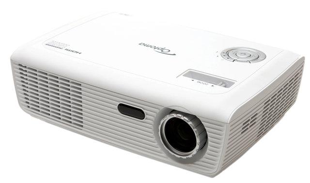

The Optoma HD66 arrived as all Optoma projectors have - well boxed and undamaged. Included in the packaging was a CD user manual, composite video cable, and VGA to component cable. This is a small white remote as well. The Optoma HD66 is white and boxy with a left mounted lens. There are three rubber, adjustable feet on the bottom with three mounting holes. To the side of the lens are fins to divert excess light off to the side. With the Optoma HD20, I found that the excess light was... well... excessive. With the HD66, I found it to be less so. This might just be me getting used to living with projectors, but it seems like Optoma has done a better job of controlling the direction of the light.

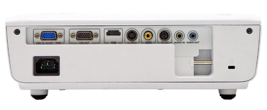

HD66 rear
Looking at the back, there are a number of inputs. Near the bottom is the power cord connection and a security bar for tying off your projector. The actual inputs include (left to right) VGA in, VGA out, HDMI, S-video, composite video, RS-232, and stereo audio in and out. Here is where I ran into the first challenge with the HD66. Included in the box is a six foot VGA to component cable but what I needed was a VGA to component breakout box. Scratch that, what I really needed was a component video input but I would have made due with a component video breakout box. Without one, I had no way of connecting my existing component cable to the unit. For the new user, this is an issue that can be fixed with a little forethought and planning. Those looking to upgrade current installations will need to either buy three component video female to female couplers or maybe look into some sort of wall plate.
While I question the need for both a composite AND S-video input, my supposition is that this projector is expected to bridge the gap between business and home theater projectors. If I were an IT director somewhere, I'd see the $700 price tag, the HDMI and VGA inputs, RS-232 support, the fast startup/cool-down time, and audio inputs and think, "Hmm... I bet I could get the company to spring for this and they wouldn't even miss it on the weekends." But that's just me.

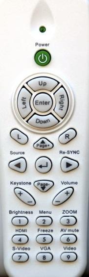

HD66 remoteThe remote is small, white and hit or miss. I like the fact that the power button is at the top and alone and green so that it is easy to find. I don't like the fact that the remote isn't backlit (though in some ways it is better than the eye-searing HD20 remote). There is a top grouping of buttons that were apparently designed for a different projector because I can find no use for them with the HD66. Under that, you'll find a grouping of buttons that are small and hard to navigate. They are, at least, different shapes and oriented slightly differently which makes navigating them in the dark a bit easier. I like the fact that there is a Brightness button though I don't see why you need a Zoom or Keystoning controls. It seems like these are setting that you set once and forget. There is a button for every input though you'll probably have to turn on the light to find the right one. There is an option on the menu to de-select the different inputs (under Image -> Advanced -> Input Source) which I used to make sure it didn't cycle through unused inputs. With HDCP, the handshake sometimes didn't happen quickly enough for it to lock on before it switched to a different source. De-selecting all the other inputs helped this plus it tended to work better with some inputs (DVD) than others (PS3 or cable box).

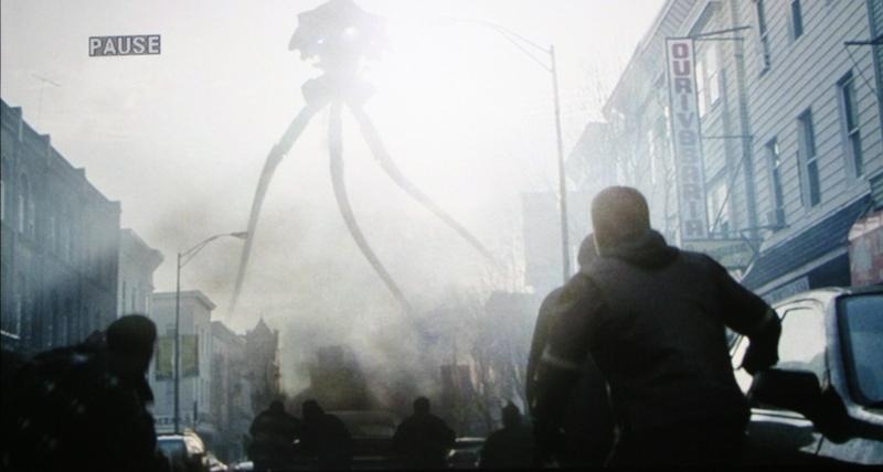

DVD: War of the Worlds
If you're like me, you were chomping at the bit for the Blu-ray version of War of the Worlds to hit the shelves. Well, it's here and I still don't have it. In honor, though, here are a few pics from the movie that made more than one subwoofer cry for its mommy and more than one daddy say, "But I DID turn it down!?!"
war worlds 1 war worlds 2
You'll notice the detail on the Dakota's hood, the well saturated colors, and the ho-hum dark level detail. Part of this is the movie, part is trying to take a picture in a dark room and upload it to the Internet, and part is the projector itself.

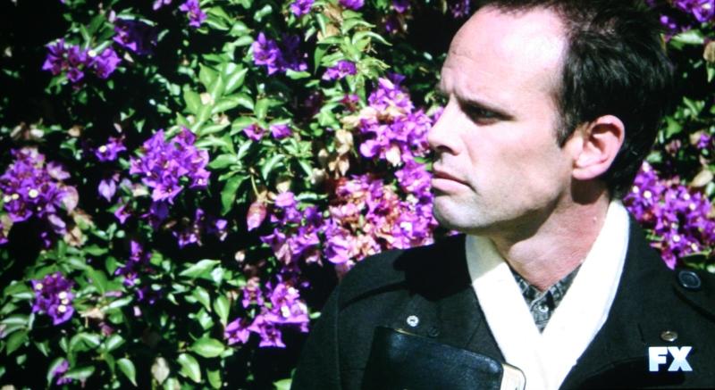

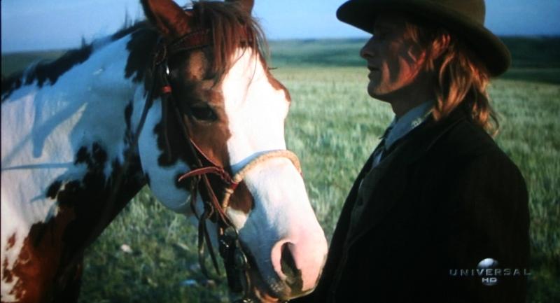

HD Cable: Various
We've got a shot from Hidalgo, one Deadliest Warrior, and two from Justified. Again, colors look great (a bit oversaturated because of the camera), plenty of detail - especially in the backgrounds, and no hint of noise or artifacting. This was all converted and scaled by the projector and not the receiver. If you'd have told me I could get image shifting and a picture this good for $700, I'd have thought you a liar.

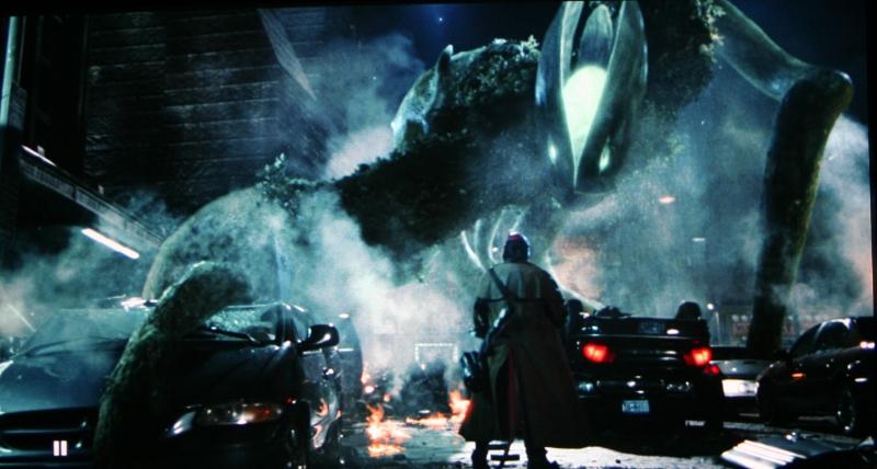

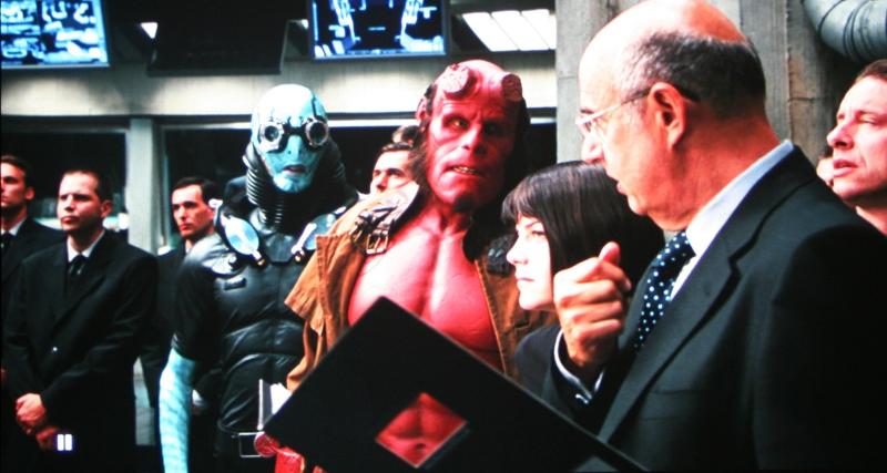

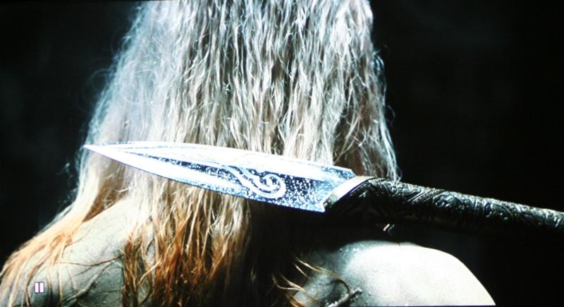

Blu-ray: Hellboy 2: The Golden Army
Well, even though the PS3 and the HD66 didn't like to play nice, I still wanted to show you a few shots from a Blu-ray. The HB2:TGA is a great reference disc for so many reasons. First, they use puppets as much as possible which give so much more detail (and in my opinion are better for the performances of the actors) than CGI (at least cheap CGI). The soundtrack is outstanding with enough bass for your sub and enough surround material for rears to really let you evaluate your system. Plus, it's just a fun movie. Humans, demons, elves, goblins and Barry Manilow? What's not to like?
hellboy 2 1 hellboy2 2
Check out the detail in the hair, on the floor, on the blade. Simply stunning. No evidence of banding or artifacts in the black background either.

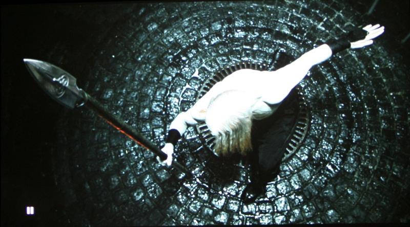

hellboy 2 3 hellboy2 4
Some of the red emphasis is from the camera. The goblin looks amazing though.

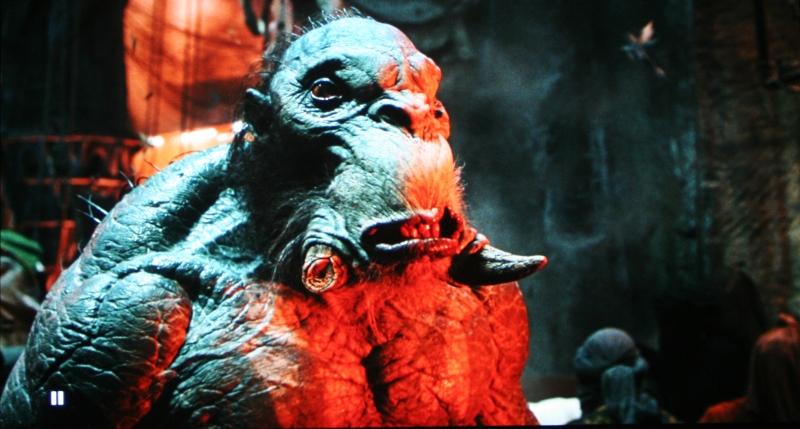

hellboy 2 5
This is really where you can see some dark detail issues. This scene is particularly hard for some displays and the HD66 did well, if not stellar. Still, once you get this projector into your home theater, you're probably going to be a little too busy watching the movie to notice such subtleties.
