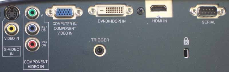

Mitsubishi HC5000 rear connections
The all-important 12V trigger is present on the rear panel of the HC5000 as is a functional RS-232C which will make this projector fully compatible with higher-end control systems. The component inputs are for use with a maximum of 720p/1080i, so if you've got your Xbox ready to output 1080p, downshift it to 1080i or get the new version with HDMI outputs. Either way I'm betting it still looks great… and since I'm not a betting man, I'll toss up the screenshots to prove it.

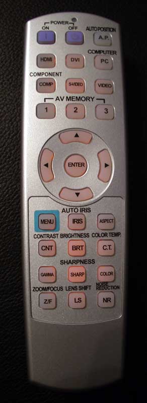

HC5000-remote.jpgI liked the layout of the HC5000's remote. All buttons were easily accessible and the backlit function came on when ANY button was pressed - a feature I appreciate and request in any projector remote. The backlight stays on for about 6 seconds which is reasonable, and I liked the arrangement of buttons. What I didn't like was the range and effectiveness of the remote. I was very difficult to control the HC5000, even though I was only about 11.5 feet form the screen. At times I found myself doing contortions to get the remote positioned just right, even aiming it backwards at times when I finally got frustrated. There is no excuse for this type of remote control behavior given the price of this unit and beta testing which certainly must have revealed this prior to release. The reason it is so frustrating is that it takes all of the positive features like motorized zoom, focus and lens shift and turns them into "mini-hassles" which must be endured. Had the remote controlled the system better, then I'd be spending all this energy and literary real estate gushing about how cool it is to use a remote to focus and dial-in the picture.

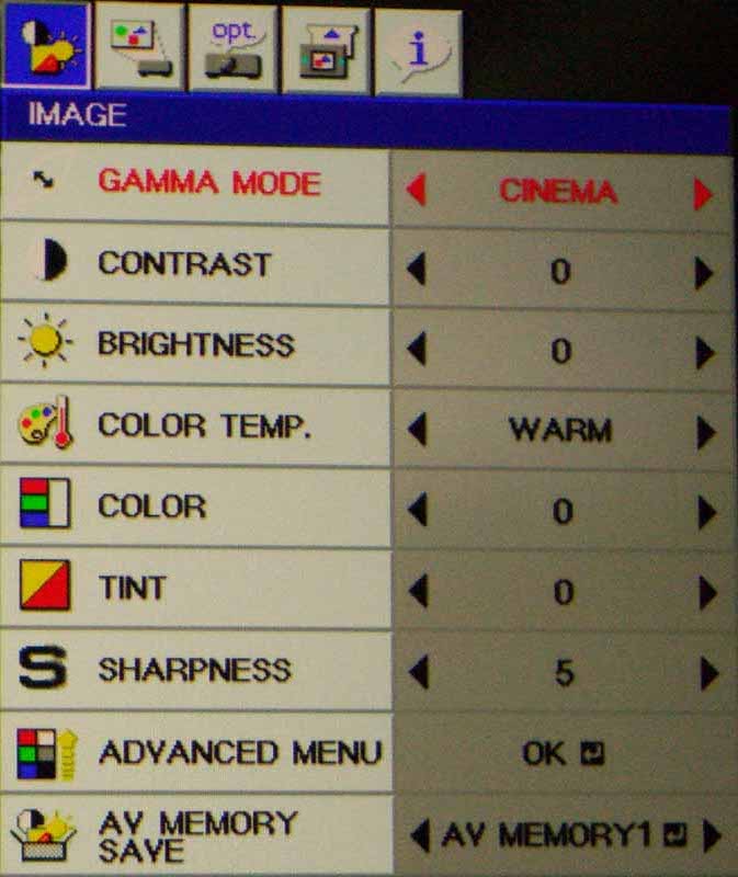

HC5000-image.jpgWith the exception of getting in and out of the sub-menus, the menu system on the HC5000 is straightforward and easy to navigate. Sub-menus are somewhat anti-ergonomic and annoying because they force you to scroll all the way to the top to exit a particular area or hit the Menu button rather than the far more intuitive 'left arrow' exiting I see in many other projectors. All whining aside, I was at least happy to see that most of the functions I look for were present and there was a great deal of customization available in the User menu.
Image Menu
This grants the user access to Gamma (picture) modes and the typical adjustment settings for the projector like Contrast, Brightness, etc. You can also save your settings to Memory positions which can be recalled from the remote directly. This is very handy if you decide to set up unique modes for difference types of viewing (daytime, nighttime, black & white movies, etc.) AV Memory settings also work across different inputs.

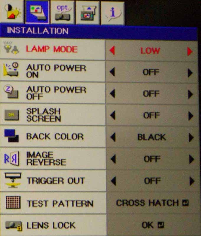

HC5000-installation.jpgInstallation Menu
The Installation menu is simply where you configure the most basic functions of the display such as auto on/off, background color (when no signal is present), front/rear projection mode (called "image reverse") and the trigger output. You can also call up a test pattern and lock the lens so that adjustments cannot be made which would throw off the picture (handy for once a system is installed in a ceiling mount configuration).

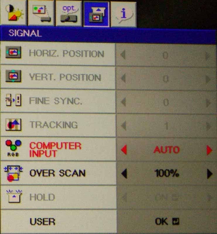

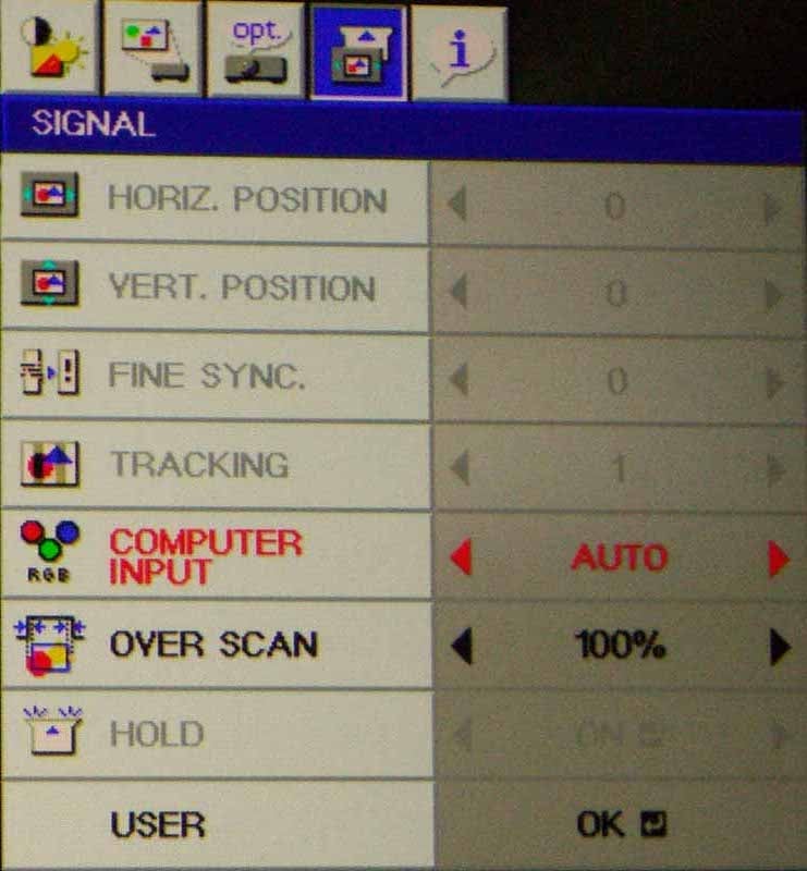

HC5000-signal.jpgSignal Menu
Primarily for PC interfacing, this menu gives you the ability to access vertical and horizontal positioning, Fine Sync and Tracking adjustments. Users will also find the Overscan function here - be sure to set it to 100% for best scaling results.

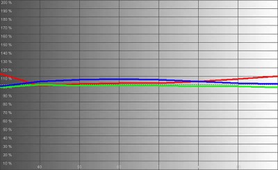

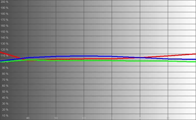

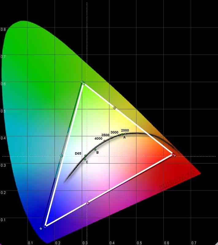

HC5000-CIE.jpgI was all set to calibrate the Mitsubishi HC5000. In fact, I was looking forward to it. I broke out our trusty datacolor ColorFacts Professional software and connected the Spyder2 sensor to begin measuring color temperature, build my CIE color chart and start the process. When I completed my grayscale measurements I sat back and shook my head. This projector, at least my evaluation unit, didn't really require calibration out of the box. The numbers I got were good enough that exercising a full ISF calibration seemed pointless - the gains would be too small (or likely, I'd make it worse). I can't say with utter certainty that everyone else's experiences would be the same (we've been burned before by "golden units") but my understanding is that this is stock performance for the HC5000. With that being the case, kudos to Mitsubishi for setting up their projector properly and making it easy for custom installers to get a great picture up front and hassle-free.
Speaking of doing it correctly, get a load of the CIE chart! The HC5000 has almost flawless color, with no saturation deficiency in either red, green, or blue. I have not seen color this good in a projector in a long time and am happily surprised by what I found in this model.
The Measurements

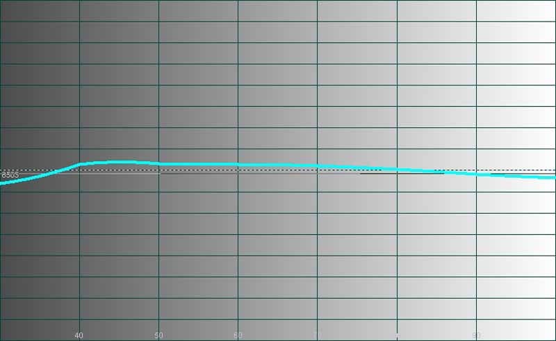

Check out the color temperature from 30 to 80 IRE. It's not flat as a ruler, but you can see that it varies by less than +/-100K across the board. I can live with that kind of tolerance and, unless your name is Joe Kane, so can you. RGB and luminance graphs told me instantly that I was going to leave this beauty alone and 'let it ride' as far as the performance was considered.
Now, getting the color temperature correct only happened with the right settings, and I'm going to give those to you. After setting black and white levels I proceeded to measure color temperature in the various modes. I found that having the projector set to Cinema Mode with color Temperature set to 'Medium' produced the best result (around 6600K at 80IRE). We also measured the color temperatures in various modes (again using an 80IRE field as our reference point):
  • Cinema Mode (Warm) - 5700K, perfect for black and white movies!
  • Cinema Mode (Medium) - 6600K, the preferred setting
  • Cinema Mode (Cool) - 9050K, definitely bluish in hue and much brighter (perceptually)
  • Cinema Mode (High Brightness) - 14000K, use this mode if you plan on using your projector for a Bat Signal

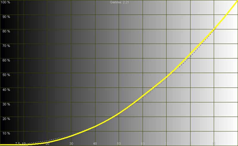

There are perceived contrast ratios and there are real contrast ratios. In my room I measured 680:1 in Low lamp Cinema Mode. Maxing out the system I attained 1425:1 using the High Brightness modes and Standard lamp power. I also measured the ability of the projector to hit the screen in the Cinema and max modes. I got 12.4 fL in the desired Cinema mode with low lamp and Medium color temperature. Powering up to maximum we achieved around 28.5 fL. Both measurements were to a 100-inch Stewart Studiotek 130 screen (1.3 gain) from 11.5 feet away.
As I mentioned above, the golden settings are Cinema gamma and Medium color temperature. Put your lamp in low mode if you have total light control in your room. If you feel you aren't getting enough light to the screen, then put the lamp into Standard mode and see how that does for you. Over time the bulb will decrease in intensity, so if you're like me you may not want to wait until the last second to replace it. By that time you may be watching around 7-8 foot-Lamberts and missing much of the picture detail.

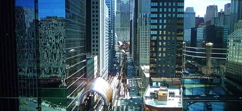

HD DVD - Batman Begins
batman-begins.jpgThis movie was dark… and detailed… and absolutely reference quality. I loved the plot, but I loved watching the natural torture tests shown on-screen even more. Whether it was pin-striped shirts, or city skylines that would make any jaggie-reduction scream in terror, Batman Begins is a movie that you can test nearly all aspects of a projector's video processing system with. I also like the fact that you can enjoy your time while doing it. There are test scenes that are absolutely horrendous to sit through - this movie makes it fun and easy. I cautiously watched through the darkest scenes (nearly the whole movie in fact) and tried to pick out loss of detail, crushed blacks or banding, but found none. Everything came through impeccably and with the sort of naturalness that gave the images rendered by the HC5000 a clarity and depth I don't see all the time.

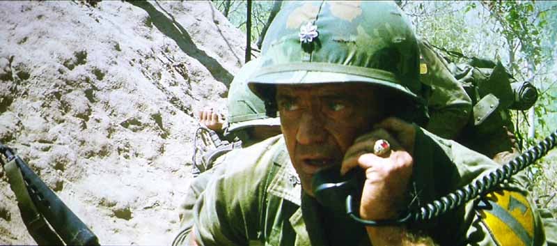

HD DVD - We Were Soldiers
we-were-soldiers.jpgI can't believe I missed this movie on initial release, but somehow I did. Mel Gibson and Randall Wallace (Braveheart) teamed up to bring another epic title to the screen - and pulled it off with gusto. This movie had a lot of detail mixed with extremely fast-paced action. Due to the quality of the film, motion adaptive noise reduction played a major roll here and the Mitsubishi didn't drop the ball. The interesting picture also juxtaposed colorful breakaway sequences of the family life the soldiers left behind and broke up the more earthy color sequences that dominated the Vietnam battlefield. I loved looking around the scenes as they went by, checking out the details in the earth and rocks as well as the equipment, outfits and helicopters. It's a great movie, and though I would hardly call it reference quality, it made for an excellent test-bed of the HC5000's capabilities.

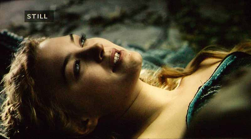

tristan-isolde.jpgMy wife picked out this movie and I was hesitant at the title until I read a bit more about it. When it played out on screen I was amazed at how good a movie could be that essentially blended the stories of Romeo and Juliet with that of Guinevere and Lancelot (I highly recommend you read The Once and Future King by T.H. White). In short, the story is excellent and the cast was brilliant. As for the picture, it was pretty good - especially with regards to close-ups of faces and garments (which were all hand-made to exquisite detail on-set). Because this movie had a lower budget, the photography was a bit bland in terms of color, so this wasn't a great film for stretching the depth of saturation the HC5000 is capable of delivering. For detail and black level, however, Tristan and Isolde was a great piece of test material. James Franco is definitely on the upswing of his career.

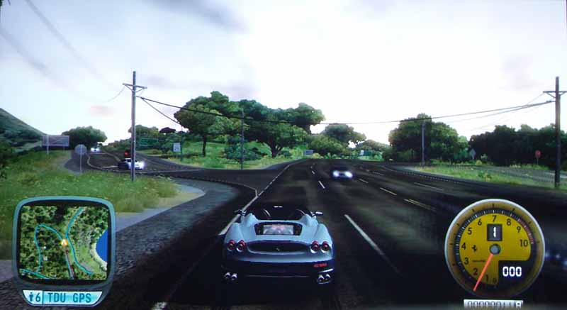

Xbox 360 at 1080i: Various Games
Between movies and my Xbox 360, I can say that I really enjoyed using the HC5000 projector. Games in particular (the Audioholics crew gets together every Wednesday night for some online playing) looked fantastic on this display and sitting just over 11 feet away from a 100-inch screen while playing Halo2, driving a $200,000+ Ferrari or picking off rogue South American dissidents is something not to be missed.
