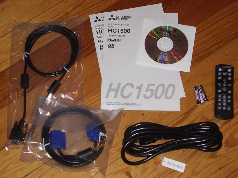

HC1500-accessories.jpgAs you can see, you may require some additional distance in order to fill your screen completely. This isn't a big deal unless you have a room that is shorter in length or you find the need to place the projector closer to the screen due to other physical restrictions of the environment.
The projector itself comes with an AC Power cable, RGB (HD15) cable, RS-232C cable, remote control (including batteries), lens cover, Quick Start card, User Manual and a Safety Manual. You'll need an HDMI or component video cable if you're planning on using either of those inputs (recommended.)

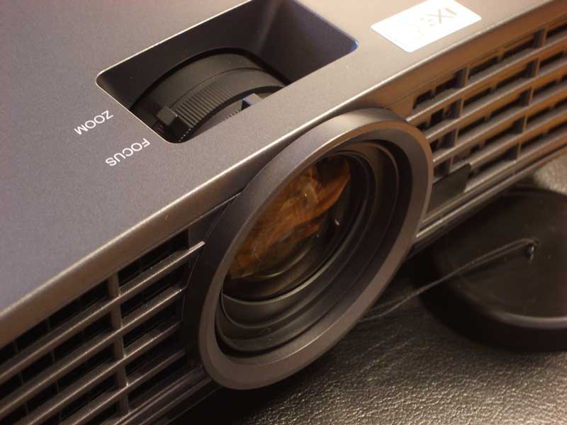

HC1500 Inputs, Build Quality, Remote and Menus

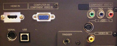

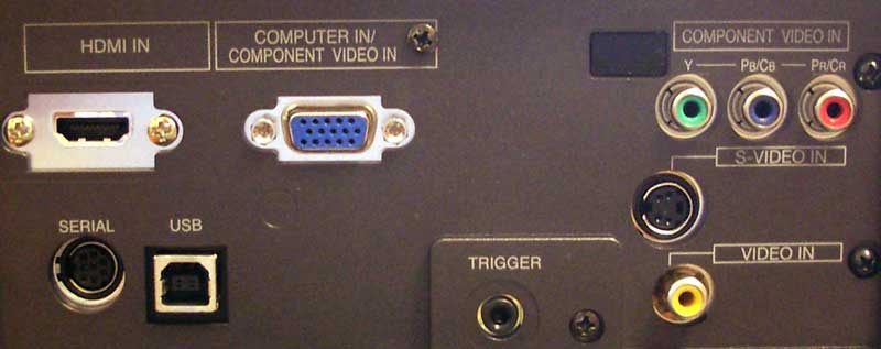

There are sufficient connections on the back of the Mitsubishi HC1500 to satisfy anyone I know. You have HDMI and component, with another available component input via the HD15 (VGA) connection. For those of you who don't have any HD sources and feel the need to blow up 480i imagery to ridiculous sizes there is a composite and s-video input as well. The surprise on the back of this unit, for me at least, was the presence of a serial RS-232C connection. With an 8-pin DIN to D-sub adapter you can fully control the HC1500 with an advanced system such as those from AMX, Crestron or similar.
Mitsubishi HC1500 rear connections

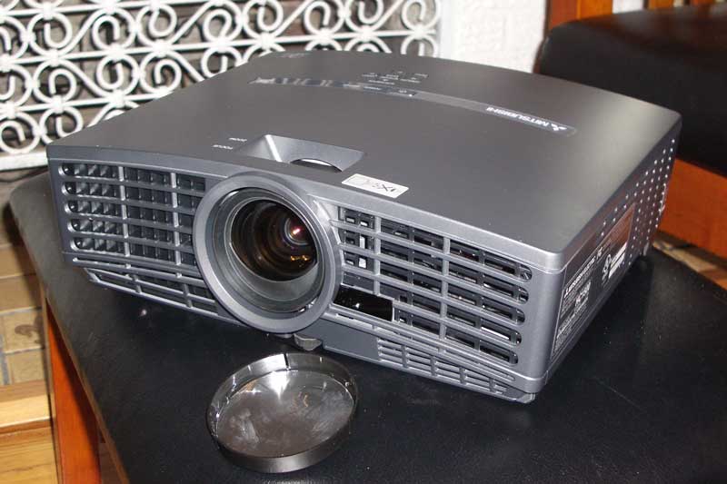

HC1500-angled.jpgThe HC1500 is really a great little box. With this many inputs and the ability to handle both 1080p/60 input signals (and with a 720p native panel resolution) it's going to be very hard to beat for value. The physical box itself has the same look of the HD1000 and HD4000 models. There is a manual focus and zoom adjustment just behind the lens as expected and much of the front and side panels are devoted to airflow and venting. As a result, there is a significant amount of light leakage from the front and right side of the unit. Fan noise was consistent but not terribly loud, though it did have a soft whine attached to it rather than a gentle whisper. An attached lens cap keeps the dust from settling on the lens when not in use. Aside from the remote, there are 7 buttons atop the unit for power, menu control, input selection and keystone correction. These buttons are multi-function and allow you to get the system up and running even if you are unable to access the remote.

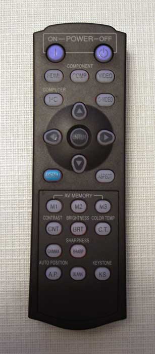

HC1500-remote.jpgThe HC1500 remote is pretty good, especially given the low cost of entry for this projector. You have direct access to input sources (all 5 input options) as well as some ways to immediately interact with many of the primary picture controls (BrilliantColor isn't one of these, however). Discrete On and Off buttons/commands are available on the remote as well – and which enabled this remote to land a healthy 4/5 score. One of my favorite features was the presence of three AV memory setting buttons. Selecting one of these buttons allows configuration and/or recall of the Image Menu settings for that selection. In this way I was able to configure a setting for nighttime Cinema viewing, one for Daytime viewing and another for black & white films (with a slightly lower/warmer color temperature). These are excellent features to have and the Mitsubishi puts them right at your fingertips which is very nice.
The remote was also very easy to use and the signal bounced from the screen to the projector in almost any position. I tried pretty hard to point the signal in places where it might not reach the unit and most of the time I had to quite deliberately aim away from anything in order to allow the remote to file to reach its target. The only thing keeping this remote from attaining a 5/5 was the fact that the backlight was so dim it was at times difficult to read the buttons. All remotes should work this well.

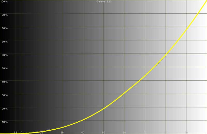

HC1500-CIE-Chart.jpgWe continue to utilize datacolor ColorFacts Professional software to measure and calibrate projectors using the user controls. With the HC1500 you actually get very acceptable picture quality out of the box, provided you start with the correct initial settings for Color Temperature and Black & White levels. Color potential wasn't bad according to the CIE chart here. If anything, the greens dipped a bit towards yellow but red and blue were almost spot-on. I also recommend turning BrilliantColor down to 0 if you aren't trying to eek out as much light output as possible (i.e. keep it off for theaters and light-controlled rooms.) BrilliantColor is a nice feature, but it will cause excessive white levels and throw additional light into the room which detracts from the image on the screen. Here were my recommended settings:
  • Gamma Mode: Cinema
  • Contrast: +4
  • Brightness: +4 (might want to bump to +5 or +6)
  • Color Temp: Medium
  • Sharpness: -5
  • BrilliantColor: 0
With these settings I got the “Before” measurements you'll see below. Sharpness and Brilliant Color both defaulted to 3. For BrilliantColor this wasn't a bad initial setting, but the Sharpness control on this machine needs to be turned down completely for best results (it's not a dummy control, when turned up it will create edge enhancement artifacts – at least with the patterns we tested). Here is a breakdown of initial color temperature, measured at 80IRE, to give you an idea why we chose Medium of the available options:
  • Warm: 6200K
  • Medium: 6700K
  • Cool: 9000K
  • High Brightness: 6700K
We measured Contrast Ratio to be a healthy 975:1 (real world) at the above settings. With BrilliantColor at the default level of 3 this crept up to 1187:1 and it jumped to 1714:1 when we maxed it out to 10. In terms of color performance, our measurements showed excellent results for both red and blue with a slight tilt towards yellow for green (see pic of CIE chart).
Note: We're not opposed to using BrilliantColor, however I prefer to keep the lumens lower so as to not drive up Black levels and increase ambient room light from the screen.
The Measurements

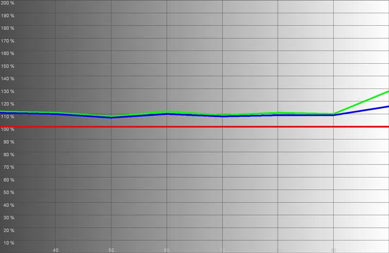

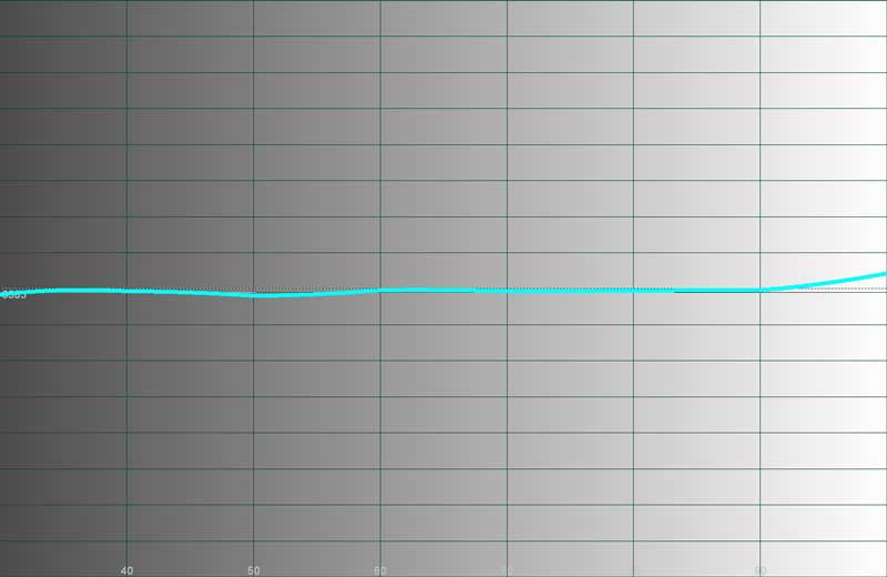

We took our initial measurements once we located the best Color Temperature settings and configured the correct Black and White levels (imperative in any projector system, so be sure to use either Digital Video Essentials, AVIA Guide to Home Theater, or any THX DVD.) Here's what we got:
As you can see the 6700K measured color temperature extended across the board, and an elevated red and green dominated across the IRE range, but almost perfectly in unison, delivering a very nice picture overall. It would not be unthinkable for users of this projector to simply configure it with the proper Color Temp setting, Black and White level and be done with it.
The before and after luminance histogram was almost identical, showing a smooth gradation throughout the entire range, though there was significant flatness at the bottom levels (<12 IRE). This led to some visibly crushed blacks in later video testing, so you may want to bump up black levels a notch or two above what is normal for test disc patterns. Calibration didn't affect this too much since our black and white levels were unmodified once we began.

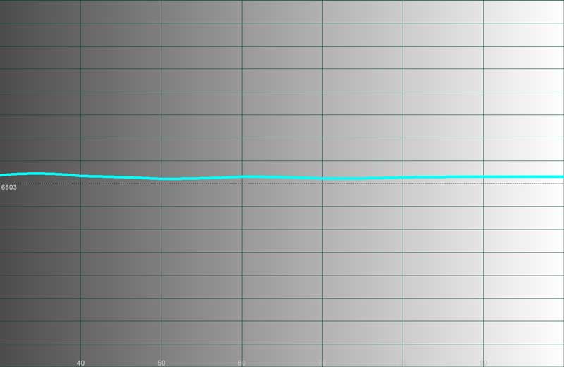

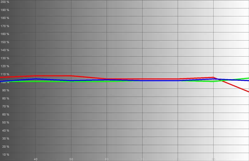

Here are our after results for temperature and RGB:
Color temperature was almost dead on throughout the entire luminance range and RGB looked much better with a slight bit of red carrying over across the range, making the picture lean just a tad to the warm side.
The max light output in Cinema mode with the Color Temperature set to Medium and black and white levels calibrated was 26.5 fL at the screen. At max brightness mode and BrilliantColor engaged at its maximum setting of 10 that number jumped to 46.9 fL (note that without adjusting BrilliantColor you won't get much more light out of the projector). Now, kick the lamp into Standard mode and that number jumps to almost 59 fL. If you want to use this projector in a room with some ambient light (for example during a sports party, etc, you'll be able to do so with very little difficulty (though you'll be absolutely crushing your white levels). In fact, you might burn a hole in your projector screen... just kidding… I think.
Now, getting the color temperature closer to the desired 6500K is possible with the right Color Temp setting, and I'm going to give that to you. After setting black and white levels I proceeded to measure color temperature in the various modes. I found that having the projector set to Cinema Mode with color Temperature set to 'Medium' produced the best result (around 6600K at 80IRE). We also measured the color temperatures in various modes (again using an 80IRE field as our reference point):
  • Cinema Mode (Warm) - 5700K, perfect for black and white movies!
  • Cinema Mode (Medium) - 6600K, the preferred setting
  • Cinema Mode (Cool) - 9050K, definitely bluish in hue and much brighter (perceptually)
  • Cinema Mode (High Brightness) - 14000K, use this mode if you plan on using your projector for a Bat Signal
