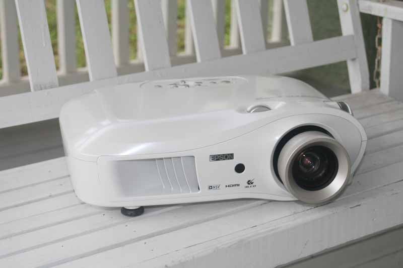

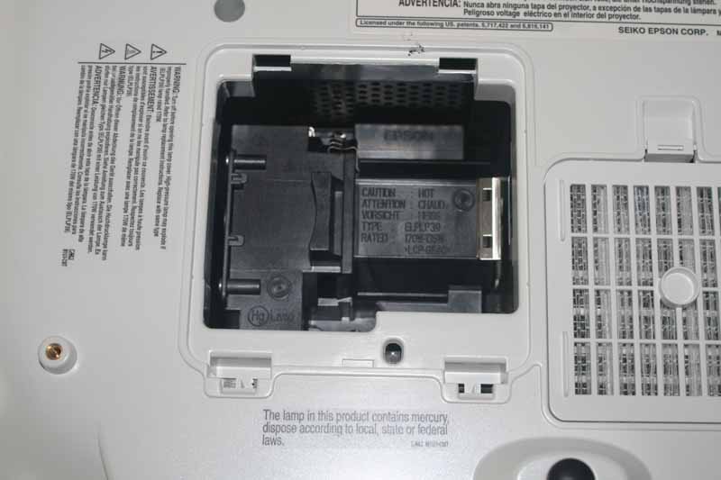

Let's pop the hood. Underneath the Epson you can find
easy access to the lamp replacement compartment. While the lid comes off
without any screws, its location means that you'll need to remove it from any
ceiling mount before you can replace the bulb. We prefer rear- or side-entry
locations for bulbs, but this isn't the end of the world. The two front feet
screw down for angling the projector upwards from a tabletop location. Epson
didn't include a "quick drop" mechanism, so you simply unscrew… and
unscrew… and unscrew… until the height is correct. Obviously, the better installs
for this projector will have the unit on a level platform so that the lens
shift, and not manual or digital keystoning, will be sufficient to hit the
screen perfectly.

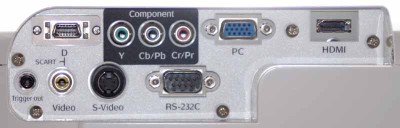

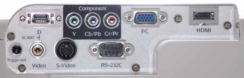

Connections
The connections on the Home Cinema 720 are identical to the both the Pro Cinema 720 and the Home Cinema 1080 models. You'll find one each of composite, S-video, component and HDMI, plus an SCART connection left over from the UK model. An RS-232C serial port means that Epson is serious about making this unit available for us in custom home theater systems and a trigger output is present for anyone wanting to signal a dropdown or electric screen system.
Home Cinema 720 rear connections

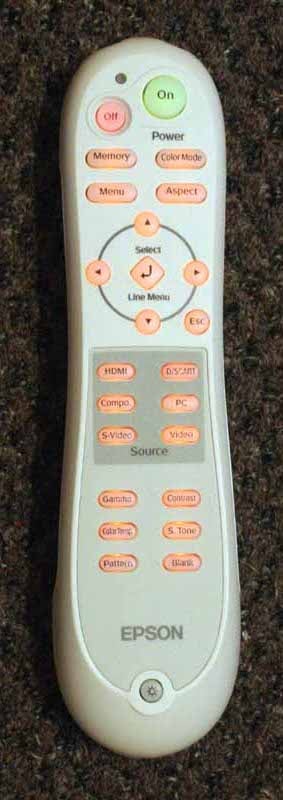

The remote
hasn't changed in years and is the same unit that ships with all current Epson
Home Cinema models. The range is still above average and the remote features
the direct input selection and discrete power functions for which Epson is
known. Direct access is provided to Color Mode, Memory functions, Aspect ratio,
Gamma, Contrast, Color Temp, and Skin tone controls. If anything, the remote
provides a few too many ways to screw up your image "on-the-fly", but
we won't complain too much. A Blanking function lets you quickly black out the
screen (but without shutting down the lamp) and a Pattern button brings up a
single blue-background crosshair test pattern that seems only useful for
setting focus and aligning the edges of the image. The most likely reason there
aren't additional patterns, say for setting black and white levels, is that
with those calibrations you want to configure the system, not the projector in and of itself. Having the projector
put up a gradient does nothing to help calibrate what happens when it is fed a
similar-type signal from your DVD or Blu-ray player.

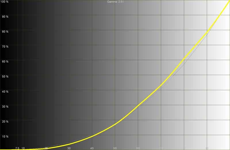

The Epson Home Cinema
720 didn't do so bad out of the box, though with the Auto Iris engaged you'll
end up netting a 2.5 Gamma curve overall (we prefer closer to 2.2). When we
calibrated the projector we did it with the Iris system 'Off', since leaving it
on would severely hamper our efforts at getting any sort of stable results. Once
Auto Iris was re-engaged, we double checked our Black and White levels and
allowed the system to expand the overall contrast by varying the light output
of the projector.

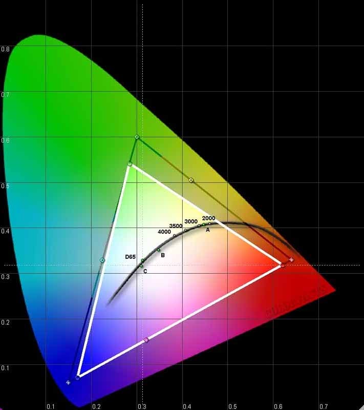

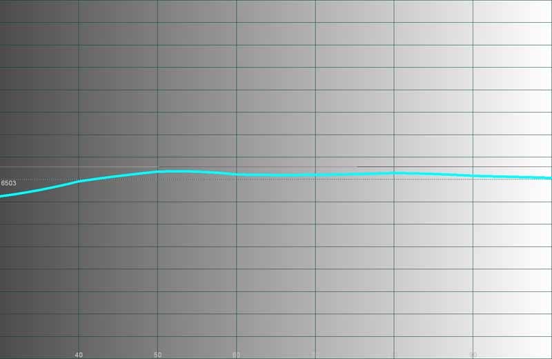

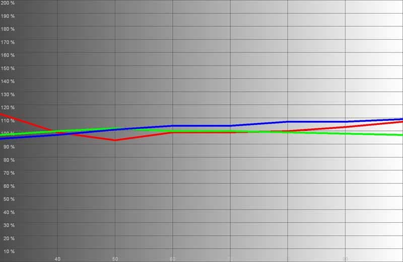

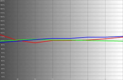

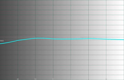

Using datacolor’s ColorFacts Professional software to calibrate and measure the grayscale response of the Epson projector, we again found that Epson put out a system which really does well out of the box. The CIE chart showed a deficiency in Green that tended towards Blue and also some slight Blue and Red deficiencies. I've measured some better color reproduction on other projectors, but I can't say that greens didn't look vibrant (plus we'd always prefer a tilt towards Blue over Yellow.)
Technical Note: We could not get the Home Cinema to pass below black signals when sent in YCbCr mode from a Denon DVD-3930CI (a source component we know to be capable of passing Blacker-than-Black). The projector does pass above White, but we had to calibrate Black levels without the aid of a below black signal (leading us to wonder if it was truncating or clipping anything else between 0 and 7.5 IRE. Please see our article on HDMI & Enhanced Black Levels for more information.
Taking a look at the RGB levels, it was apparent that only a slight deviation existed (+/-7%) across the entire spectrum from 30-80 IRE:
This really didn't translate into anything perceptible on the screen, though I'm sure there are some Hollywood colorists out there shaking their heads. While we did calibrate the system, we didn't find that the end results were enough of an improvement over the original to warrant recommending a third party calibration of the projector as a requirement for satisfactory performance. In addition, Color Temperature was almost spot on from 40-100 IRE only drifting a tiny bit within the midband of light output:
While the target color temperature ended up being around 6600K, the projector's Abs. Color Temperature setting had to be set to 7000K to achieve the results above.
Gamma wasn't the optimal 2.2 we love to see, but the picture quality still looked great and the curve lacked any S-curve issues we've seen with less competent displays and projectors:
Try lifting the Black Level up a notch if you feel that you are losing resolution in the lowest levels of dark pictures.

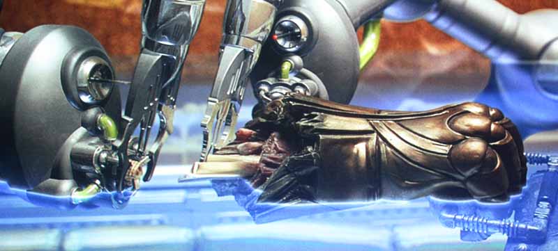

with this disc - there are so many to choose from. First off, we show the
incredible richness of the regeneration sequence and I also included some shots
which put forth a great example of high amounts of detail with little to no
noise present on the screen.

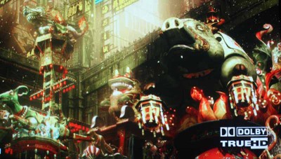

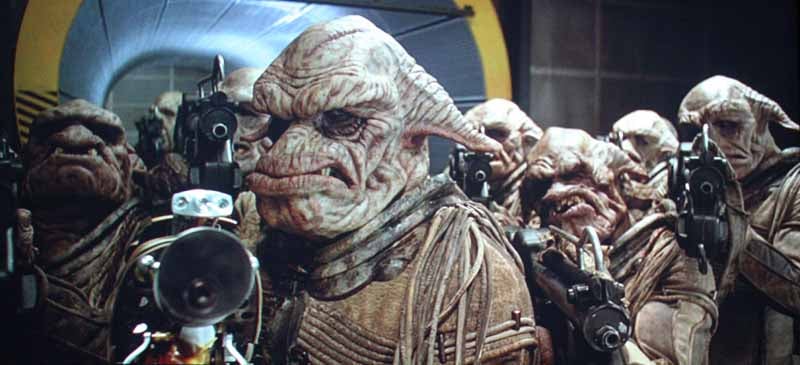

Ghost in the Shell 2 - you could truly peer into the dark areas of this scene
without losing all semblance of definition and detail.

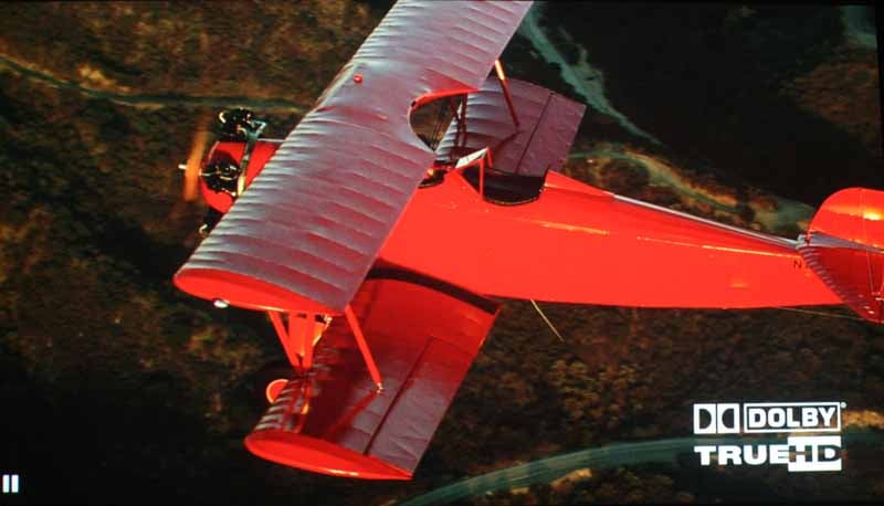

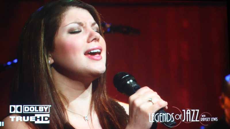

Jane Monheit looked as real as could be singing "You Can't Take That Away
From Me" in the Legends of Jazz clip.

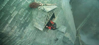

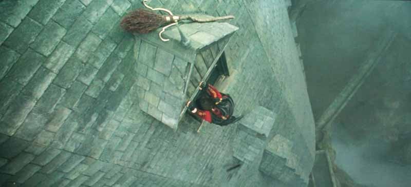

And what would an exposition of detail and black levels be without a colorized
clip from Harry Potter and the Goblet of Fire?

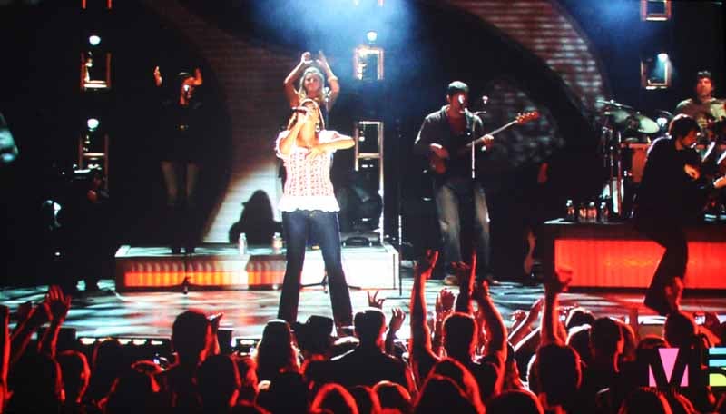

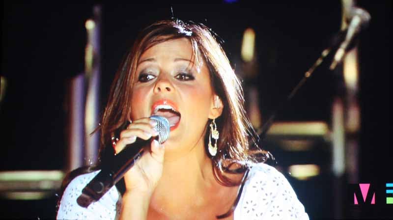

HDTV: Summerfest
I don't watch
much MTV, but their HD channel has a lot going for it. This week they played a
Summerfest show that really delivered some nice HD footage directly to my
screen in a way that couldn't be ignored:

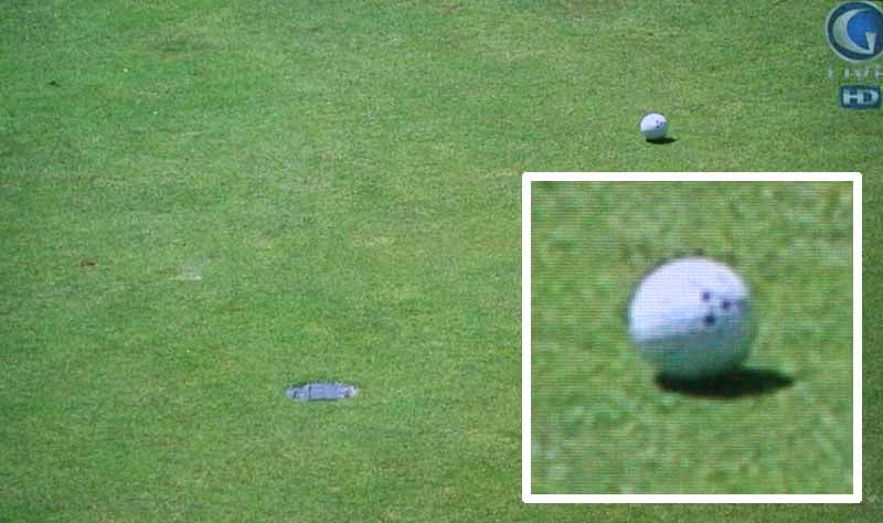

HDTV: Golf Channel
I'd get
specific on which course, event, etc I recorded to capture these golf shots
below, but a) who cares, and b) anyone who cares is probably geeky enough to
recognize the course and the event. Now that I have alienated all of the
golfers let me just say that I have a new measurement for "resolution"
and "detail". If you want to know if your HDTV or HD projector is
detailed, simply watch golf and see if you can pick out the dimples in the ball
when it's lying on the green. If you can, you're in good shape. If you can't,
you are either not watching in HD or you probably have a low resolution
display:
The inset at right is mine, but I could clearly see the dimpled ball lying on
the green during these setup shots which appear frequently in televised golf
tournaments.
The Home Cinema 720 is a great projector. At $1,299 retail this unit should just about fly off the shelves. There is a sort of stigma surrounding 720p projectors now that 1080p has flooded the scene, but the truth is 720p is often more than sufficient for most people's homes, especially if you ensure that you sit far enough back from the screen. In addition, Blu-ray looks just wonderful on 720p and most PS3 and Xbox 360 games are designed with that resolution in mind. We love 1080p projectors, but for those who are trying to trim their budgets and still get a fantastic picture, Epson is clearing a path to home theater bliss with the Home Cinema 720.
