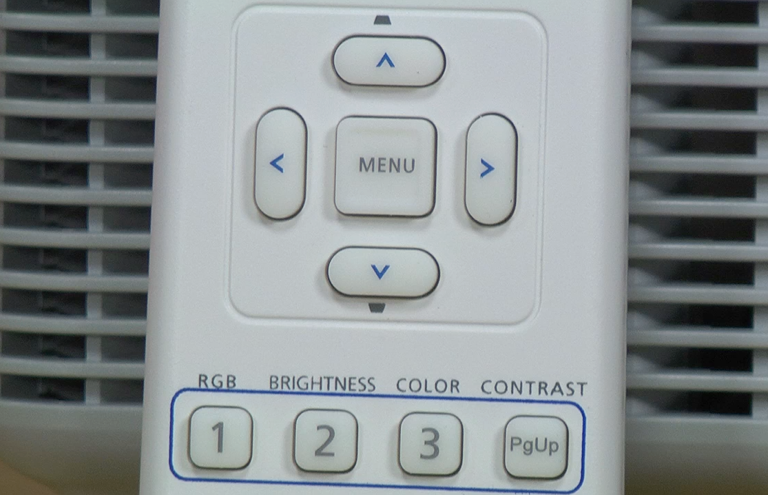

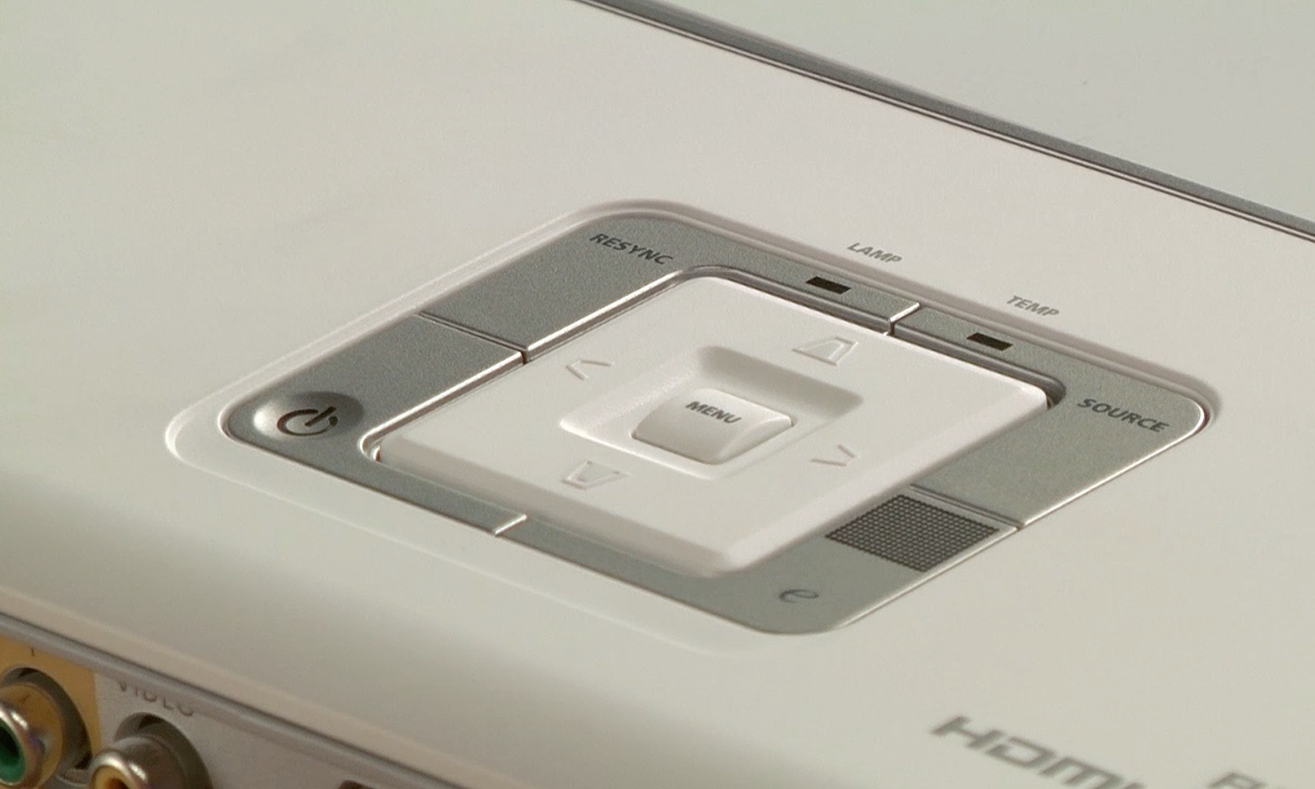

remoteOk, if your interest is piqued let's look at some of the other specs, and then we'll talk about our experiences with the H6500. First, it's bright. With 2100 lumens of max output, we found that it's got more than enough light to fill a big screen, even with some ambient light. And with that amount of output, the H6500 still managed to reveal an above-average black level for the price. There's a Dynamic Black system that varies the lamp power. It's nifty but it's slower than an auto iris system and it also varies the fan noise during use, so if your ear is near the projector you might want to keep it off. The remote control was easy to use and featured a straightforward user interface for getting around and configuring the Picture mode and minimal settings available. All of the inputs are also directly accessible, which we liked.

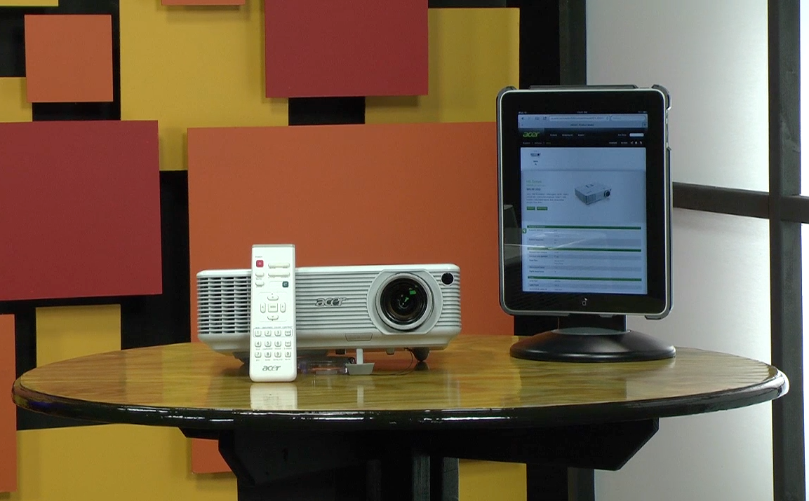

So back to our question: who's this projector for? Well it lacks some home theater functions that might be important to you, like advanced video processing and auto-iris. At the same time it's ultra-portable, super-bright, and puts out a beautiful picture. It doesn't have lens shift or much zoom on the lens, so you're looking at a tabletop or ceiling mount installation. A rear shelf probably won't work. We think the H6500 is a great solution for those looking for a living room system - an inexpensive TV killer. If you want only the best, then keep shopping, but expect to pay a lot more as well.
