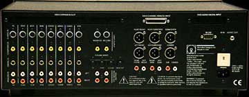

Rear View of the Soundstage
Ready for the Future?
These days, the audio industry seems to be moving as quickly as the computer one. Only, instead of worrying about processor speed, hard drive space, and datacom performance, the audiophile is concerned with if their Preamp/Processor will play all existing surround sound schemes and be ready for future potential ones. I emphasize "potential" when I talk about future schemes such as MLP, DVD Audio, DTS 6.1, etc, because although the hardware may be readily available at affordable prices in the near future, the software will always lag way behind. What's the point of having the latest lossless surround sound scheme capable of 192KHz / 24 bit resolution for 7.1 channels if only a few titles such as "Burt Bacharach Greatest Hits " or "Liberachi's Plays Piano " are available. Conversely, in the unlikely event that software for these new formats does become abundantly available, the Soundstage will be ready with its open architecture design. The Soundstage was engineered very cleverly in that it is not only firmware upgradable, but hardware as well. The entire data pump (DSP, DAC's, etc), and digital interface connectors (IE. DB25 or Firewire), can be changed out in favor of a newer design supporting higher bit/sampling rate surround schemes such as MLP for DVD Audio applications. In addition, the analog preamp section of the Soundstage is more than capable of accommodating the full 100KHz bandwidth of DVD audio, not that it really matters since most people can't hear above 15KHz, although you can really impress your dog or neighbors cat.

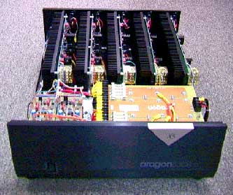

Photo: 8008X5 with top panel removed.Notice the oversized, independent heat sinks for each channel and the massive space allocated on the bottom-right of the chassis for the power supply.
A Balance of Power
The 8008X5 is truly an impressive power amp. It is one of the first few amps I have come across whose power supply is not the limiting factor, but the incoming power line is. It is because of this fact that I had the builder of my new home add a 20 amp dedicated line in my living room to ensure that I would have enough wall current to realize the full potential of this powerhouse. One thing that really amazed me about this amp is how effortlessly it can produce low frequency tones while at the same time remaining open, airy and clean in the mid and high frequencies. Every subtle nuance and heart throbbing dynamic passage was reproduced flawlessly by this amp, regardless of what speaker loads it was presented. While many multi-channel amps can deliver enough oomph for surround applications, they usually fall short audibly for critical two-channel music. The Special Edition RBH 1266-SE Towers in our reference system are not by any means an easy load for most typical amps to drive. The 8008X5 delivered more than enough power to make the RBH's rock the house while still sounding extremely musical. In fact, the louder I cranked this amp, the better the system sounded. Usually when you drive a lesser amp real hard it begins to sound bright (causing listening fatigue), or soundstage compression. The 8008X5 handles both music and home theater tasks with equal favor demonstrating that it truly is a well balanced design.
