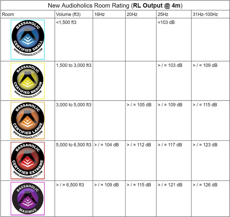

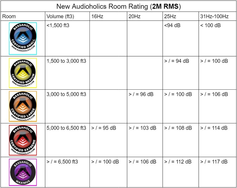

- If the 4 meter 1/8th freespace SPL equals/exceeds 123dB then the sub is suited for "Extreme" room size
- If the 4 meter 1/8th freespace SPL equals/exceeds 115dB then sub is suited for "Large" room size
- If the 4 meter 1/8th freespace SPL data equals/exceeds 109dB then sub is suited for "Medium" room
SPL data is below 103dB then sub is suited for "small" room
Updated Room Size SPL Rating Tables
To make things easy for our readers, we now give you two data tables for SPL and corresponding room size ratings. The first table SPL #s correspond to our 2m RMS measurements of the subwoofer. The 2nd table is 4m peak like we used to present SPL vs room size prior to this revision. We also added a new Maximus rating for HIGH output infrasonic bass levels for both tables. We now also assign a minimum SPL requirement at 20Hz for Large and above room size ratings.
