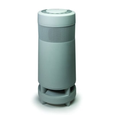

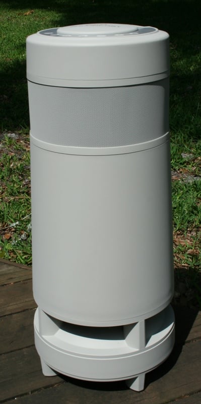

The OutCast
looked, at first, like either an air purifier or a Diaper Genie (depending on
your frame of reference). To say that I wasn't in love with the aesthetics
would be an understatement. The stock photos make it look like a column though
it is really a bit thicker at the bottom than the top. I'd suggest that the
Soundcast group get that Dyson guy to consult on the next unit - if he can make
a sexy vacuum cleaner, he can surely make this thing a bit easier on the eyes. The
unit itself isn't terribly heavy though it does get a bit cumbersome after a
few minutes lugging it down the street (see below). There is a handle on the

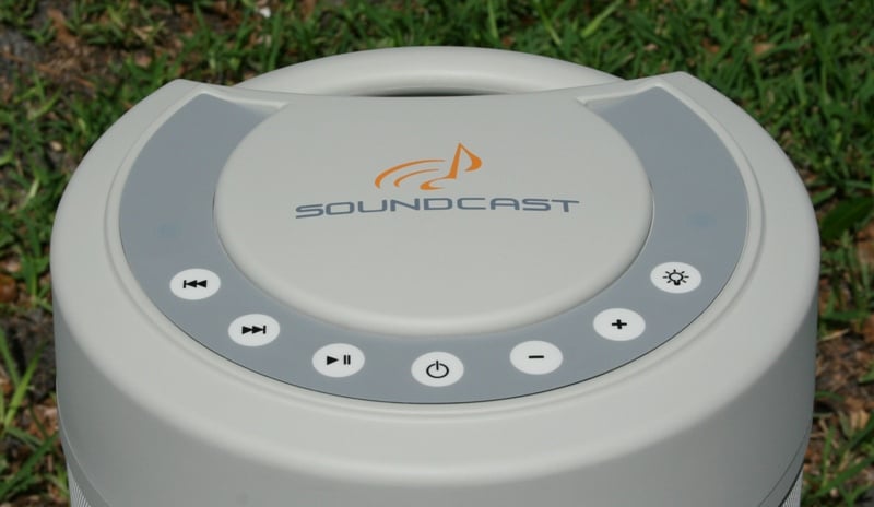

top for easy transport. The unit sports a downfiring woofer that faces a convex
plate for 360 degree sound dispersion. There are four 3" drivers hidden
behind a metal grill pointing in the four cardinal directions. The unit is
constructed out of high impact plastic that is a sort of cream color. It feels
very solid and sturdy.
The top of the OutCast has controls for any iPod that is connected to the iCast so that you don't have to run back and forth to the iPod to skip songs. There isn't a display on it so you won't be surfing your different folders but you will be able to play, pause, and skip tracks forward and back. There is a power button, volume controls, and a light button. Oh, yeah, lights. There are two blue LED lights that will illuminate and reflect off two sides of the bottom convex plate. On the other two sides there are downfiring slot-style ports. We've been informed that there is a fine mesh grill inside of the unit to keep out debris or animals. According to Soundcast, the OutCast has been tested to IP64 standards which means that it is dust tight and can withstand "water splashing in all directions" whatever that means. The OutCast can't survive a dunking in a pool and probably shouldn't be hosed down if it gets dirty. When the unit is powered on, the top controls illuminate faintly but enough so that it makes it easy to see in a darkened room (or on a deck at night).

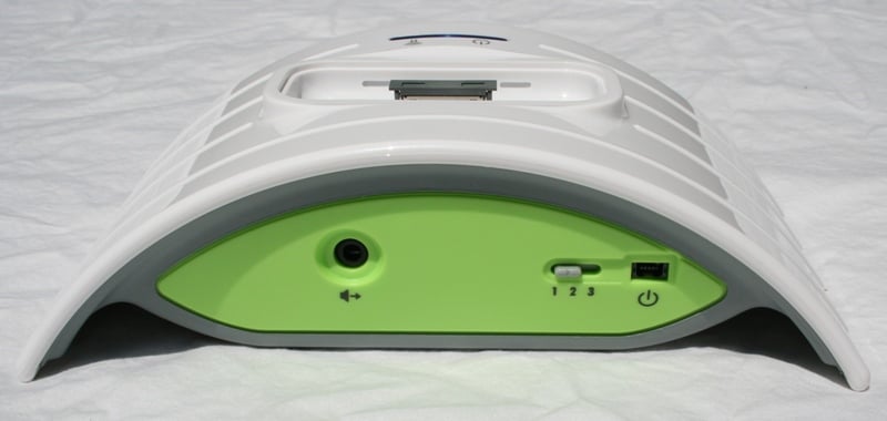

The iCast has a white semi-circle top, with an iPod dock/charger at the apex, and a gray bottom. The rear of the unit is green with a port for a power cord, a headphone jack, and a three setting channel selection switch. The iCast feels a little light for its size. While its stylized look goes well with iPods, it doesn't exactly match anything else in my system. The OutCast has a power cord port near the base and an Aux In and three setting channel selection switch near the top. All of the inputs and switches on the OutCast have rubber covers to keep them protected from the elements.

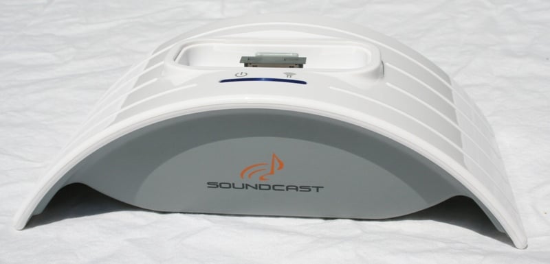

Once you plug in the iCast, you'll notice two lights on the top. One indicates
power and the other denotes a wireless connection has been established to the
OutCast. On the OutCast, there is a light for a wireless connection that glows
green when searching and blue when it is connected. From the time of powering
up both units, it usually took less than three seconds for a stable wireless
connection to be reached.
The iCast and OutCast utilize the 2.4 GHz frequency for wireless connection. This is the same frequency used by your cordless phone (probably) and the same one that will experience interference from things like microwaves and wireless routers. The iCast and OutCast get around this by utilizing Frequency Hopping Spread Spectrum (FHSS) technology which is also used by the Bluetooth. This basically splits up the signal into many different channels using a pseudorandom sequence. This not only reduces (or eliminates) the effects of non-distance based interference but also allows more than one iCast/OutCast solution to be used in close proximity.
Which brings me back to the three position channel switches on both the iCast and OutCast. Basically, if you want to have two OutCast systems operating independently of each other, you can set them to different channels and each will only receive what the assigned iCast is sending. Needless to say, you can have more than one OutCast tuning in the same iCast signal. What you can't do, however, is assign left and right channels to specific OutCasts. Each OutCast receives a combined signal for the right and left channels.
