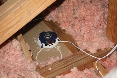

The home we installed the speakers in had very easy access to the attic above each room, making installation a pretty straightforward process for this project. The back porch does not have ceiling access, so we opted for a pair of bracket-mounted Ventura 6 weatherproof speakers.
The speakers were all home-run wired using 16 gauge speaker cable back to a gear closet containing a SONOS multi-zone system for power and source material. Our listening tests were conducted using both an iTunes library and Internet-sourced music from Pandora, Last.fm and Wolfgang's Vault. It is important to note that this installation focuses on whole-house audio applications, which is to say that it is not a critical listening setup. In-ceiling speakers in an installation such as this are intended to provide ambient sound for an active home. While we did put the speakers through their paces with a variety of music genres and volume levels, it is important to remember that this is a different style of listening that is less critical.

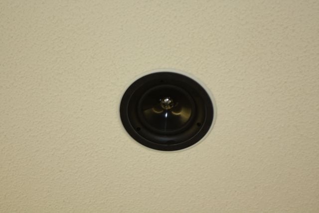

All of the speakers we installed from the Ci series are round, and share several KEF technologies. The "tangerine" waveguide on the aluminum dome tweeters provides not only protection for the driver itself, but also a wide and even dispersion of high frequencies throughout the room. This is part of the patented Uni-Q (coaxial) driver array that KEF is known for, which places the tweeter in the acoustic center of the woofer. The idea is that the woofer and tweeter are paired, allowing a single, focused source of sound that disperses evenly throughout the room. This is particularly important for this type of application where the goal is to fill rooms with ambient sound. Contrast this with a directional setup, such as what you would have in your home theater or two-channel dedicated listening room.
The Ci Series in-ceiling speakers also all have an ultra-thin bezel in an attempt to provide the slimmest possible visible rim around the speakers when they are mounted flush in your ceiling. The grilles can be painted if your application calls for it and are manufactured with a powder coating that contains a proprietary plasticized additive to resist corrosion in humid conditions.

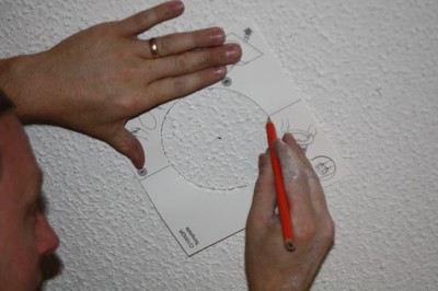

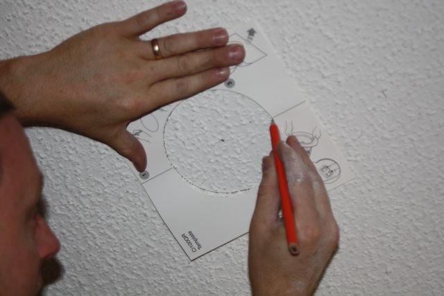

Most of the speakers we tested are 8-ohm, and all have spring-loaded, push button connectors (which we actually prefer for in-ceiling models). KEF provides a round template with each pair of speakers that makes it easy to trace the perfect sized hole in the ceiling. The speakers also came with a clear plastic paint shield which covers the drivers and allows you to protect the speaker if you choose to paint the bezel or grille once it is installed. The grilles are incredibly thin, and are magnetized, making installation very simple.
With the exception of the Ci100QR's, none of the speakers we installed came with a sealed enclosure, which left the back of the speakers open. In an attic with blown insulation, we were concerned that the loose insulation would fill in and around the rear of the driver, creating potential issues once the insulation covers the speaker after installation.
Since KEF did not supply a rear cover for these speakers, we asked them to clarify this choice for us.
KEF response:
"The KEF speakers are designed to maximize both audio performance and value for the consumer. In any loudspeaker design, physics dictates that there is a relationship or balance between cabinet volume, sensitivity, and low frequency response. Reduce cabinet volume and sensitivity and/or LF response will drop. By taking full advantage of the volume of air in the ceiling, wall or attic space we are able to maximize both LF response and maintain high sensitivity. This is why we do not, on most models, have an integrated rear enclosure. Because of the small woofer diameter on the Ci100QR, the impact of a rear enclosure is minimized, but in point of fact, you will have slightly deeper bass extension on the Ci100QR if it is used with its rear can removed. To make this easy for the installer, we even supply the Allen wrench needed to remove the can. There are several other advantages to not having an integrated rear enclosure. First the smaller footprint of the speaker and shallower depth greatly increase installation flexibility, and secondly money otherwise spent on the enclosure can be better spent to create a significantly better driver, again helping to yield superior audio performance.
In this retrofit project, there must have been access to the attic if the blown insulation is “the loose type", otherwise it would have poured out of the ceiling when the speaker holes were cut. So it should be possible to access the attic to push back the loose insulation over the speaker location, and use [a piece of] fiberglass insulation over the speaker. The fiberglass insulation is very good acoustically and will hold back the loose insulation."

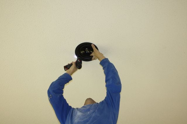

We began in the largest room of the house, the great room. This room has 14 foot ceilings and is approximately 20 x 15. We decided that four KEF Ci160QR speakers would provide the best possible coverage for the room. This speaker is comprised of a 6.5 inch woofer and a .75 inch aluminum dome tweeter with KEF's "tangerine" waveguide for high frequency dispersement.
We were able to measure out the spaces between the ceiling joists to choose a symmetrical array for the four speaker locations in the room - basically near what would be the four corners of the room. Using the guideline from the round template we had traced on the ceiling, we used a small, hand-held drywall saw to cut the holes. We dropped the speaker cable from the attic through each hole, then climbed a ladder in the room and terminated the ends of the cable and attached them to the Ci160QR's. Each speaker has 3 recessed screws around the perimeter of the woofer, and after placing it into the hole, all you have to do is turn the screws counter-clockwise to tighten the built-in clamps, and that's it! It was a very smooth and simple process, and we never had any issues getting the speakers locked in flush with the ceiling.

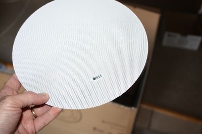

Once in place, the metal grille easily snaps in place via hidden magnets. Each grille comes with a small KEF logo pin that can be removed, if so desired. Since the grilles are held in place with magnets, it is very easy to rotate and position the grille with the logo exactly as you please.

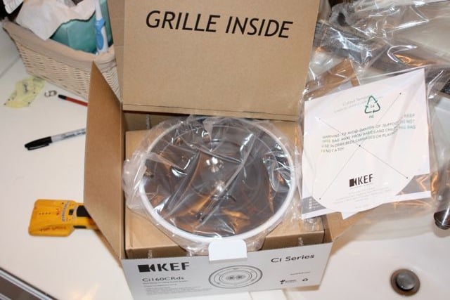

KEF Ci160CRds Speaker - Master Bathroom
For the rather small master bathroom, KEF suggested we try their stereo speaker - the Ci160CRds. It is a close cousin to the Ci160CR's we used in the kitchen and great room, and shares the same dimensions. With the grille on, you cannot tell the difference, but underneath you will find what makes this speaker unique. Common for use whole-house audio applications, this speaker is comprised of a dual voice coil 6.5" woofer and a pair of .75 inch aluminum dome tweeters on a special asymmetrical tweeter island for a wider off-axis response, with KEF's "tangerine" waveguides. For a smaller room, such as this bathroom, this unit gives you "stereo" from one speaker.
As you would expect, installation was identical to that of the Ci130's & 160's. It was very quick and easy, especially since this ceiling was a bit lower than the other rooms. We centered the speaker on the ceiling of the room, which gives ideal coverage to the bath tub, shower and sink. The 160CRds has also been constructed with moisture-resistant fixings so that it can be installed in environments such as bathrooms or under eaves.

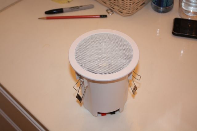

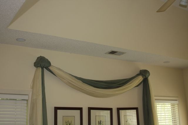

KEF Ci100QR Speakers - Master Bedroom

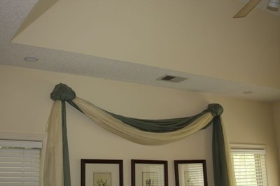

For the master bedroom, we decided to use a smaller, more designer-friendly speaker. This square room has a tray ceiling, and we felt that the smaller Ci100QR's would be adequate for coverage in the room, while providing a clean aesthetic to match the decor. KEF Designed these speakers to smoothly integrate and architecturally match existing downlighting sharing the same size bezel.
The Ci100QR's also differ from the 130's & 160's in that they come equipped with a 15cm deep detachable rear-can, which provides a sealed enclosure of 0.7 liters volume for optimum low frequency reproduction. Spring-loaded fixing clips allow installation in ceilings and walls varying in thickness. These speakers proved to be the easiest in-ceiling speakers we have ever installed. You hold the three clips up as you insert the enclosure into the ceiling, and as it pushes flush, the clips lock it snugly into place. It's literally a snap to install!
As for the speaker itself, the Ci100QR consists of a 4" polypropylene woofer with a .75" tweeter mounted at the acoustic center of the driver. KEF recommends amplifier power between 10 - 20 watts. With the can enclosure, the frequency range is 110 - 27kHz; without it is rated at 80 - 27kHz. These are 4-ohm speakers.
Listening Tests
There is certainly a trade-off when going for aesthetics over size in a speaker such as the Ci100QR. But for our master bedroom, this proved to be the perfect speaker. The two pairs allowed us to have a speaker near each corner of the tray ceiling, and made for plenty of coverage in the room. Most listening occurs at night when winding down, so our playlist usually consists of mellower music such as The Civil Wars. Their new release, Barton Hollow is almost all vocal and acoustic guitar, with piano and light percussion on some songs. Joy Williams' vocal on songs such as "20 Years" and "Poison & Wine" filled the room and as long as we didn't crank it up too loud, sounded nice. All of the speakers in KEF's Ci line displayed excellent high end that really shone when listening to singer-songwriter material.

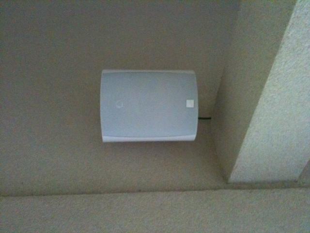

KEF Ventura 6 Outdoor Speakers and Conclusion

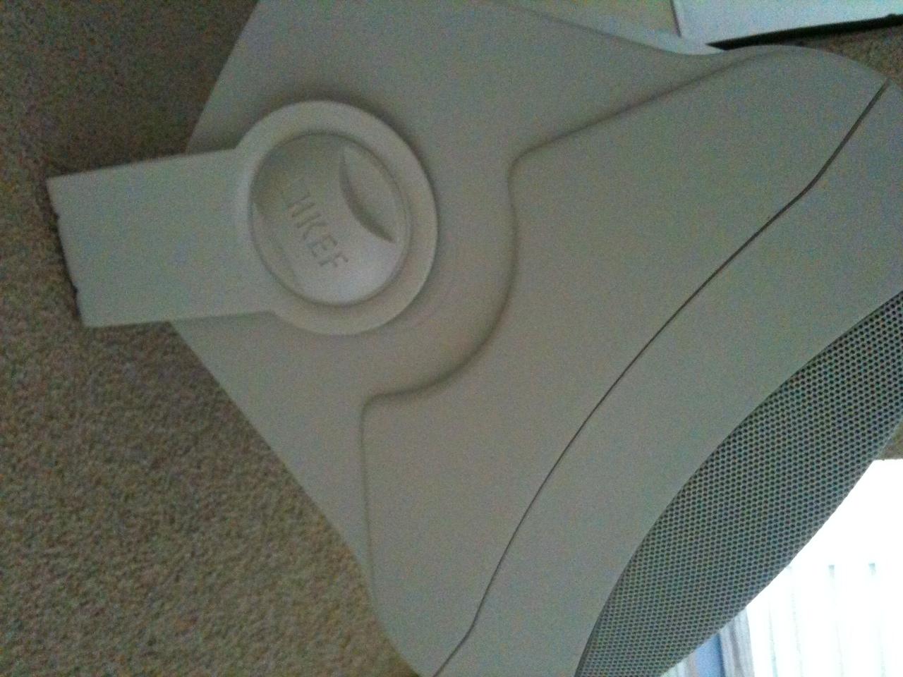

For the back porch, in-ceiling speakers would not work. The space has an A-framed ceiling and is a screened porch. We decided to go with the top end of KEF's outdoor line, the Ventura 6. The included bracket mount has 180 degrees of lateral adjustment for this speaker. Both the bracket and the grille are constructed from a robust corrosion-resistant aluminum. The cabinets also have brass threaded inserts to give you additional mounting options. The high-impact ABS cabinet is UV resistant and was designed to withstand the elements.
The sealed box cabinets measure 11.73 x 8.9 x 7.19 in. and feature a fluid cooled anodized aluminum dome tweeter which and a 6.5" injection molded, low-distortion long throw woofer with rubber surround. Each speaker weighs in at 8.4 lbs, and is available in black or white. The speakers boast a frequency range of 54Hz - 20kHz and are rated for amps from 10-125 watts.
For our installation, we used the included brackets to mount the speakers horizontally to opposite walls of the porch. Although installation was very easy, we noted that the included screws (large plastic, made to be hand-tightened) used to lock the speaker into place on the bracket would not prevent theft if you have these speakers mounted outdoors. It would take a would-be thief all of about 10 seconds to remove the speaker from it's mount. In KEF's defense, we have yet to see many outdoor speakers that are very theft-proof.
