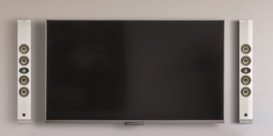

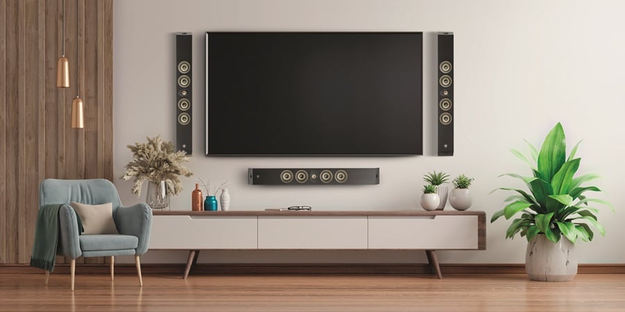

The Focal 302’s slim, modern profile blends seamlessly with flat-panel TVs, making it an excellent choice for most modern interiors. The speaker is available in White High Gloss and Satin Black finishes, both of which exude understated elegance. Dominated by flax fiber cones, the front of the speaker has a distinctive aesthetic that audiophiles will appreciate. For a cleaner look, magnetic grilles can be attached, ensuring a minimalist appearance without compromising sound quality.
OnWall302_Black
Mounting the 302 is straightforward, thanks to the included wall brackets. Its slim 3.9-inch depth allows it to sit flush against the wall, enhancing both the aesthetics and the bass response—a key advantage of its design. Focal also offers high-quality floor stands for the 302 and 301 models, allowing them to be used as traditional in-room speakers. This option is ideal for contemporary environments where wall mounting is not feasible or preferred.

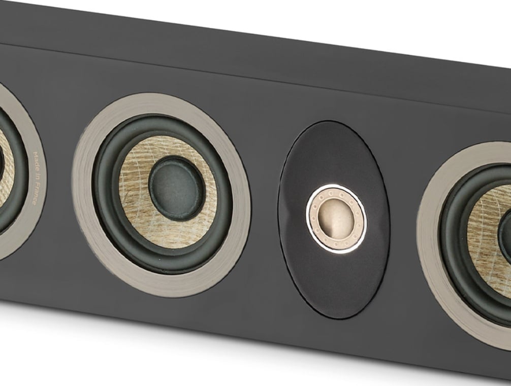

The Focal 302 is a 2.5-way on-wall speaker engineered to deliver audiophile-level sound while maintaining a compact and elegant form factor. Its driver arrangement and advanced materials demonstrate Focal’s commitment to performance and innovation.
302 drivers
Tweeter:
The 1-inch inverted dome aluminum-magnesium tweeter delivers exceptional clarity and detail. Known for its excellent dispersion characteristics and low distortion at high frequencies, this tweeter design is a hallmark of Focal’s engineering expertise.
Mid-Bass Drivers:
The 302 features four 4-inch flax mid-bass drivers, arranged in an MTM (Midrange-Tweeter-Midrange) configuration. Flax, a natural material, provides a unique combination of rigidity and lightness, resulting in natural tonality and dynamic midrange performance. These drivers also deliver punchy, controlled bass that exceeds expectations for an on-wall design. The 302’s four x 4” midbass drivers give you roughly the surface area of a single 8” woofer.
Cabinet Design and Porting:
Unlike many on-wall speakers that struggle with bass, the 302 incorporates dual slot-style ports—one at the top and one at the bottom—to enhance low-frequency performance. The cabine is constructed from high-quality materials to minimize resonance and distortion, ensuring clean, accurate sound.

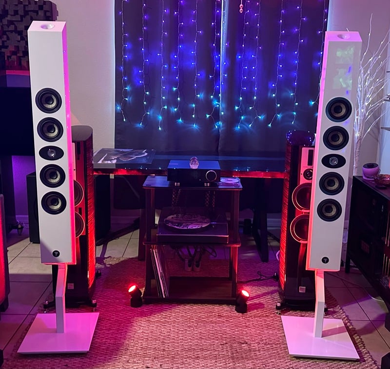

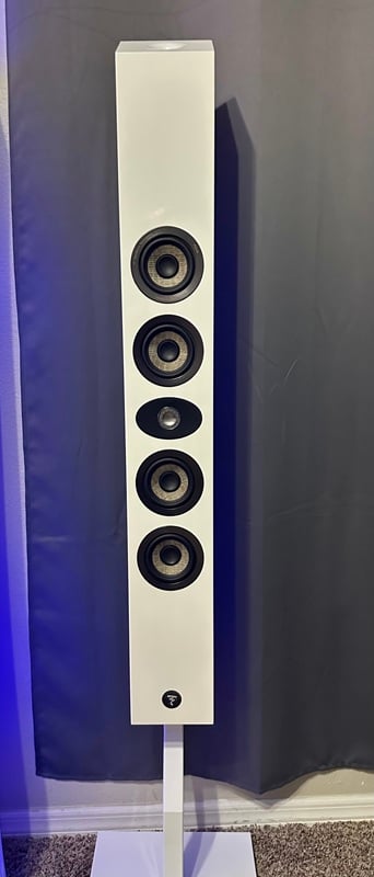

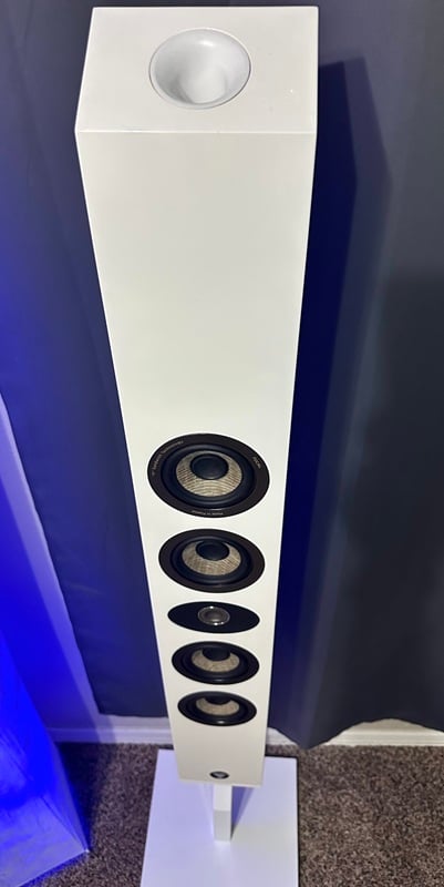

302 singleFor this review, I tested the Focal 302s in a 14’ x 18’ room. The speakers were mounted on Focal’s optional steel floor stands, positioning the tweeters at ear level for an optimal listening experience. This configuration replaced my usual Focal Kanta No. 2 towers, providing a clear benchmark for comparison.
The system was powered by the Yamaha MX-A5200 amplifier, delivering 150 watts per channel of clean, Class A/B power, and the Marantz AV7706 surround preamp, which ensured precise signal processing. For additional bass support, a pair of SVS SB3000 subwoofers were integrated into the system, crossed over at 80Hz for seamless low-end extension.
Sources included the Oppo BDP-103 Blu-ray player for movies and the Apple TV for streaming Atmos content. For music, I utilized the HEOS app to stream high-resolution tracks from Tidal, as Qobuz is not yet available on the platform. The system was calibrated to provide a balanced and immersive listening experience, ensuring the Focal 302s were evaluated under ideal conditions. Listening sessions were run in stereo, running the 302’s full range without subs, then crossed over at 80hz with the SB3000’s engaged. This would prove to show a true picture of the speaker's capabilities, good or bad.

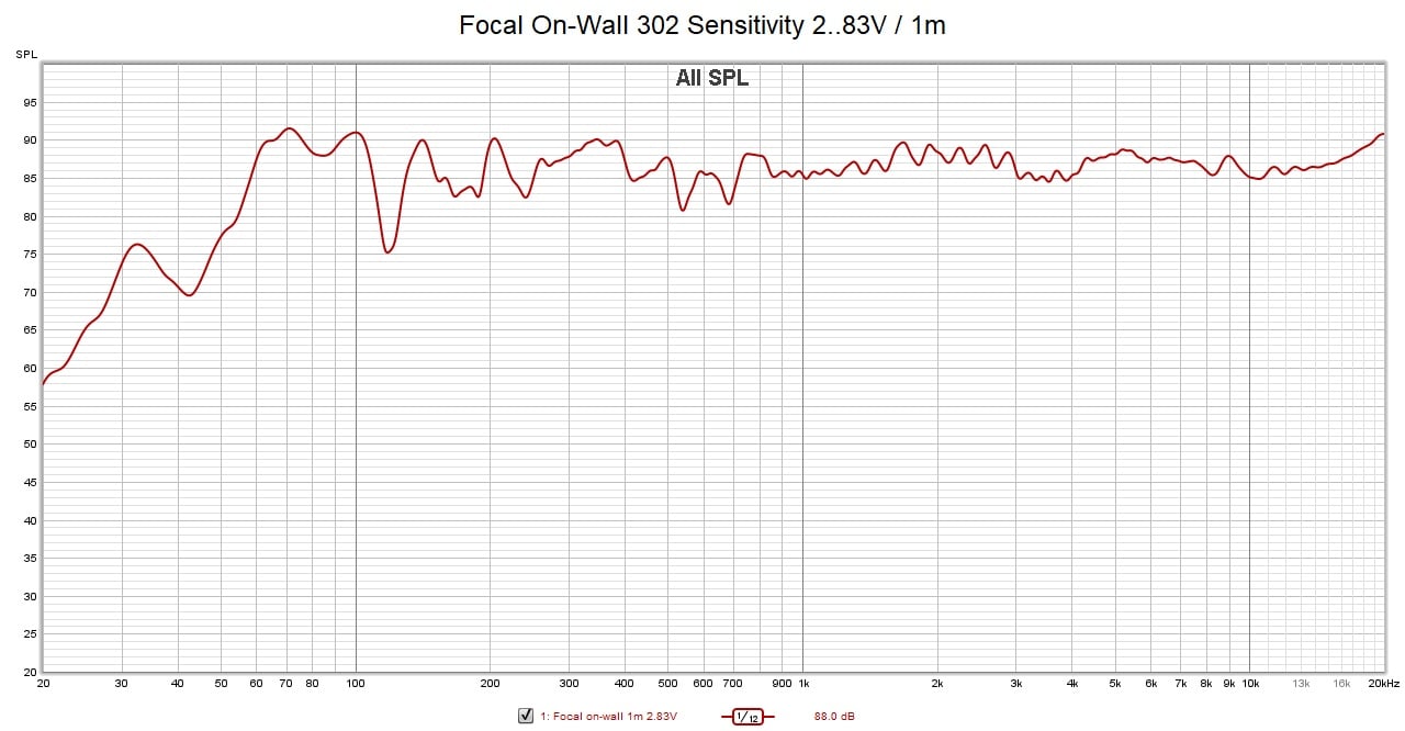

Focal claims the 302 On-Wall speaker has a sensitivity of 91dB, but their specification is vague, as it does not specify the bandwidth, input signal, or measurement distance. I can only assume they mean 2.83V/1m, but my measurements yielded approximately 88dB from 300Hz to 3kHz, following the IEC 60268-4:2018 standard.
Focal-302-sensitivity
Focal On-Wall 302 In-Room Measurement @ 1 meter
This is a pretty impressive in-room measurement as you can see the response is very linear above the room modal region (200-300Hz). The tweeter level is set about 2-3dB hot but that’s easily adjustable with some EQ and in fact may be preferable considering this speaker will go up against a wall and will get further bass enhancement as a result. Usable bass extension is around 50Hz as specified by Focal. That’s impressive for an on-wall speaker with quad 4” drivers.

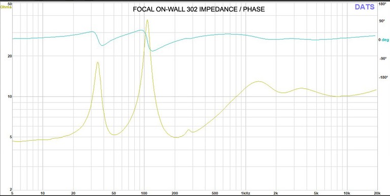

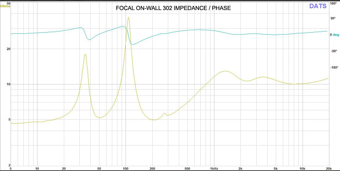

focal-impedance
Focal On-Wall 302 Impedance/Phase
Focal specifies the On-Wall 302 speaker as 8 ohms, with a minimum impedance of 5 ohms. According to IEC definition, a speaker’s impedance must not drop below 80% of its nominal rating between 300Hz and 3kHz, which, in this case, would be 6.4 ohms. If I were nitpicking, I would rate this as a 6-ohm speaker, but given its relatively high sensitivity and smooth phase response, any modestly powered AVR should have no trouble driving it to satisfactory levels. The 302 is tuned to 50Hz, as indicated by the saddle points between the impedance maxima. The slight wiggle around 270Hz could suggest some port resonance.
