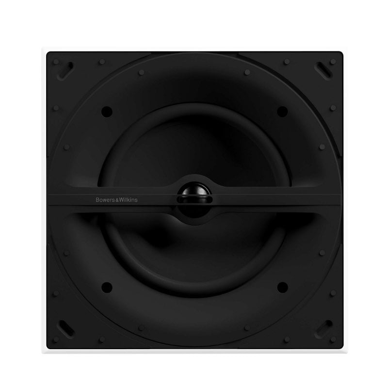

- Description: 2-way in-wall system
- Drive Units: 1x 160mm (6in) Polypropylene cone bass/midrange, 1x 25mm (1in) soft dome tweeter
- Frequency Range (-6dB): 50Hz - 30kHz
- Sensitivity SPL (2.83V, 1m): 89dB
- Impedance Nominal (min): 8Ω (5.0Ω)
- Power Handling: 80W
- Pre-mount Kit: PMK W6
- Back Box: BB 6W

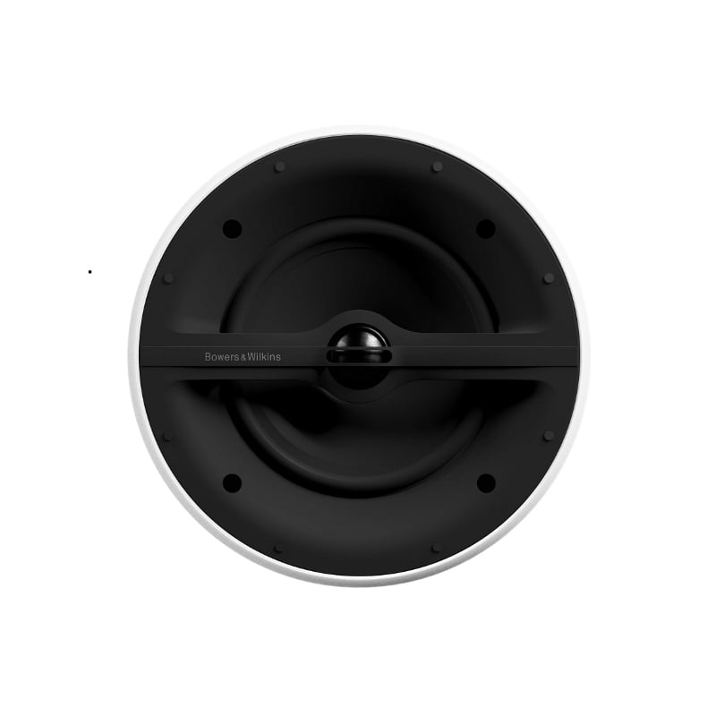

- Description: 2-way in-ceiling system
- Pre-mount Kit: PMK C6
- Back Box: BB 6C

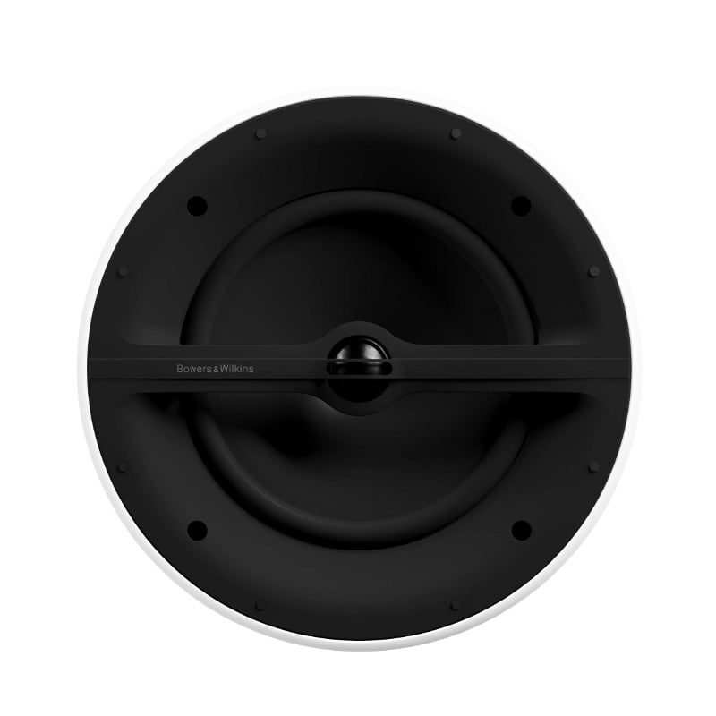

- Drive Units: 1x 200mm (8in) Polypropylene cone bass/midrange, 1x 25mm (1in) soft dome tweeter
- Frequency Range (-6dB): 45Hz - 30kHz
- Sensitivity SPL (2.83V, 1m): 90dB
- Pre-mount Kit: PMK C8
- Back Box: BB 6C

The CI 300 speakers come in three flavors - the in-wall CWM362 and the in-ceiling CCM362 and CCM382. All of the in-ceiling offerings are round but can use an optional square grille adapter to match in-ceiling lighting. The 62 offerings have a 6" polypropylene cone bass/midrange driver while the 82's have a larger 8" driver. All use a 1" soft dome tweeter. The in-ceiling offerings use a coaxial configuration while the CWM362 has a more traditional rectangular design (pictured above).
