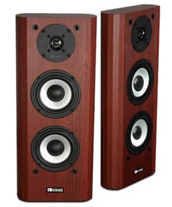

Some things are destined to happen. Celebrities are destined to get divorced, subwoofer's are destined to piss off neighbors, and Axiom was destined to extend their line of on-wall speakers. A while back we reviewed their Epic Accent M0 on walls which, at the time, were the only offering from the manufacturer for these type of products. We actually had a such an early version that they didn't even have logos on them. We were overall impressed with the speakers and the bracketing system. We figured it was only a matter of time before Axiom Audio extended their line of on-walls - and we were right.
Axiom has long had a reputation as a value leader. Internet Direct brands can be made or broken on word of mouth. That's why it is important to not only innovate but to maintain your level of quality. Axiom Audio has striven to do both with extending their speaker offerings to include in walls, hybrid in/on walls, in cabinet, and now on-walls. The Accent M0 speakers were actually branched off their computer speakers (at least they look similar) but their larger bookshelf speakers didn't have an on-wall equivalent. They do now.
M2OW     M3OW
M2 On-Wall                                                  M3 On-Wall

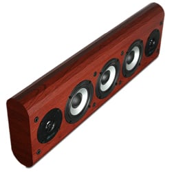

The Axiom line of bookshelves have included the M2's, M3's, and M22's for years. The M22's have long been considered to have a great value to performance ratio. All three of these speakers now have an on-wall equivalent. In addition, Axiom has created on-wall versions of their two center channel speakers - the VP100 and VP150. This will allow people that are looking for an entire on-wall system to have a dedicated, designed center. With the M0's it made sense to use one of the speakers as a center - it was perfectly timbre matched and small enough to easily place near a display. The larger speakers - especially the M22's - are a different story. They start to take up a lot of real-estate on the wall and it makes more sense to have a dedicated (and horizontally oriented) center.
VP100OW     VP150OW
VP100 On-Wall                                             VP150 On-Wall

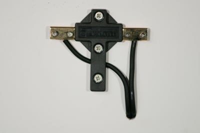

Axiom Power BracketThe M2, M3 and M22 on-walls are all ported. The VP100 and VP150 on-walls are not ported. The line-up comes with traditional grilles but we suspect that Axiom will make the move to magnetic across the board shortly. All the speakers are video shielded.   They are all listed on the Axiom Audio website with pictures and specs. Since the on-wall line-up was based on the hybrid in/on wall speaker counterparts the specs are similar (except for slightly less bass extension and efficiency for the on-wall versions).  All of the bookshelf speakers use the innovative Power Bracket combination wall bracket/binding post. We've had experience with this in our M0 review and overall like the way it works. Essentially, you wire to the bracket and slip the speakers on top. This holds the speaker flush to the wall (well, flush-ish) and makes the connection to the amplifier. Axiom has redesigned the bracket to address the few problems we noted in our M0 review to improve the security with locking mechanism, update the hardware and make it easier to align the speaker when attaching it to the bracket.
The center channels utilize the T-bracket long used by Axiom to wall mount their QS line of speakers. This makes sense as the Power Bracket is small and probably wouldn't hold the horizontally oriented speaker securely. With just one explosion played through one of their subs and the center would most likely come down. The T-bracket provides a very secure connection through it does mean that the VP100 and VP150 will need to be connected via traditional binding posts.
