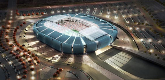

The new 63,400-seat University of Phoenix
Stadium was completed in 2006 for $455 million. There is fiber
installed throughout the new building which facilitates easy access and transmission of high definition video and uncompressed audio around the stadium. One of the advances made to the stadium presents a major drawback, however. Because the retractable roof panels don't allow the sunlight needed to keep the grass growing, the two acre playing field itself is
designed to roll out into the parking. It sounds simple, except that it takes 45 minutes to wheel out and another 45
minutes to wheel back in.
