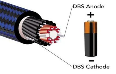

measured specifications or claim measurements don't matter. We recommend shying away from the stupid
products like the ones that slap a battery on the dielectric or must be
cryogenically frozen to reduce distortion or reach peak performance.

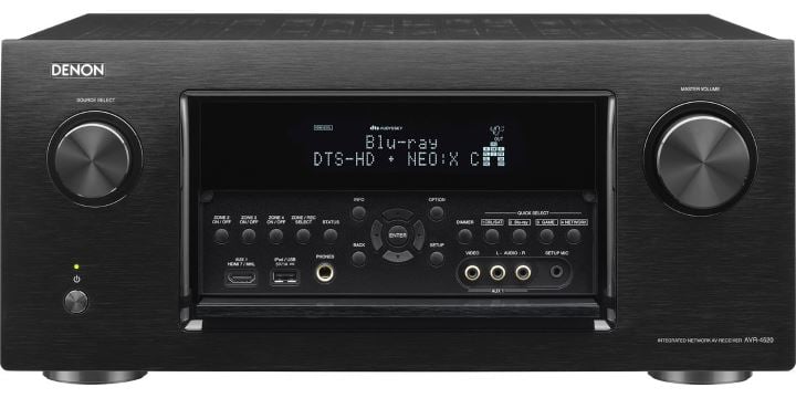

AV Receivers and preamp/processors are a different animal. You're dealing with a low margin high tech product where every penny counts. Want lots of power? Power costs money. Want state of the art processing and audio decoding and a sophisticated room EQ solution? Again this takes money. The quality of the DSP chips, DACs, power supply, etc are all meaningful metrics in building a good vs great AV receiver. Don't expect a $500 Denon AV Receiver to have the same caliber of performance as their $1k model. They typically don't. It's only when you get to the uber expensive units that you start seeing the laws of diminishing returns kick in. While we don't always recommend spending a small fortune on an AV receiver, we do recommend getting the next model up if the upgrade cost is marginal. The $100 difference between a unit with multi-channel preamp outs and one without is marginal at best. But it’s detrimental at worst if you later decide to upgrade your power and have to also upgrade your receiver because you opted for the model without this critical feature.

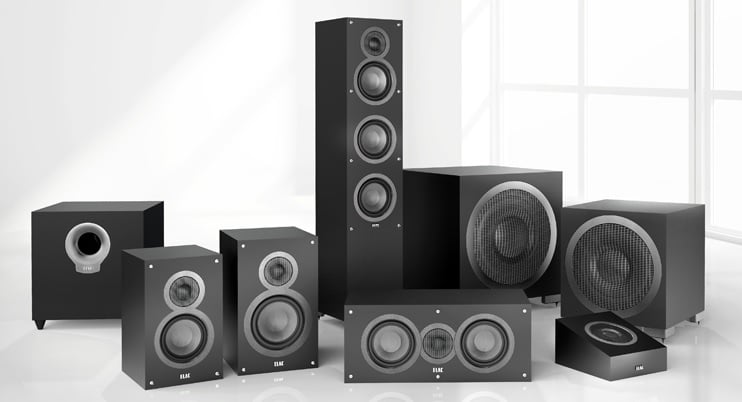

Price does matter with loudspeakers and subs at the very low end of the scale. For budget products, every penny counts when deciding on using the limited budget on quality drivers, crossovers and cabinet rigidity. Recently, we've found budget designs from the likes of Andrew Jones via his Pioneer and Elac speaker models squeeze out as much performance/dollar as humanly possible. Their cosmetics may be ho-hum but they employ parts that are NOT typical at their respective price points.
Elac Debut Speaker & Subwoofer Series

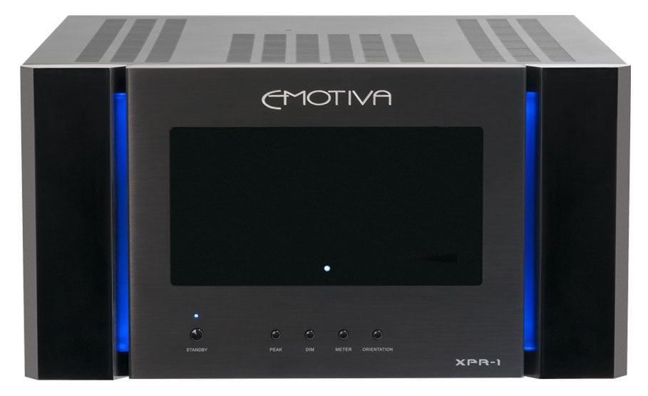

Emotiva XPR-1 Monobloc Amplifier
Amplifiers
Amplifiers are a lot like loudspeakers in that at lower price points, every penny counts. Heatsinks, power supplies, and high current output devices cost money. Inexpensive amplifiers can only be as good as the sum of their parts. As Scotty says "you cannot change the laws of physics". Recent developments in Class D amplifiers have allowed very respectable performance and output power in small and relatively inexpensive platforms but classic linear AB designs haven't changed much in modern times.
On the flip side, high dollar esoteric amplifiers can fall under the audio jewelry category. This is especially true if the company goes off on the deep end with their claims like "we don't use feedback in our designs." If you hear this, RUN, don't walk away from that amp. The designer obviously lacks the basic knowledge in amplifier design 101 or the company is flat out lying to sell a story they think an audiophile would want to hear because somehow feedback is labeled as a bad thing in their mind. Feedback is an essential part of an amplifier design that increases stability and ensures the amp will perform similarly under different loudspeaker loading conditions.
Outlaw Audio and Emotiva have really helped redefine the price/performance ratio but there are many B&M brands that are edging into this game these days now that they too are selling online. Power is cheap these days so buy as much as you can afford. You can never have too much power.

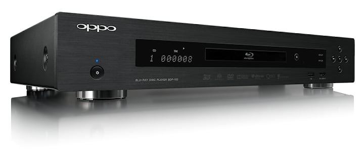

Before deciding on how much to plop down on a new Blu-ray player you need to ask yourself a very basic question. Are you using the player's analog outputs for critical high resolution audio playback or not? If the answer is NO, then don't waste your money on the audiophile players since you will be sending a digital signal through HDMI to your AV receiver or processor which will be doing all of the audio decoding. The D/A conversion stage is the single most important influence in how good a source component will perform. The audiophile players typically put in higher caliber DAC's and analog parts to yield better analog audio performance. In my personal theater system I use an Oppo BDP-105 instead of the BDP-103 ONLY because I have it connected to a separate two-channel rig where I utilize the analog audio outputs. Had I just been using my home theater system for two-channel playback, I'd have opted for a BDP-103 since my Denon AVP-A1HDCI has one of the best DAC's ever put into an AV Processor. Both Blu-ray players are similarly good for video and digital audio playback, but the BDP-105 is a higher caliber analog audio player which justifies its more than double price tag.
Even if you're only using HDMI of your Blu-ray player, I still do recommend spending a little more on a player that has good benchmarks for the video output and also has a speedy user interface, especially if you're planning on doing music or video streaming from Pandora, Netflix, etc.

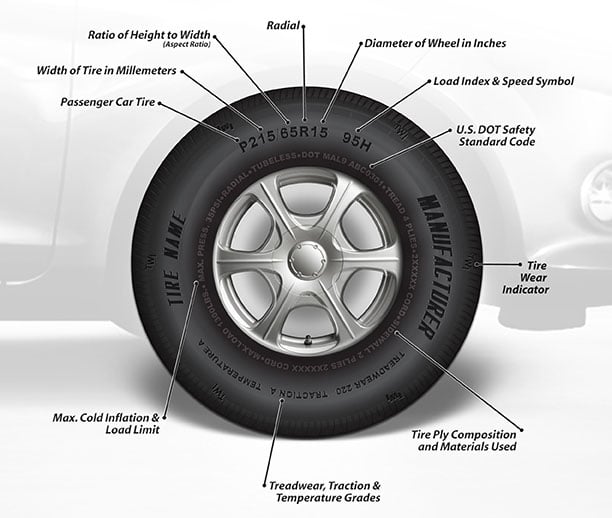

Use common sense when selecting equipment and don't fall for marketing nonsense to justify the higher prices of some esoteric gear. Price can matter with state-of-the-art loudspeakers and electronics but it's sometimes difficult to sift through what you’re really getting with some of the esoteric brands. Dr. Floyd Toole once said you can get more useful information off the sidewall of a tire than you could on most loudspeaker manufacturer websites. This is why it's imperative that you do your research, read our reviews, discuss with fellow members on our forums and most importantly, arrange for a demo whenever possible to see if the equipment meets your expectations.
