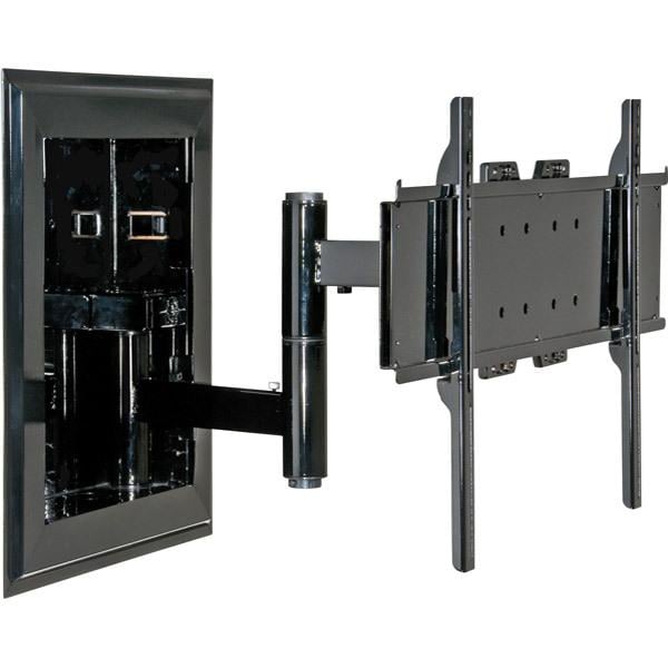

IM760PU-hardware.jpgI normally have a discussion on build quality that goes something like this: "The unit was amply constructed and seemed able to withstand the product it was designed for". In this case, I'm happy to report that the IM760PU is probably stronger than the stud wall you're putting it into. It's actually "overbuilt" if you can take that comment as a good thing (which is my intention). Because you are securing it into the face of twin studs with large lag bolts - and it applies ample side pressure between the studs themselves, this mount is actually able to hold up to 200 pounds. That's the rating, my guess is that it could actually handle 300, but we weren't able (or willing) to test that theory in the field. All required accessories are included in terms of nuts and bolts and the tools required to secure your cabling and get your display mounted. Since I ordered the IM760PU, this mount was suited for plasma televisions in addition to LCD displays - and the mount arrived in three separate boxes, all well-protected through the use of internal padding and packaging.
The IM760PU is designed to hold LCD and plasma displays from 32" up to 60" in size. There is even a model that is equipped to handle sizes up to 71". As you can guess, the construction is all steel, but what may surprise you is that the entire mount is coated in a scratch-resistant "fused" epoxy. I'm not sure of the exact process they utilize to make it, but it held up to our harsh installation environment (more on that later) and the high gloss finish provided an exceptional look to the finished product. It also comes with a flush-mount surround which covers the lag bolts used to secure the mount to the stud wall. Remember, this mount will be near-invisible when completed, so the fact that Peerless took so much care in providing a solid finish is commendable (and probably expected for the price).
What makes this mount unique is that it is designed to fit within the stud cavity of a wall. It comes with a left or right mount swing-arm that will allow you to manipulate a flat panel TV such that you can swing it out into the room and turn it left or right to "point" it where you need it. The articulating arm is made of steel tubing and the entire assembly is built well enough that you won't spend any time wondering if your flat panel investment is safe riding that far out from the wall.

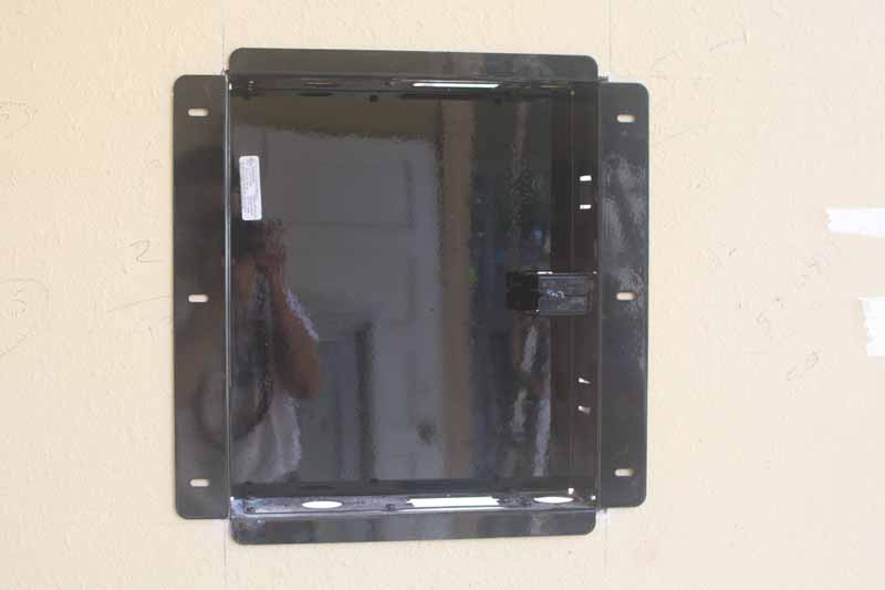

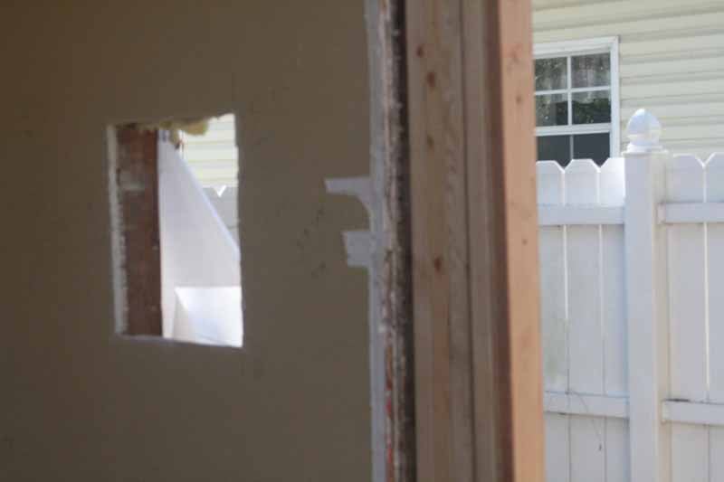

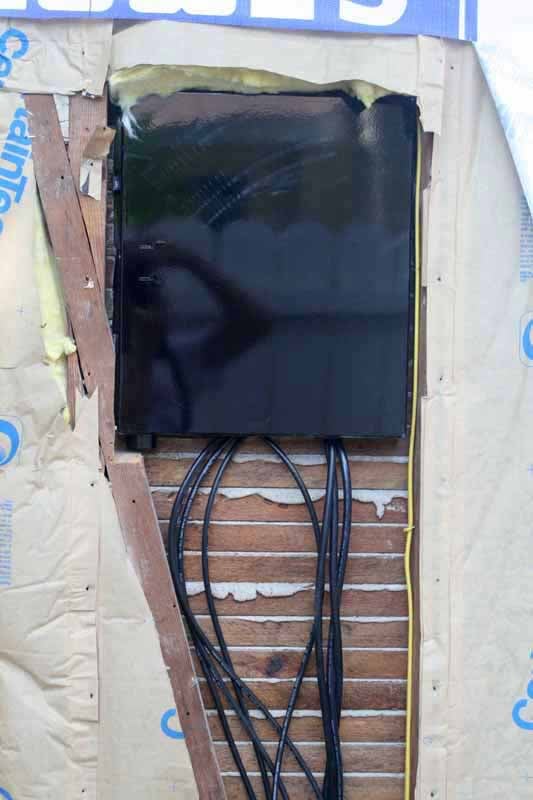

IM760PU-wall-hole.jpgWe decided to install the IM760PU during a recent renovation to a master bedroom. We had the opportunity to access the stud walls and place the flat panel mount and also run all of the cabling we needed to send digital audio and video signals to our flat panel TV. Since we also redid the siding of the home, we had a unique chance to view both sides of the IM760PU during the installation. It's rare that one gets such a universal perspective on a piece of hardware. We started out by finding the location of the studs. After that we cut out the hole per the dimensions provided by Peerless and rough fit the box.

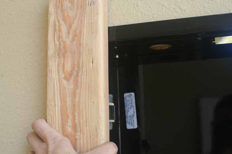

IM760PU-placing.jpgOnce we determined that the hole for the box was correctly made and that our studs were indeed the requisite 16 inches on center (and believe me - with these older homes you never know) we set the box in place and pushed it into the cavity. Before we pushed to hard, we had decided on placing the articulating arm on the right. If you notice, the mount has a welded piece that juts out from the center of one of the sides which holds the top of the articulating arm base. Place this box on the side you want the hinge to be located. Since it was a rather tight fit (by design) we used a piece of 2x4 to protect the mount while we tapped it into place with a hammer. The fit was perfect and we stepped back to appreciate the mount and the snug fit that made us feel even more certain that it was more than capable of holding our display (a 37-inch Panasonic LCD television we were reviewing at the time).

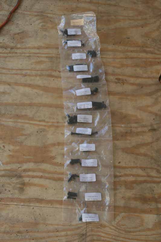

Once in place, we set the six lag bolts in place with a cordless drill gun and a Phillips bit. Pre-drilling the holes is recommended to avoid stripping out the heads - something that is quite easy to do when driving large bolts in old growth wood. Once completed there was no way this mount was going to pull out.

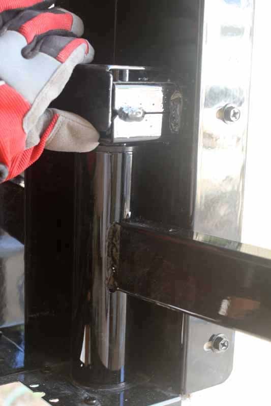

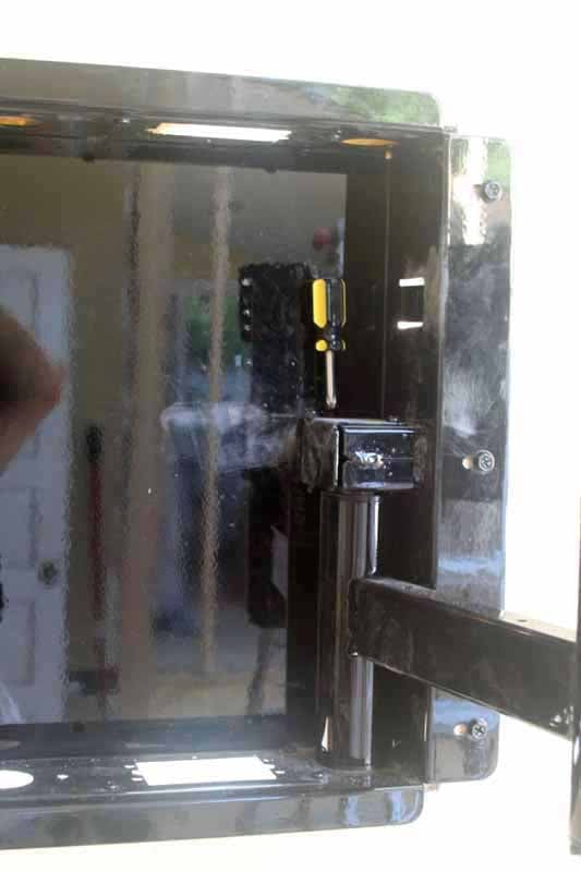

We placed the articulating arm into position on the right side of the mount. It was then a matter of securing it with the included bracket, screwing it down with a Phillips screwdriver. We quickly realized that a short screwdriver was needed as a normal-sized driver or cordless drill would be too long to fit into the enclosure above the bracket. While we had the correct tool handy, it would be good to include a right angle Phillips driver in the kit to ensure client installations doesn't stop dead in their tracks.

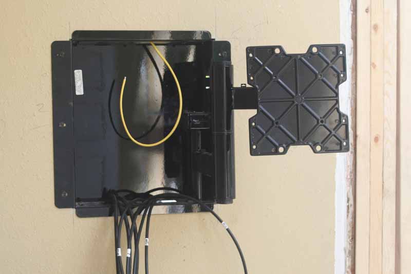

IM760PU-wiring.jpgPhysically, it's easy to install the mount, but what about wiring it up? Peerless allows installers to bring in wiring in a few different ways. First, they have two single gang cutouts, one on top and one on the bottom. There are also two circular cutouts for pulling additional cables. Peerless even includes a flexible cover that allows the cables to pass-through, but keeps the majority of the hole covered to minimize air loss to the wall cavity. In our installation we utilized both types of access points. On top, we placed a single gang plate with our 110V power which we wired using a dedicated feed of 12/2 from our panel. On bottom we used both the single gang box to hold a custom wall plate from DVIGear and the general hole to pass-through RapidRun HDMI cables from Cables2Go. When finished we had two nice Decora-style plates for power and most of our connections, while the RapidRun Digital HDMI and RapidRun component video cables came up and were wire-tied to the articulating arm. From behind we had a unique view of the box, which you won't often get in a typical installation:
Since power and low voltage cables came up within the same wall cavity, we were careful to separate them and staple the 12/2 electrical cable to the one side, while (not pictured) tie-wrapping and securing the low voltage audio and video signal cables to the other side.

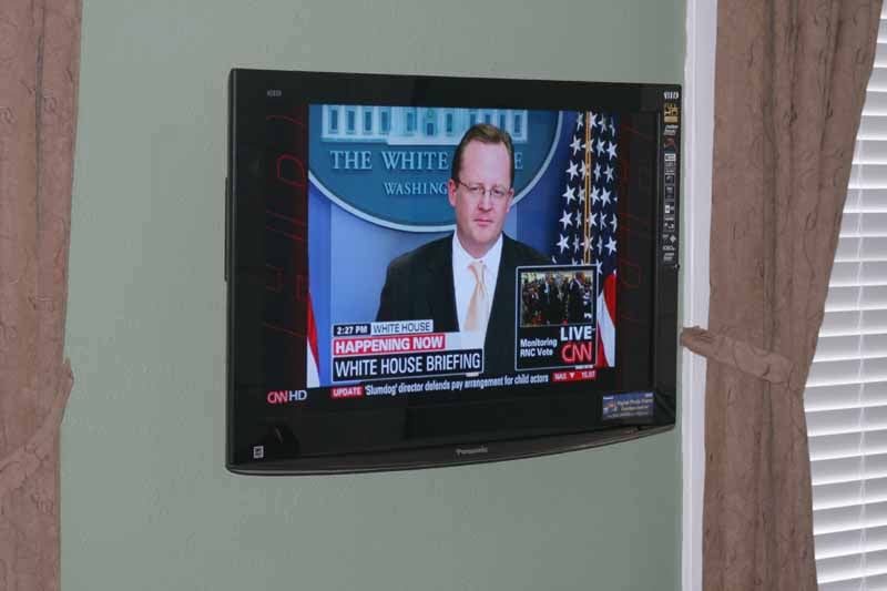

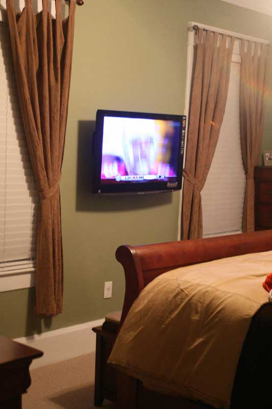

TC-37LZ800-angled3.jpgWe were extremely pleased with the results of our install, and the television we installed did indeed sit extremely close to the wall - only a few millimeters off due to the required plasma mounting hardware. All HDMI cables and analogue A/V connections were able to recess into the wall, giving us a very clean look that truly complemented the master suite. We experienced easy motion of the swing arm and could fully extend the television without binding the cables or feeling as if the television was in any way being impeded by either friction or the cabling. In fact, it took only one finger to manipulate the TV around the perimeter of the articulating arm's full range of motion.
