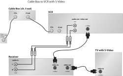

Step by Step: Connecting a Cable Box (RF Input/Output Only)
1analog_cable_box_th.gif Old fashioned analogue cableTV box use only a coaxial/RF (cable) input and output. This creates a challenge for integration into your home theater system. You must use another piece of equipment such as a stereo TV or VCR to separate audio and video for use with your home theater receiver. You'll need two (2) coaxial/RF cables, a stereo pair of RCA cables, a composite or s-video cable (preferred if s-video is available), and either a stereo TV or VCR.
  1. Using one of the coaxial/RF cables, connect the wall jack to the coaxial/RF input of your cableTV box.
  2. Connect your cableTV box's coaxial/RF output to either the TV or the VCR's coaxial/RF input.
  3. For Home Theater Receivers (audio): Using the RCA cables connect (the TV or VCR's) left and right audio output to one of the home theater receiver's stereo inputs.
  4. For Home Theater Receivers (video): If you have a video output, connect the video cable to the receiver's corresponding video input as in the diagram shown (click to enlarge). Then connect the receiver's video output to your television.
Note: If you desire audio output from your TV when the receiver is powered down, we recommend connecting your cable TV/satellite box's RF output to the RF input of your TV.
Step by Step: Connect a Digital CableTV Box or Satellite Receiver
[DigitalCATV] The next-generation cableTV/satellite boxes added the ability to automatically send audio and video signals to a dedicated home theater receiver. Some even added digital audio ouputs (mostly for satellite boxes). This guide deals with composite and s-video conenctions. If you want to use component video connections, skip down to the Digital HD CableTV/satellite box wiring guide below.
  1. Using a coaxial/RF cable, connect the wall jack to the coaxial/RF input of your cableTV or satellite box.
  2. Connect your audio and video (composite or s-video) output jacks directly to available inputs on your home theater receiver.
  3. For VCR Recording: Connect a pair of RCA analog audio cables and one composite/s-video video cable from an unused output of your receiver to the respective inputs of your VCR.
