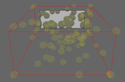

“Objects” can be surround panned in space on all three axes (front/rear, left/right, up/down), as well as given a size. The Metadata defines where the objects are positioned and how big they are in time. In a normal surround environment, these surround pans are transformed to output levels in the classic 7.1 mix channels. Conversely, objects are “rendered” by the Atmos engine; up to 128 different elements (9.1 bed channels plus 118 objects) can be rendered to the actual number of speakers the system has available, up to a maximum of 64 individual speaker feeds in a commercial cinema.
Atmos Object Audio
Illustration of object audio in Dolby Atmos.
The end result of all this is a more involving and pinpoint accurate experience than conventional 5.1 or 7.1 could ever offer. Instead of effects simply appearing behind or beside you, Atmos delivers a three dimensional reproduction of effects such as an airplane flying overhead, the utter sonic immersion of being in a jungle, or something as simple as the rain falling.

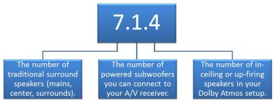

Dolby Atmos: what the numbers mean.
Before answering that question, it’s important to understand how Atmos will be delivered in the home. Atmos content will not require a new codec. Instead, it will take the form of extensions within the current Dolby TrueHD and Dolby Digital Plus codecs. As such, while you will need a new A/V receiver to take advantage of these extensions (older models will simply play the base TrueHD/Digital Plus content), Blu-ray players that fully conform to the Blu-ray specification will support Atmos without requiring a firmware update. Moreover, despite what cable salesmen might state in the future, you don’t need new HDMI cables either.
your current Blu-ray player supports Dolby Atmos with no firmware upgrade required.
What about the speakers? Atmos in the home supports up to 24 speakers on the floor and 10 overhead speakers (34 speakers total), and Dolby has noted that one partner is already planning on releasing a 32 channel A/V receiver to take advantage of this expandability. However, you don’t need a room full of speakers to benefit from Atmos. Currently, the options are largely limited to 11.1 channels of audio, with a few different configurations options to consider.
Dolby Atmos Speaker Configuration Options for Home Theater
  • 5.1.2: A standard 5.1 setup with a pair of “middle” in-ceiling/ceiling-mounted speakers.
  • 5.1.4: A standard 5.1 setup with a front and rear pairs of in-ceiling/ceiling-mounted speakers.
  • 7.1.2: A standard 7.1 setup with a pair of “middle” in-ceiling/ceiling-mounted speakers.
  • 7.1.4: A standard 7.1 setup with a front and rear pairs of in-ceiling/ceiling-mounted speakers.
  • 9.1.2: A 9.1 setup utilizing front wide channels and a pair of “middle” in-ceiling/ceiling-mounted speakers.
