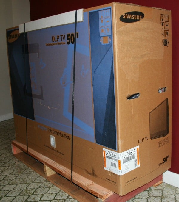

HL-T5087S_inbox.JPGI've reviewed a number of flat panel LCD and Plasma displays from 42 to 50 inches and I can tell you this - moving the Samsung HT-T5087S was a joy in comparison. At only 63 lbs, I could easily lift it and place it on my component cabinet. I wouldn't recommend it, but I could do it. It was well-packaged (strapped down to its own half pallet, no less) with the appropriate amount of protection. I prefer to see these displays double-boxed, but for all intents and purposes, it's probably a useless gesture. What exactly is that one extra layer of cardboard supposed to do anyway?
My first impressions were all very positive with the huge flat screen bordered by an impossibly thin edge and the trademarked Samsung logo and power button on the bottom-center of the unit. The little cut out just below that serves not only as a place to reflect the accent light, but also the sound from the speakers. The right side of the unit has all the inputs and outputs with the removable power cord located just around the corner on the rear of the unit. The HL-T5087S has two full HDMI inputs and one HDMI/DVI input (made to be used with a DVI source - also has analogue audio inputs), 2 component video and analogue audio inputs, 2 composite video and analogue inputs, and one composite output with analogue and optical audio outputs. You should be set for connections except that there is no way to get audio to the unit digitally except through the HDMI inputs. I'd like to see a coax or TOSLink input as well.

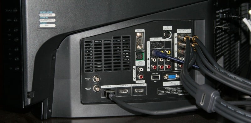

HL-T5087S_input.JPGNow, if you want to connect up a PC, they've also got you covered with a VGA input and an audio jack. RS-232C is present as is a USB input for portable media such as MP3 files (man, does EVERYTHING play MP3's these days?) and jpegs and movies. Personally, the USB would do better on the front of the unit as many installations are looking to hide the majority of the display, making the side less than accessible. A little door would make it all but invisible.

If you've set up one display you've set them all up - at least as far as connections go. I ran a single HDMI from my receiver to the HL-T5087S, a pair of component cables (for my Xbox 360 and from the Denon DVD-3910), and a composite cable from the receiver "just in case". Hey, don't mock it. In my business, you can always count on that composite to work when everything else fails (thank you, HDMI). Everything on the panel is well laid out and separated so you shouldn't have much of a problem. I wouldn't mind seeing the outputs separated from the inputs (they are mixed in currently) though this is really a minor gripe.

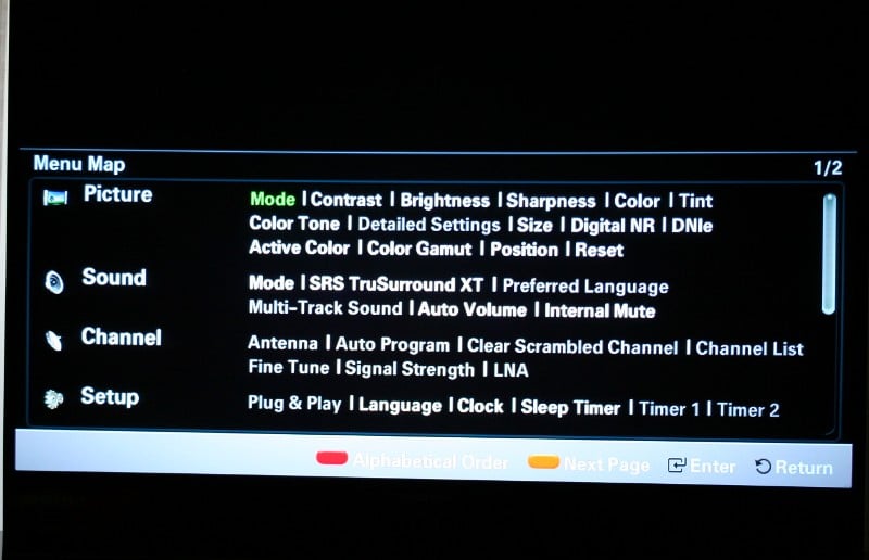

HL-T5087S_menuMap.JPGUsually I like to start from the first menu and work my way through. This time, however, I really want to mention a particular menu fist. The very last menu item is the Menu Map. This has every one of the menu items on 2 pages. Each of the options is listed with the active and available ones in white and the unavailable ones in gray. This is an immensely helpful menu, not just for the reviewer that is looking for a quick list of all the menu items, but also for the user that doesn't want to search for a particular setting that they can't quite remember the location of. Once you select an item and hit Enter, you are immediately taken not only to the correct menu screen, but your cursor is placed directly on the item of interest. This is probably the best thing to happen to menus in a long time. Of course it isn't graphically pretty or nearly as intuitive as the other menus but it has the advantage of putting nearly every item on a single page. Once you've used the display enough, I imagine this might become your preferred method of navigation. I'd love to have to option of having this menu as the default menu rather than the Picture menu.

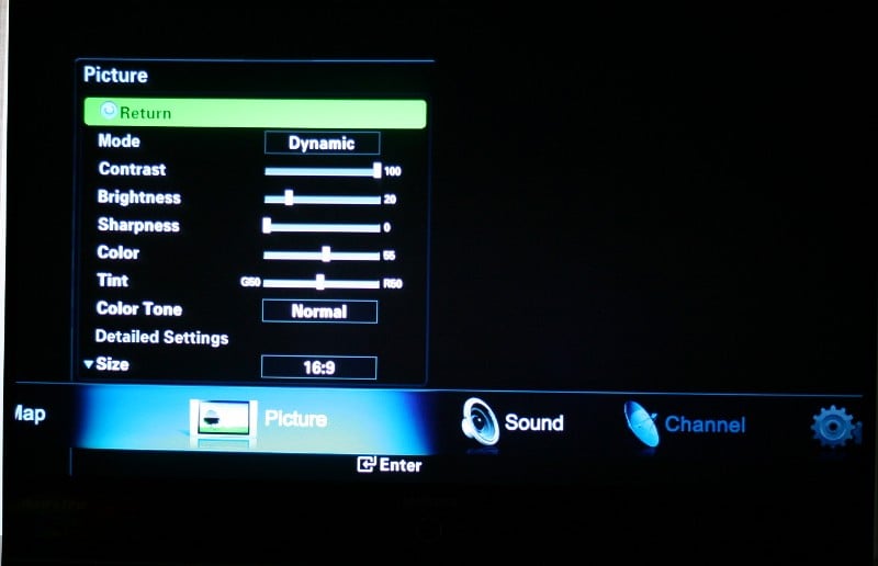

HL-T5087S_menuPic.JPGThe Picture menu has all the adjustments to calibrate the look of the set. You'll notice some old standards like Contrast, Brightness, Sharpness, Color, and Tint. You can choose the Mode (Movie, Standard, or Dynamic) and make adjustments to each. Those adjustments are retained for each of the settings so if you are routing your video to your display through a single HDMI cable, you can flip the settings easily if you wish. Color Tone gives you the choices between Normal, Warm1, Warm2, Cool1, and Cool2 (Warm1 and 2 are only available under the Movie mode). You can also choose the size of the screen (16:9. Zoom1, Zoom2, Wide Fit, 4:3, or Just Scan). Depending on the incoming signal, some of these options will be grayed out (you can't zoom on a 1080p signal for example). Digital Noise Reduction can be set from Off to High (with Low and Medium in-between) or Auto. Under Color Gamut, you can choose Wide (full color spectrum of the display), Normal (described as a "flat and natural" color tone), or sRGB.
The DNIe (Digital Natural Image engine) is an interesting little setting that you can only adjust on Dynamic or Standard modes. It is designed to give you a more detailed image with detail, contrast and white enhancement. What I really liked about it was that it had a "Demo" mode where it would show you the difference between the on and off settings on each side of the screen. Letting the Demo run while some casual viewing, it was obvious that the DNIe "on" side definitely had blacker blacks, more saturated colors, and greater contrast. It'd be nice to see other menu items with a Demo mode to make it easier for the user to more decisively select their preferences.

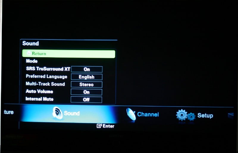

Sound menu
HL-T5087S_menuSound.JPGLike many sets, the HL-T5087S has a version of DSP-enhanced audio to simulate surround. TruSurround XT (which is most likely neither "tru" nor "surround") can be activated from this menu as can Automatic volume control (correcting for overly loud commercials) and Internal Mute (for those of you who prefer to use real speakers). If you are running your antenna, cableTV or satellite directly to your display you can also choose which language and track type (SAP, Stereo, Mono) when available. There is a "Mode" selector with a 5-band equalizer with 10 up and 10 down settings at 100, 200, 1000, 3000, and 10000 Hz and a balance control. You have the choice of Standard (flat), Music (100, 3000, and 10,000 bumped up a bit with the rest down), Movie (100, 300, 1000 bumped up ad the rest down), Speech (100 bottomed out, 300 bumped down, and the rest a bit higher than flat), and Custom (you can set yourself). Of course, you can adjust each one of the predetermined modes and there is a Reset button on the bottom if you don't like your adjustments (the Reset only applies to the mode you're on and not any of the others).

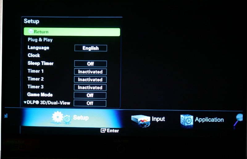

Setup menu
HL-T5087S_menuSetup.JPGFrom the Setup menu you can select the menu language (English, Spanish or French), set the clock time, sleep timer, set timers for the set to go on and off at specific times (so the dog has something to watch I suppose), set the menu transparency, and look for a software update on a USB key (don't mess with this unless you are serious - it resets your display to factory defaults even if you don't do an update). Know that funky light that shines just below the big power button on the front? You can adjust that from this menu as well - standby only, watching only, on, and off. There are other interesting settings like Color Weakness which allows you to calibrate for a personal color deficiency in your eyesight. You can basically boost Red, Green, or Blue (and any combination thereof) up to nine times. Game Mode is available from this menu as is enabling the 3D mode.

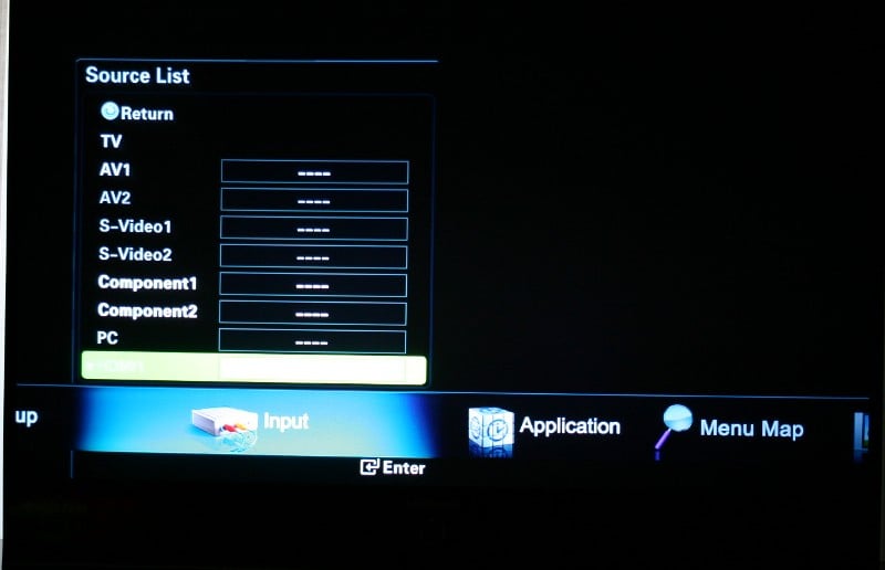

Input and Application menus
HL-T5087S_menuInput.JPGThe Input mode is pretty limited to selecting which input you'd like to view and renaming each input. Unfortunately, they don't give you a keypad to use but make you choose from a list. The list is fairly comprehensive but is generally limited to a single source per input. Honestly, I wanted to label HDMI 1 (my main connection for both my cable box and DVD player) something like "This is the one, honey" to make things easy on the wife. That wasn't on the list. What I was on the list were things like VCR, DVD, Satellite STB, TV, and less common selections like Internet TV Recv., PC, Game, and Camcorder. The Application menu lets you access information on a USB drive like JPEGs, movies and other content through an application called WISELINK. WISELINK lets you view rotate or zoom pictures, view a folder's contents as a slideshow, and even select an MP3 on the drive as background music during the slideshow. And since toasters these days are playing MP3s, so is the HL-T5087S.
One of the things that I really liked about the HL-T5087S is how they optimized it for use with a HTPC (home theater PC). There is a VGA port on the back and a whole list of menu items specifically geared toward maximizing your PC experience. Obviously, the 3D gaming functionality is marketed toward people that are using this DLP with a computer, but being able to select your specific resolution, horizontal and vertical frequency, and horizontal and vertical polarity can be a huge plus.

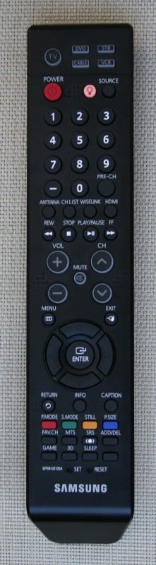

Remote Control
HL-T5087S_remote.JPGThe remote provided with the HL-T5087S is long, thin and black. The Backlight button (inconveniently placed near the top but in the middle of a bunch of buttons) only illuminates the control button (lets you know what component you are controlling), the Channel up and down buttons, the Mute button, and the Volume up and down buttons. Not a one of these buttons ever interested me in the dark. Buttons like source and aspect ratio would have been much more useful. Also useful would have been a button for each source instead of just a source scrolling button. To be fair, there was a button that brought you straight back to the HDMI input (thanks for that) but it was nearly impossible to find in the dark so I almost never used it. The aspect ratio button (labeled P.Size) was also nearly impossible to locate (even with the lights on). The remote was unresponsive with at best only 2/3rds of my commands going through with often less than 1/2 registering. You can program this remote to control other devices though I don't know why you would.

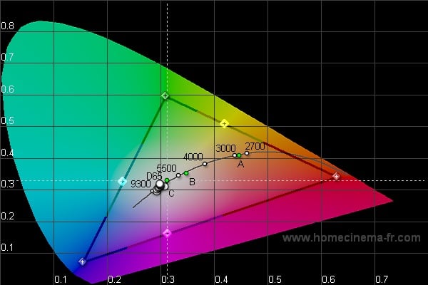

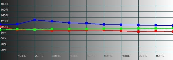

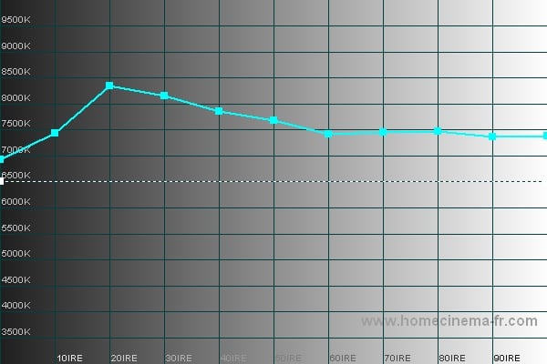

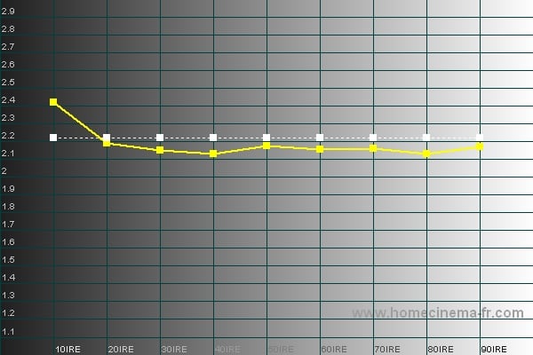

Calibrating this set was a bit of a pain. I'm using both the Sencore ColorPro5000 and Colormetre HCFR software. Basically, Sencore is great for calibrating your set but doesn't give you the pretty graphs that we like to show in our reviews. That's where Colormetre comes in. Well, when I went to measure the color temp of the default settings (Dynamic and Standard) with Sencore, all I got was N/A. Thinking that was weird, I tried the Colormetre which has a bit of an adjustable scale. Still nothing. Finally, I tried Movie mode and got about 7500k (not a bad reading before calibration) which means that my measurement tools were in fact working. It seems that the blue is so far off that it is reading somewhere above 15000k! Now that is high! In essence, the picture has an overall washed out appearance with a slight blue tinge. Seeing how far out the blue measured, I couldn't help but wonder if the LED technology was somehow affecting the reading. Contrast ratings were very good (Dynamic was so bright that in a dark room you'd find yourself squinting from time to time) with a post-calibration contrast ratio of 1100:1 on movie mode with a color temp of 7500k.
Dynamic - over 15000k (2200:1 contrast ratio)
Standard - over 15000k (1750:1 contrast ratio)
Movie - 7500k (1100:1 contrast ratio after calibration)
Calibration options were very limited on the HL-5087S with basic Color and Tint controls only augmented by a "My Color Control" screen under "Detailed Settings" under the Picture menu (got it?). Unfortunately, there were no Low/High gain and cut controls for Red, Green, and Blue like we would expect. Instead we found more nebulous controls for Red, Green, Blue, Yellow, and Pink that had no discernable affect on the picture either by eye or through measurements. Essentially, you are stuck with the Movie mode/Warm 2 setting for best evening viewing. I could find little effect of any of the "Detailed Settings" options leading me to believe that it is a menu that is used on other displays but disabled for this one. I ended up with these settings:
Mode - Movie
Brightness - 20-35 (depending on lighting conditions)
Contrast -
90 (default)
Sharpness - 0
Color Tone - Warm 2 (default)
Color Gamut - Wide (default)
And these measurements (with no real work on my part):
CIE (left); RBG Levels (right)
Color Temp (left); Gamma (right)
It's not all that surprising that you'd want to use a different brightness setting depending on the lighting conditions in your room. What we usually suggest is that you use the Movie mode for your nighttime viewing and adjust one of the other settings for your daytime viewing. Unfortunately, you don't have a lot of control over the calibration of this display (meaning you'll have to call someone to get into the service menus for you to make those adjustments) so you can't do that. Your only real option is to remember to adjust the brightness for each lighting condition or to live with one of the washed out, bluish, and overly-bright Standard or Dynamic settings for daytime viewing. What I did was to live with the Dynamic setting after bumping the brightness way down and engaged the DNIe setting (which I felt gave a bit better saturation to the colors and blacks as well as counteracted some of the blue). It wasn't as good as changing the brightness on the Movie mode on Warm2, but it was easier and I tended to fiddle with it less (lowering considerably the amount of family tension in the house).

HDMI defaults to Dynamic
All these calibration and settings I've been talking about? Well, every time you turn the set off or change an input, the HDMI switches back to Dynamic picture mode. It remembers any changes you made to the Dynamic setting (or any of the other settings) but you'll be right back to Dynamic. Annoying? Oh yeah. What was really weird, it that it didn't do this to any of the other inputs.
Substandard remote
The remote just doesn't seem to work all that well. Sure the backlight is useless but if the display does what you say at the time you say it, that makes up for it doesn't it? In this case, only 1 out of every 2 or 2 out of ever 3 commands was recognized. Not to mention the lack of individual buttons for each input… well, substandard pretty much sums it up.

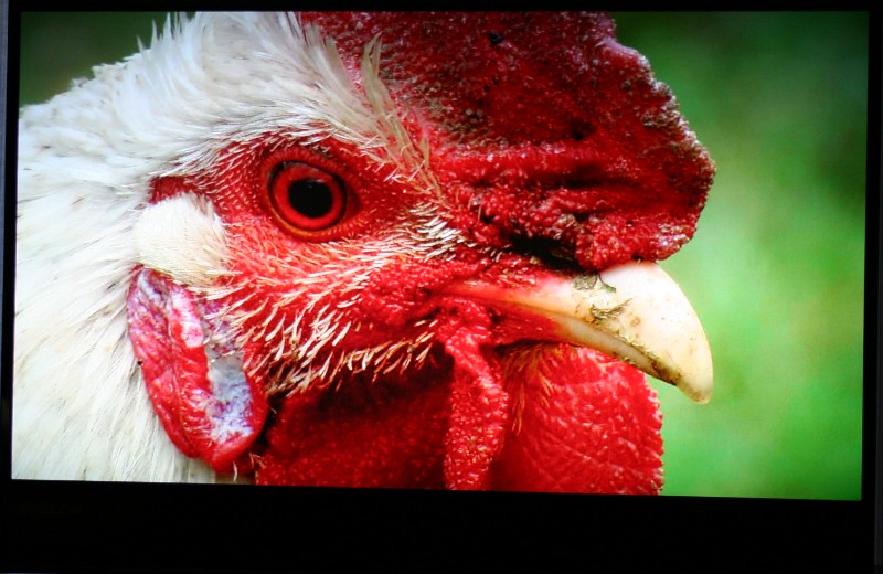

The HL-T5087S puts out a fairly spectacular picture especially in regards to brightness and color reproduction. The blacks are truly black (especially when comparing to some of the early LCDs on the market) and the use of an LED lamp ensures both an increased bulb life expectancy and an apparent lack of rainbow effect (since it eliminates the need for a color wheel and speeds up the single-chip color transitions). I was actually a little disappointed that I wouldn't have a chance to experience rainbow effect. This is the first DLP product I've spent a considerable amount of time with and I'd hoped to be able to complain about it like some of my reviewer friends.
One of the first things I noticed was a really limited viewing angle. I sit about 10 feet away and my eyes were positioned about 1/3 of the way up the screen from the bottom. From this position, I could see a bit of a shadow on the top corners of the screen. While not distracting, it was clearly visible especially when you moved your head. Over the evaluation period, I got used to it and I don't think it seriously distracted from the viewing experience, but it was there.

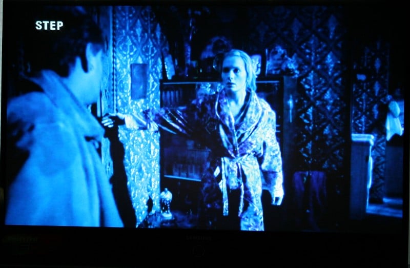

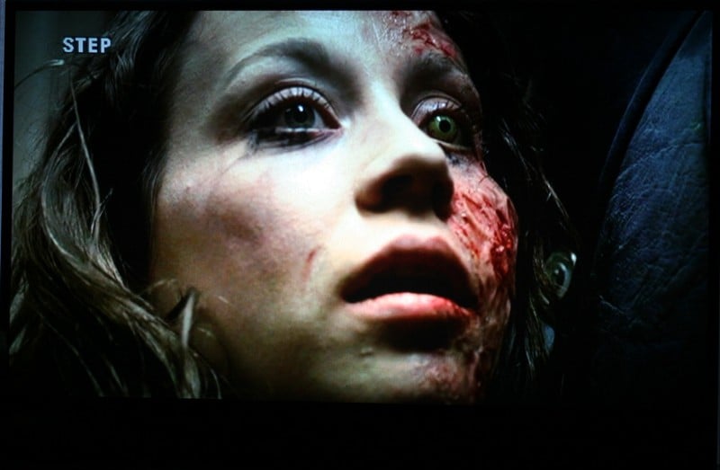

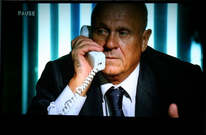

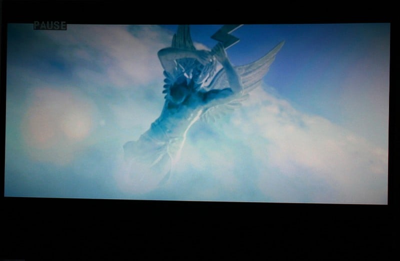

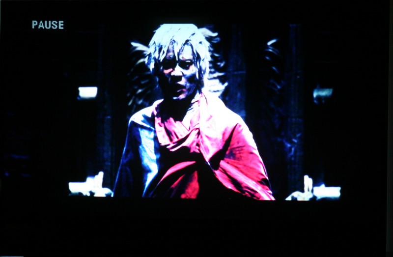

DVD: Nightwatch
This review is filled with movies that I rented because of recommendations from people on the Audioholics forum or listeners of AVRant. Nightwatch was the former. A Russian movie, this transfer had the distinction of being the only foreign language movie I've ever heard of that didn't have a language track in the original language (English, French, and Spanish only). I had heard that the original had done some interesting things with the subtitles that I was looking forward to checking out. Unfortunately, none of that made it into this transfer. The movie itself is sort of a Russian version of Underworld (with the uber-hottie Kate Beckinsale replaced with some weird looking Russian guy that keeps getting his butt kicked). I can't say I loved this movie or even really understood all of it, but I blame that on the English language transfer. This movie is filled with dark scenes and subdued colors. The Samsung HL-T5087S did a great job with all the blacks while still being able to render the detail in the backgrounds. When there was color on the screen (mostly red) it really popped. This was a great movie to check out your brightness. I could pop it in, pause it on almost any random frame, and calibrate from there.

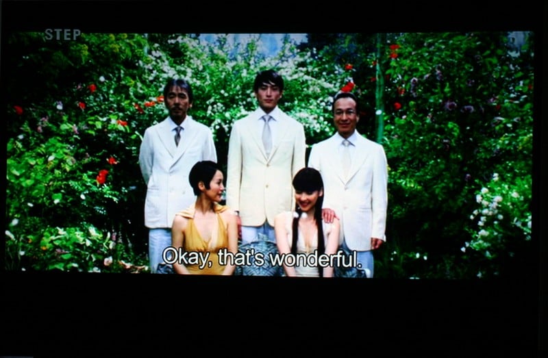

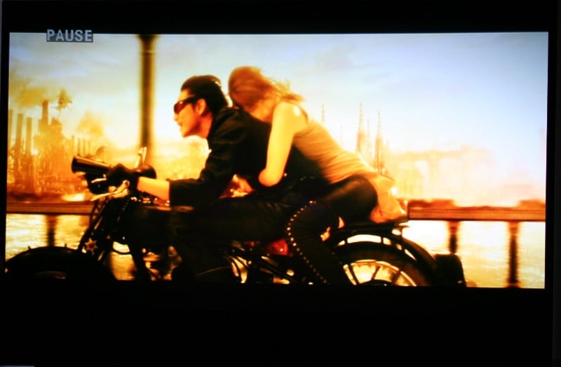

DVD: Casshern
Casshern is a live action movie based on an anime television series that was released in 1973 (we make remakes of old TV programs, I guess the Japanese are just following suit). If you're into Anime, you know the plot - Boy dies (or something), boy gets weirdo suit of armor, boy becomes an unstoppable killing machine. Throw in a few environmental themes and an underlying message that technology specifically and mankind in general is destroying each other, society, the planet, and the universe and you're set.
Casshern borrows heavily from the style of movies such as Sin City and Sky Captain and the World of Tomorrow (mostly from the latter). Everything is heavily stylized and the Anime influence in both the themes and the way the movie is shot is extremely obvious. Many of the graphics are rudimentary but it seems that it was as much a directorial choice as a budgetary one (the film was made for ~$6 million). The colors are heavily oversaturated and the HL-T5087S just looked gorgeous as it presented everything in bigger than life colors. It was surreal to watch and quite interesting visually. As with all the other viewing evaluations, the HL-5087S's one flaw of color banding did pop up from time to time.

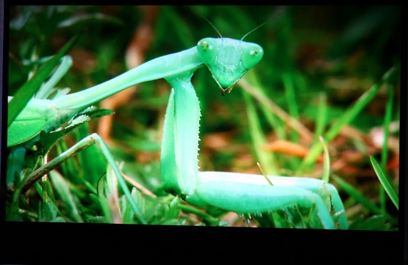

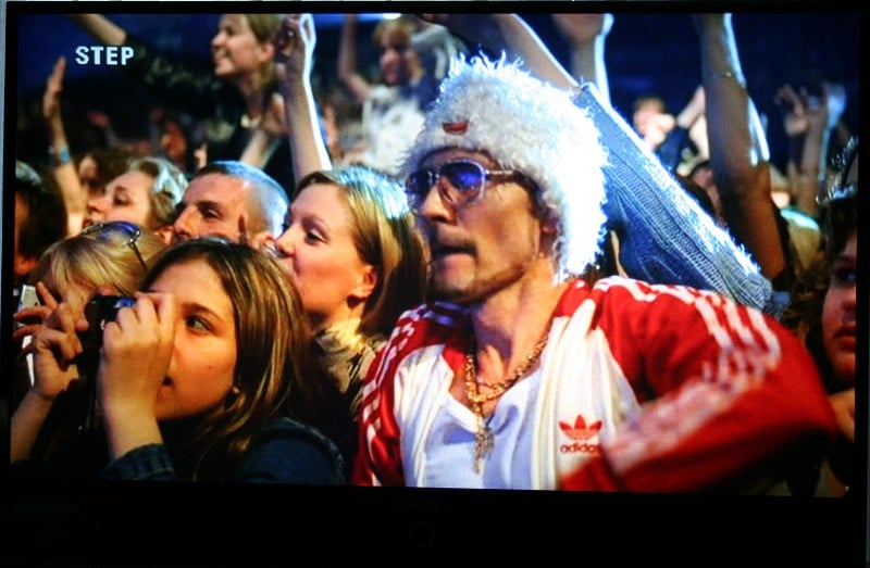

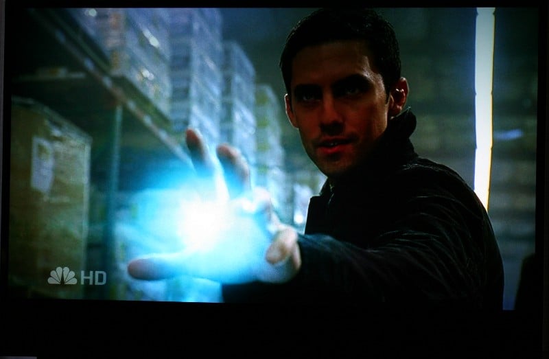

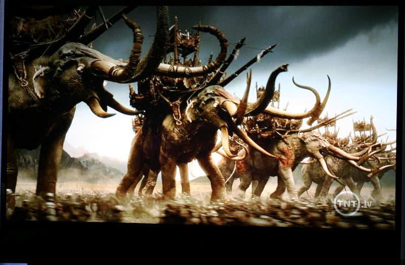

HDTV: Heroes, Alien Insect: Praying Mantis, LOTR:ROTK
You gotta love HDTV and you've also gotta laugh at those dissenters who claim they can't see a difference. You must not be looking. Heroes and Lord of the Rings: Return of the King looked stunning on the Samsung. What really caught my attention, however, was a show in Discovery HD Theater called Alien Insect: Praying Mantis. Holy COW! Those bugs looked awesome! They were so lifelike and vivid that I could feel the kids pressing close just in case the huge insect crawled off the screen. The colors were vivid and the detail was amazing. You can see so much on a screen this size in HD.

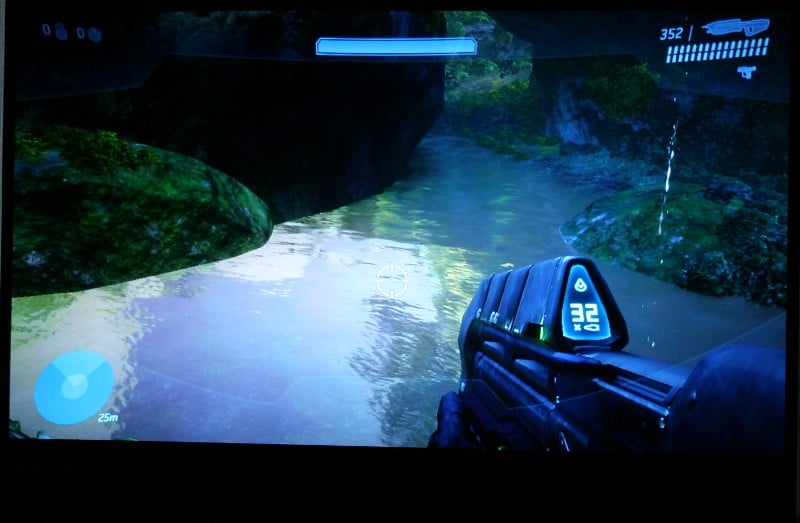

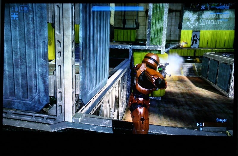

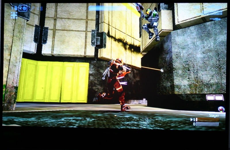

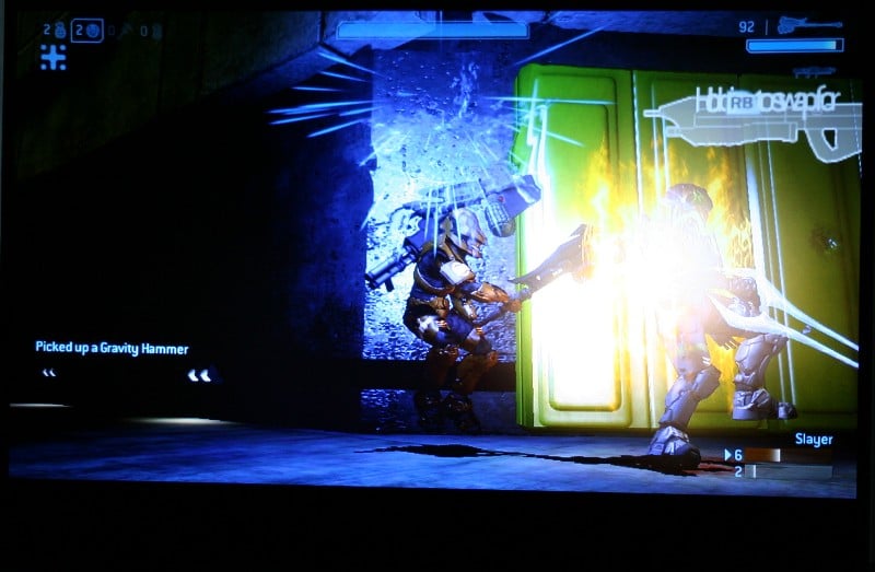

Xbox 360: Halo 3
As much as I like to complain about getting headshotted by 15 year olds, you have to love playing Halo 3 in glorious 1080p over component video with a group of friends at or about your same level. While the graphics aren't up to the level of something like Gears of War or BioShock, they really got the water right. Even during gameplay I'd notice a few instances of banding which was annoying but other than that I couldn't fault the HL-T5087S. I tried out and ended up using the Game Mode which switches you to Dynamic and optimizes the display for games. I can't say I noticed much of a difference between the graphics when using the normal Dynamic mode vs. Game mode but while others were complaining that they couldn't see because their display was too dark, my picture was as clear as a bell. Enjoy a few pics of me killing some of my fellow Audioholics.
