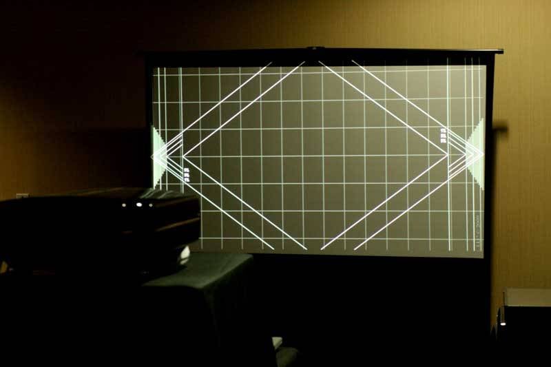

- Geometry & Convergence

- Overview of Front Projector Setup, Hands-on Training, Keystone and Other Geometry Corrections & Screen Technologies

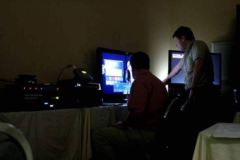

The room we were in was fairly small but it was packed to the gills with displays. There were six flat panels, one rear projection DLP, and four front projectors. There was a wide array of calibration equipment available - more if you consider that everyone was asked to bring in their own kit. While it was neat to see all the calibration equipment, it really wasn't practical to use it. In order to do so, you needed your own laptop (which we had) but also to install and configure the software. While plugging in a USB printer might be a simple (-ish task, depending on whether you're using a PC or not), calibration equipment often takes hours to install and get running correctly. OK, I may be exaggerating a little but it isn't unusual for there to be conflicts. What would have been nice is if they had provided dedicated stations with a laptop and a calibration device paired so that you could get practice not only with the device but the software that was driving it. This would also help the attendees understand the differences between all the meters and software packages so that they could make a more informed decision if they decided to purchase something new. As it was, you had to try and pair up with someone that had brought a piece of gear/software package that you were interested in or risk wasting all of your lab time trying to get something new installed on your computer.

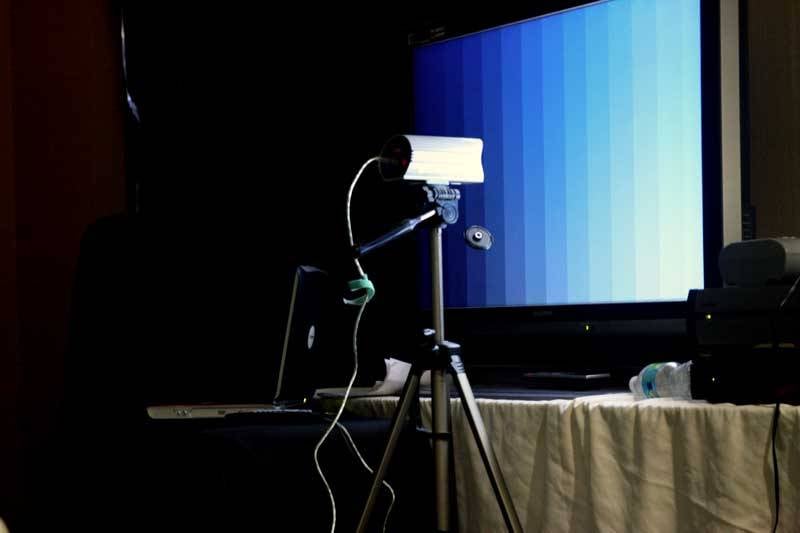

The flip side was that Derek Smith of SpectraCal was on hand with his calibration package and software. Before entering the room, I'd never heard of SpectraCal though Clint had. It's a new company that has developed a new calibration software that seems to be the most flexible and comprehensive on the market. Derek did a small presentation and was there for the entire last day of class to demo his software and answer questions. We spent a lot of time that last day looking over his software package instead of doing our calibrations.
Wasting lab time is definitely not recommended - though learning the SpectraCal software wasn't a waste for us. Part of the requirements to be THX certified is to complete 10 calibrations and to have them verified by THX. With the number of displays at the training, you're not going to want to waste time with hardware/software installations. While Clint and I pretty much handle all the display reviews for Audioholics, 10 is a lot and you only have a year to do them in. If you're not a full time (or at least part time) calibrator, that's a tall order. We thought it best to make sure we took advantage of the displays on hand. Hustling as much as we could, we were able to get 8 done though I'm sure it is possible to get all 10.

On day 2, we started
to use meters. There was a ton of hands on during this time and we were
encouraged to pair up with other people. This was a really good opportunity to
experience new gear and to ask questions. That evening, after dinner, the
instructors stayed in the room to near midnight as most of the attendees worked
on calibrations trying to get as many done as possible for the requirements. That
was a really big help. The instructors were also always available and willing
