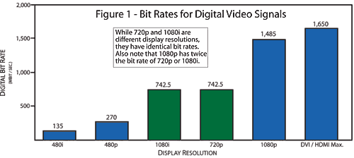

While today's HDTV standards actually embrace a multiplicity of different display standards, the most common HD resolutions are known as 720p (1280 x 720 pixels @ 60 Hz refresh) and 1080i (1920 x 1080 pixels @ 30 Hz refresh). Where the "p" denotes a progressive (a.k.a. non-interlaced) scanning system and the "i" denotes an interlaced scanning system. Without delving too deeply into video theory it is sufficient to say that a progressive scanning system is superior to an interlaced system if the resolutions of both are the same. This is because certain artifacts cause a loss of vertical resolution in interlaced scanning systems, particularly if there is vertical motion (e.g. movie credits that scroll up the screen). There is much debate between video enthusiasts as to which of these two formats is "better" -- 720p because of its inherently stable progressive scanning system or 1080i with its ostensibly higher resolution. While these two formats have fundamental differences, they have one surprising thing in common - they require the exact same amount of bandwidth. This is because both systems use a pixel clock frequency of 74.25 MHz in the analog domain. In the digital domain, DVI and HDMI signals based on these resolutions have a bit rate of 742.5 Mbit/sec. (see Figure 1).

The debate over 720p vs. 1080i continues, but one thing is clear - a system that offers the best of both would be ideal. In other words, combine the high resolution of the 1080i system with the stable progressive scanning of 720p. The result is 1080p (1920 x 1080 pixels @ 60 Hz refresh). A very important aspect of 1080p is that it requires double the bandwidth of its lesser HD siblings 720p and 1080i. The SMPTE 274M standard defines the pixel frequency for 1080p/60 as 148.5 MHz; the digital bit rate is 1.485 Gbit/sec.

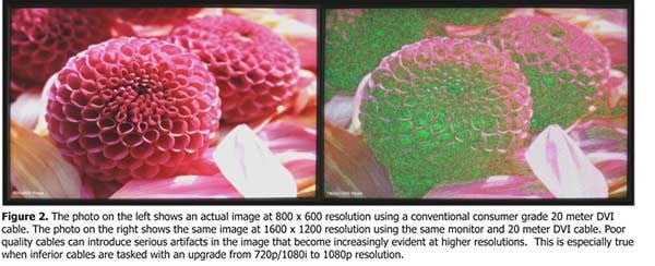

  4. I'm running DVI and/or HDMI cables inside my walls, how can I be sure they will work with 1080p sources when I upgrade my system down the road?
  5. How far away can my system components be from my display?
