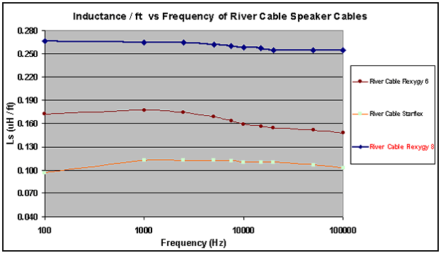

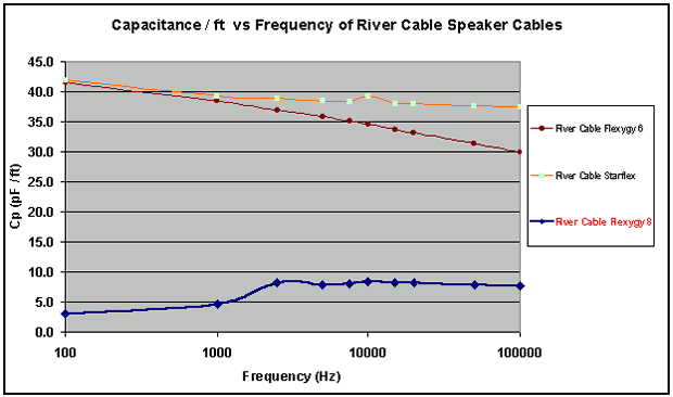

The capacitance specification is unusually low and the thought of high inductance immediately popped in my head before reading the rest of their specifications. As we learned in our article Calculating Cable Inductance in Speaker Cables and Dielectric Absorption in Cables Debunked, inductance and capacitance values are interrelated and based on the dielectric and conductor spacing between the (+) and (-) conductors.
Though the inductance is a bit higher than I’d like to see in cables, there is merit in producing ultra low capacitance and low resistance cables. These are the type of cables best suited for long runs to minimize resistive losses and amplifier stability issues of marginally stable amplifier designs. It’s particularly important to use low capacitance cables when powering ESL type speakers on tube amps. In this instance, the Flexygy seem to be the most appropriate cable design I have seen commercially produced.

Inductance was well within their spec of .300uH/ft and reasonably low enough, though not stellar, for use in high fidelity audio systems. The Starflex cable is their best performing cable in this aspect. Though according to River Cable, users requiring lower inductance cable can order the Flexygy 8 in a different terminating scheme for lower inductance but higher capacitance.
The way they are achieving this is to alternate (+) / (-) wiring on adjacent pairs in an interleaving method as opposed to 4 adjacent (+) and 4 adjacent (-) terminations. The former takes advantage of two wires being in close proximity and thus the effects of their self-inductance is nearly canceled out by their mutual inductance terms. Listed below is a table based on their published specifications comparing the metrics of the two cable topologies.

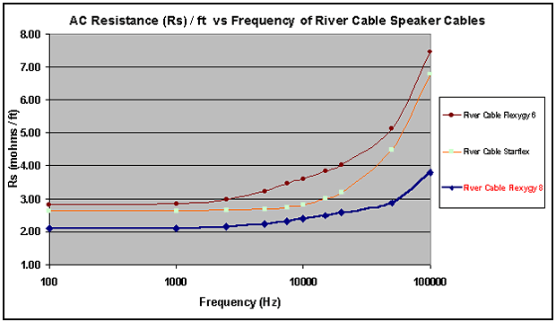

The resistance of the Flexygy 8 is about 10AWG equivalent at DC as specified by River Cable. To date, this is their lowest resistance speaker cable. We see a slight rising AC resistance with frequency (to the least degree on the Flexygy 8) attributed to skin effect, but practically speaking a non issue for the application of high fidelity audio.
For a more detailed discussion on Skin Effect, see our article on Skin Effect Relevance in Speaker Cables.
Capacitance was also on par (10pF/ft) with what River Cable specified. The reason for the slight increase in capacitance above 1kHz is attributed to measurement error of measuring a distributed device (speaker cable) with a measurement tool designed to measure lumped elements (magnetics, electrical circuits, etc). Again, if you have River Cable terminate this cable for low inductance, expect to see capacitance rise proportionally. Since capacitance is already super low, it will likely not make an significant difference. Personally, I would opt for the lower inductance termination option, especially since I don't buy into esoteric marginally stable amplifier designs.
River Cable actually touts flat cables as being the optimal geometry for minimizing capacitance. In actuality, conventional flat cables sandwich their conductors closely together which dramatically increases capacitance. I commend River Cable for producing a series of flat esoteric cables with well-controlled capacitance and reasonably low inductance. As previously mentioned, some esoteric vendors opt to sandwich the (+) and (-) conductors right on top of each other with minimal spacing. While this produces the lowest inductance possible, it comes at a penalty of ultra high capacitance, which can wreck havoc on marginally stable esoteric tube amplifiers when cables become excessively long without proper zobel compensation. High capacitance cables can also cause frequency peaking on systems resulting in a 舠 bright 舡 sonic signature. I consider speaker cables below 50pF/ft of capacitance low enough to NOT be an issue in real world applications.
