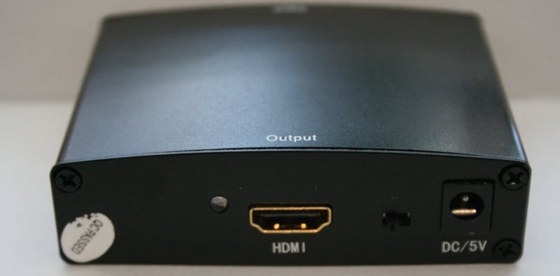

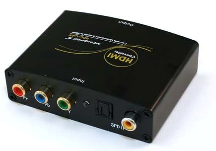

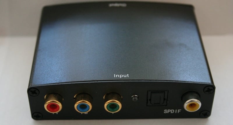

Mono_comp.JPGThe Component & S/PDIF Digital Coax/Optical Toslink Audio to HDMI Converter arrived well boxed and damage free. At only a few ounces, it would be hard to damage it in shipping without some sort of massive expenditure of energy on the delivery company's part. The box is small but sturdy with an aluminum case. On one side there are component video and a TOSLink and coaxial input and the other has an HDMI out, a port for power, and a small switch. The unit feels heavy for its size which conveys a sense of quality.
The Component & S/PDIF Digital Coax/Optical Toslink Audio to HDMI Converter uses an HDMI Profile 1.2 port which will give you all the connectivity you need in a device such as this. While that would, theoretically, allow the passage of DVD-A and SACD information, you couldn't get it into the box through the S/PDIF connection. The converter is compatible with 480i/p, 576i/p, 720p, and 1080i/p video formats, but does not scale so you'll need to make sure your device resolution is one of these formats. If it is not, you will likely not be able to get a quality picture out of it (or any picture for that matter).

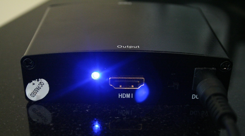

Mono_light.JPGThere is a light on the each side of the box to let you know that it is receiving power. There is also a switch near the HDMI port. With the switch to one side, the light on the HDMI side turns red, when you flip the switch, it turns blue. According to Monoprice, this is in case of an HDCP handshake problem (I didn't experience any problem regardless of the switch location). They recommend you leave the switch in the blue orientation. This of course begs the question as to why there is a red setting at all but I'll let that one slide. I'm sure there is some engineer somewhere that has a very long, very convoluted reason. From a setup standpoint, the lights on the unit are sort of bright so I was happy that I had placed the Component & S/PDIF Digital Coax/Optical Toslink Audio to HDMI Converter behind the receiver. Out in the open, you're definitely going to notice them.
