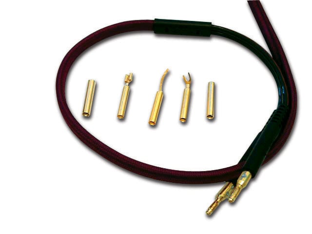

status_decimos_banana.jpg K&B Signal Solutions is a newcomer to the audio industry. A group of Mechanical Engineers set out to produce affordable and well performing cable products, snake oil free. One unique perspective they bring to the table is their very clever and practical terminations comprised in their new speaker cable known as the Concert Series . I know you have heard this before, what could possibly be unique or differentiate this company from the next cable company? It's called "Interconnection Modularity". This allows the end user to swap out cable terminations or add extenders to increase cable length without any needs for crimping or soldering. It is basically a "tool-less" design involving pressure applied by the end user to make the connections and terminations.

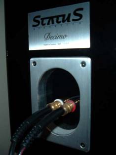

The Concert Series cable comes fitted with banana plugs which interfaced quite well with my Status Acoustics Decimo's . It has always been a challenge to say the least to find non compression style banana plugs that fit snugly on these speakers. The nice thing about this cable, is if the banana plug doesn't fully insert into the binding post, you can pull the PVC rubberized sleeving over the connector to make it fully flush.
K&B; Concert Series Design
cable.jpg The Concert Series cable is a basic 12 gauge twin feeder cable (or more popularly known as " Zip Cord "). However its cosmetics are dressed up via a slick wine color nylon sheath with a slidable strain relief PVC insulator to encase the terminated cable and ensure no metal contact area is exposed once fully pulled over the terminations. The terminations are gold plated brass alloy construction. The default base terminations are banana plugs which are soldered snugly to the cable.
Your cable termination choices are as follows:
  • Banana Plugs (default) - used for pushing into back of binding posts of most amps and speakers.
  • Splice Cable Connection - for seamlessly adding cable lengths via daisy chaining.
  • Positive and Negative Fastons - popular when interfacing with raw speaker drivers.
  • Flexible Pin Connector - similar to a gold coated wire which is easy to pass through a speaker's binding post before tightening down much like you would do with bare wire only there is no strand fraying to deal with since it is coated and self contained.
  • Spade/Fork Terminations - popularized by many esoteric audiophiles though in my opinion usually more problematic then beneficial. In this case, the furnished Spade connector was not wide enough to accommodate any of the speakers I had on hand for review. I would have preferred an offering of different sized spade connectors or one adjustable one.

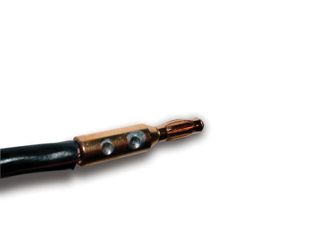

The banana terminations are soldered onto the cable firmly as indicated by a rugged pull test we conducted.

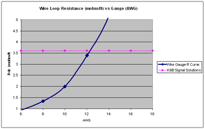

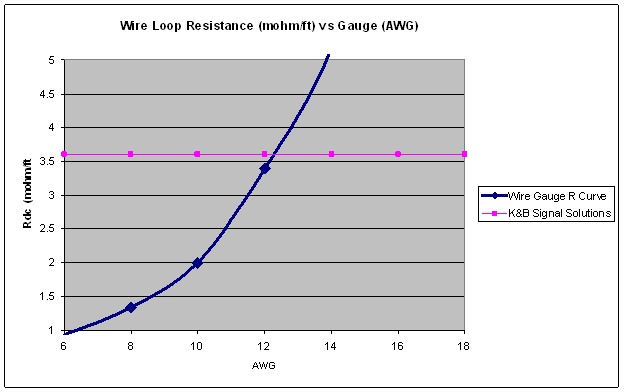

Using our Wayne Kerr 6420 Impedance Analyzer which graces our Test Equipment Laboratory , I measured all of the critical metrics which directly affect cable performance. The DC resistance of my first 12" cable length measured to be Rdc1 = 43.3 milliohms, while the second 12" cable length measured to be Rdc2 = 43.5 milliohms. If no added contact resistance is present by interfacing these two cables, then the total added cable length for the equivalent 24" cable should be Rdc1 + Rdc2 = 43.3 milliohms + 43.5 milliohms = 86.8 milliohms.

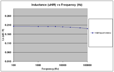

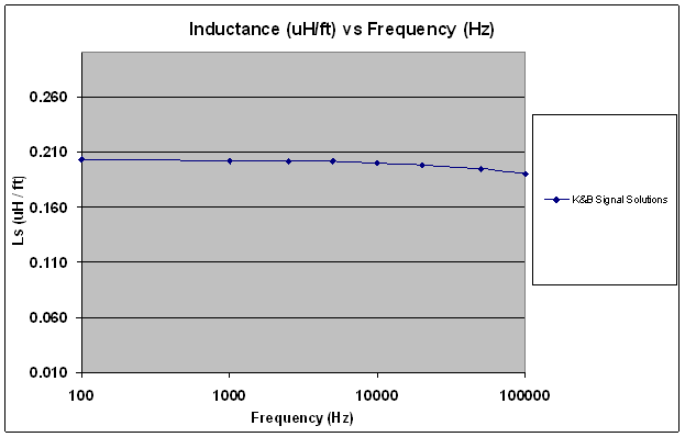

Inductance measured similarly to 12AWG Monster cables from Speaker Cable Face Off I . We see a minimization of internal inductance due to skin effect at frequencies above 20kHz. While this is measurable, it is not something that cannot be sonically detected in real world audio application nor is it cause for alarm since just about every speaker cable we measured, regardless of their price, appearance, or claim to fame for resolving skin effect exhibits similar behavior.
For a more detailed discussion on cable inductance, the reader is encouraged to review our article on Calculating Cable Inductance

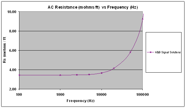

The resistance of the K & B Signal Solutions Concert Series cable is about 12AWG at DC.
We see a rising AC resistance with frequency of about 20% and 20 kHz, again attributed to skin effect, but practically speaking a non issue for the application of high fidelity audio.
For a more detailed discussion on Skin Effect, see our article on Skin Effect Relevance in Speaker Cables

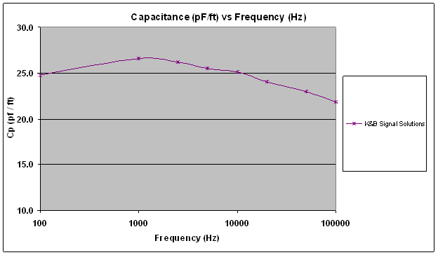

Capacitance about on par with 12AWG Monster Cable from Speaker Cable Face Off I . We see the capacitance decrease with frequency for two reasons, slight instrumentation error of measuring a distributed device (speaker cable) with a measurement tool designed to measure lumped elements (magnetics, electrical circuits, etc), and a decreasing dielectric constant with frequency. While many esoteric cable vendors and cable cult hobbyists would have you believe this is considered Dielectric Absorption and will again cause audible distress, the reality is most cables exhibit this behavior and it is not something that will cause deleterious effects on fidelity or performance of even the most demanding and revealing audio systems.
For more information on Dielectric Absorption, see our article entitled Debunking the Myth of Dielectric Absorption
