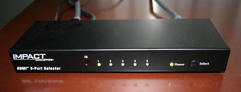

HDMI_Switch_Front.JPGThe thing about HDMI switchers is that you don't need one until you need one and by then, you REALLY need one. Some people have made the plunge and bought an HDMI receiver but there are plenty of people still on the fence. For them, they'd like to get the very best picture quality out of their HDMI capable transports and display but many displays only have one or, if you're lucky, two HDMI inputs. If you find yourself with digital cable, a Playstation 3 or one of the newer Xbox 360's, and a high def player or upconverting DVD player you're going to spend a lot of time switching cables or settling on non-digital outputs. Frankly, that's no good. Rather than deal with that, Impact Acoustics has come out with two HDMI switchers, either of which will surely fit your needs. Best of all, they are priced for the consumer and not just installers!
Impact Acoustics HDMI Selector Build Quality and Conclusion

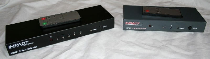

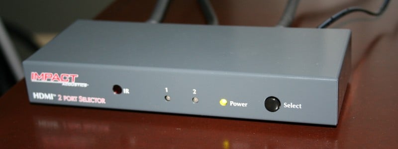

HDMI_Switch_box.JPGThe main differences between the 5-Port HDMI Selector Switch and the 2-Port (aside from the number of inputs) is the 5-Port has an IR Extender jack and discrete On/Off codes. What does this mean? The 2-Port doesn't have discrete On/Off codes so you'll probably want to leave it on all the time if you are putting it into a system and utilizing a universal remote. The 5-Port does have discrete codes for On/Off and the IR Extender input means there's no need to add an IR flasher to the front of the unit - eliminating the worry about missed commands. From an installer's perspective, this is a very desirable addition. Both units have discrete input selection via the remote. The front of both units sport a couple of LED lights that let you know a) that the power is on and b) which input is currently being routed to the output. There is a selection button on the front of each unit that cycles though the inputs.

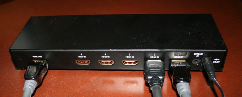

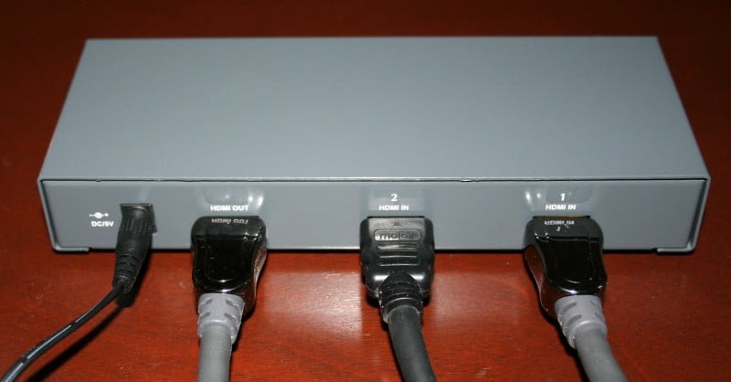

HDMI_Switch_2.JPGBoth of the units are constructed out of steel or heavy gauge aluminum and feel heavier than they look. Sturdy? Oh yeah. Little rubber feet adorn the bottom and keep it from scratching your furniture. The inputs on the back are well spaced and easy to use. The power cable has a small plug rather than one of those big square transformer types that takes up three slots on your surge protector. The IR Extender input is very close to the power input on the 5-Port Switch but you should have more than enough room to access it. The front green lights are fairly bright and powering off the unit doesn't extinguish the power light (only unplugging the unit does that). There is no dimmer option.

Setting up a switcher is nearly the easiest thing you can do. Power everything down, connect all your transports to the switcher's inputs, connect a single cable from the output to the display, plug in the power, and turn everything on. Both of the Impact Acoustics switchers are HDCP compliant so if you have an older cable box or HDMI 1.0 receiver and are having handshake issues these devices may be a solution for you.

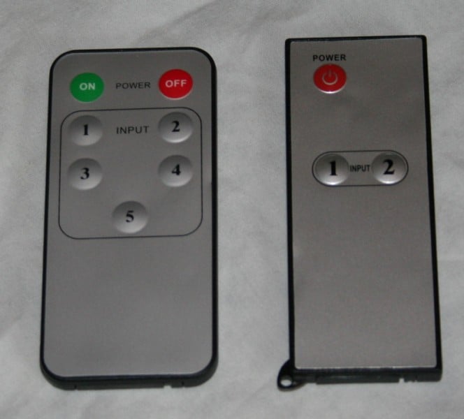

HDMI_Switch_remote.JPGThe remotes for the 2 and 5-Port HDMI Selector Switchers share a lot of the same styling cues. Lightweight to the point of ludicrous, they feel insubstantial in your hand. I've never met, seen, or hear of a couch that wouldn't swallow these remotes in a millisecond. The smaller of two remotes for the 2-Port switcher has a tiny loop on the end that could presumably be used to attach something larger and heavier to keep it from getting lost (or tying to a stray thread on the side of your couch I suppose). The remotes ship with a plastic cover over the positive battery terminal to ensure they will power up when you start to use them. Each sports a dedicated button for each input and, while the 2-Port only has a toggle power button, the 5-Port has discrete 'On' and 'Off'. I had no problem controlling either of the units from my normal seated position.
