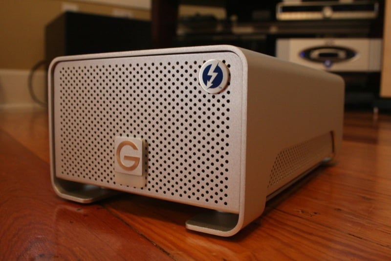

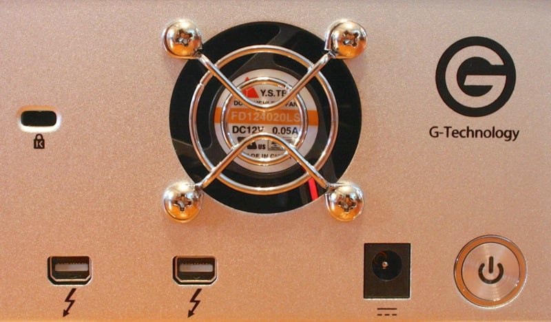

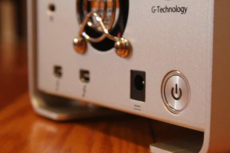

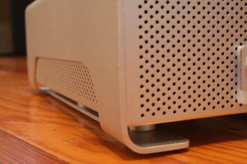

G-Raid detailThe enclosure is all-aluminum and very simple, yet attractive, and it blends into the current Apple brushed aluminum ecosystem well. It’s got a Thunderbolt badge on the front which distinguishes it from G-Tech’s other G|RAID drives. On the back is a fan that cools the unit, a power button (I miss the hard toggle switch on other models) and two (count 'em) Thunderbolt ports. If you’re looking to use this drive with a computer without thunderbolt, you’re out of luck. That’s probably the only drawback of this unit except for the fact that it doesn’t come with a thunderbolt cable. With a retail price of $999, I expected not to have to drive to my nearest Apple store just to shell out another $49 for a cable. Then I researched what goes into making a thunderbolt cable and found I understood the exclusion a little bit more seeing as they’re not your dime-a-dozen USBs. Still, for a grand, please find a cable and throw it in the box.

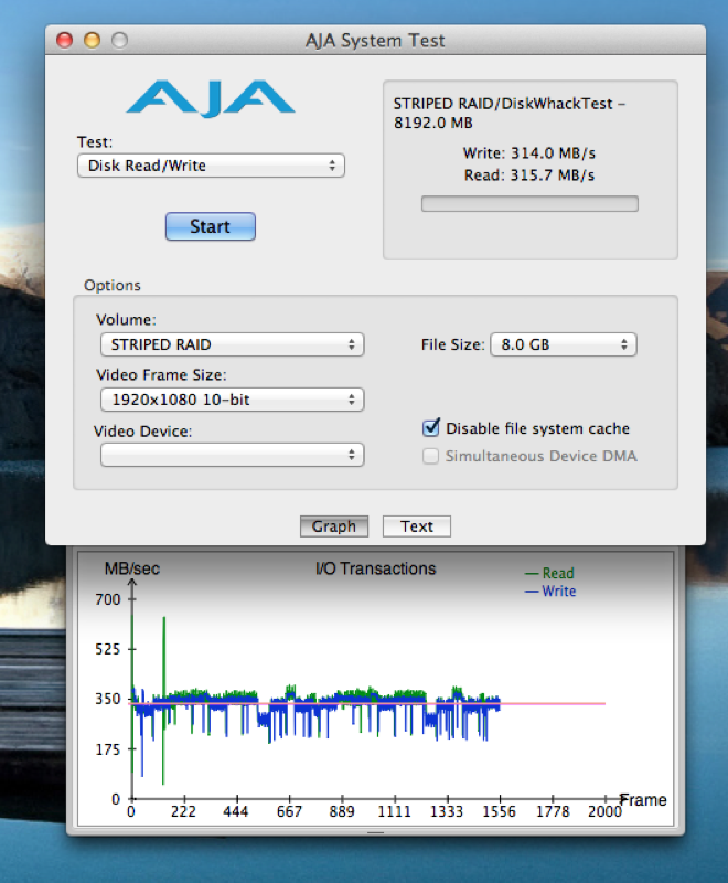

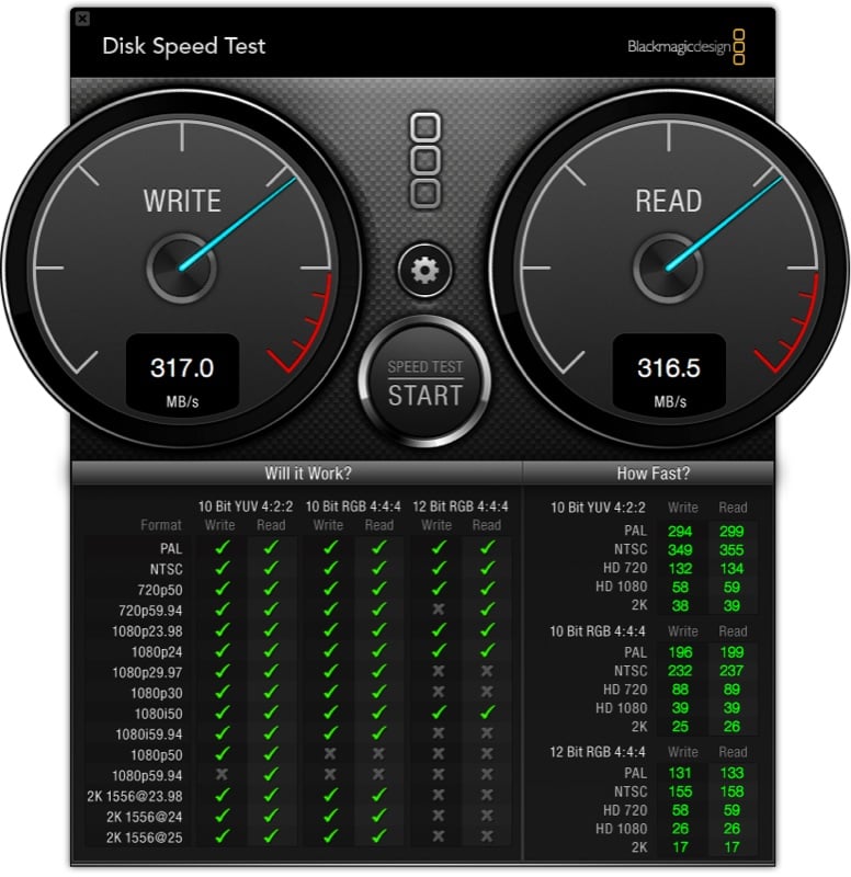

The drive comes configured as a striped RAID 0 system, although you can also configure it for RAID 1 redundancy, concatenated (JBOD just a bunch of disks that look like one), or use the two internal drives completely separately. I opted to stay with RAID 0 for my performance tests. I should also mention that I raided the drive using 256K blocks since I work with larger files. Blackmagic Design’s Disk Speed Test rendered results of 317MB/s write and 316MB/s read speed of a 5GB file. AJA's System Test rated the drive with almost exactly similar results using an 8GB file size. Meanwhile, more practical testing showed me that I could move a 1GB file to the drive while simultaneously writing the same size file back to the computer in about 10 seconds. I’m a very happy editor right now.
AJA test  black magic test2
