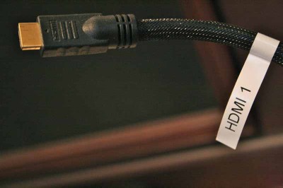

Going back inside, we applied some flag labels to several cables that we needed to run n a confined space. Without labels, these would quickly be confused and could potentially keep us from tying together an advanced A/V system correctly. The Flag labels are printed for readability on both sides and the center has a line that allows you to place it accurately. Most users will take quite some time to get used to applying a flag label correctly and accurately, but once you have the knack you're good to go.
